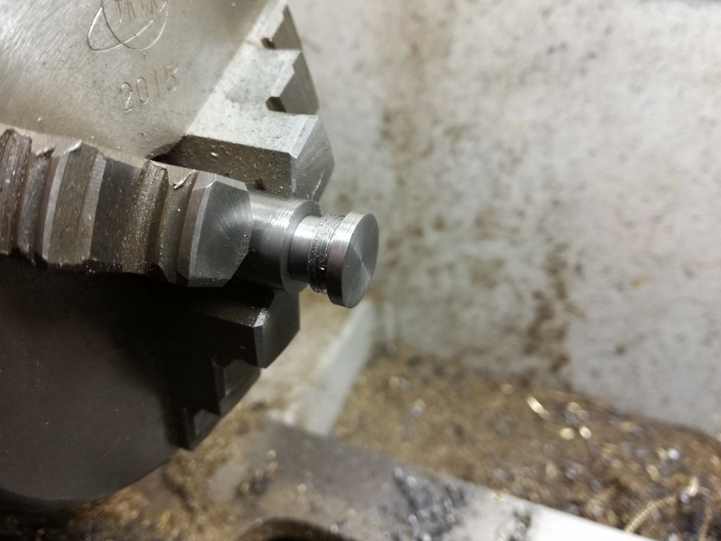

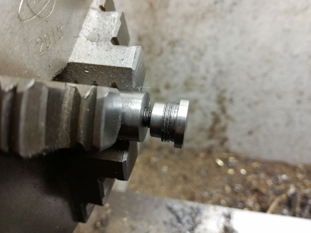

                  Hi, today, (Saturday) I made a second screw for my son-in- law's shot gun. These are for latching the barrel to the main part on the gun. One came loose and fell out without him knowing. Spares are not available apparently, but he did get a quote for new ones to be made, but at £300.00 plus each, he told them he would scrap the gun first. So I was asked if I could make him a couple. I said I'd give it a try and what a try is was. total length is 8.7mm, biggest diameter is just shy of 12mm by 2mm thick, small end is 8.5mm x 3mm long and the threaded portion is 9.8 x 0.75mm pitch. A bit of a ticklish job by all accounts. I must admit that I messed up on the first attempt on the first one I made and also the first attempt on this second one. The original ones were also slightly domed on the outside, but flat ones are acceptable, they also have a 4mm hex socket on the inside for fitting them, these one's have part of a 2BA hex grub screw Loctite'd on the inside for fitting. The 2BA screws were first used to hold them onto a piece of the bar while facing the outside.
                  Above photos showing how the screws were attached to a internal threaded bar, for facing the outside. The new ones are made out of EN8, which is OK apparently.
                  Regards Nick.
                  Edited By Nicholas Farr on 15/10/2017 01:08:30

                      Posted by Nicholas Farr on 15/10/2017 00:59:22:
                      Regards Nick.
                      Nick
                      So presumably these are the stub pins by which the barrel lump swivels on, and attaches to, the receiver?
                      Out of curiosity, what make of gun is it, since these only widely came into use in recent years on over and under shotguns such as Beretta (for which spare stub pins are readily available).
                      I'm guessing a defunct Spanish or Italian gun.
                      I hope whoever said EN8 is OK is correct, since the stub pins stop the barrels blowing off the receiver, under repeated firing pressures of up to around 11,000 psi every time a cartridge is fired.
                      Edited By David Standing 1 on 15/10/2017 23:00:05

                      Nicholas Farr
                        @nicholasfarr14254
                        Hi David, yes they are the stub pins, can't remember the make, but made in Turkey. The pins are shouldered by the main gun body, opposite the barrel swivels.
                        Regards Nick.

                        David Standing 1
                          @davidstanding1
                          Hi Nick
                          Ah, if Turkish, probably Huglu, Yildiz or Armsan/Hatsan then.
                          I'm surprised he was told spares are not available, as these are all shotguns only recently imported to the UK, and all still currently have a UK importer.

                          David Standing 1
                            @davidstanding1
                            And I am afraid I am going to have to be a real party pooper on the stub pins.
                            Since they are copy parts not supplied by the manufacturer, and they are pressure bearing parts, I have a suspicion that the replacement stub pins will render the gun out of proof, under the Gun Barrel Proof Acts 1868, 1950a, and 1978.
                            I have seen the results of guns that let go under firing, and the results are not pretty, often resulting in the loss of fingers or eyesight.
                            I am not trying to be a smart Alec, but I would strongly recommend that your son in law only obtains parts from the original manufacturer, or only has shotgun pressure bearing parts manufactured by a reputable gunsmith.
                            I have three shotguns with similar stub pins, and the facilities to make copies should I ever need them, but I would not do it.

                            Mike
                              @mike89748
                              Like David, I believe the gun will have been rendered out of proof. This does not mean it cannot be used by its owner, but it would be illegal to attempt to sell it. I am also surprised that factory spares are not available.
