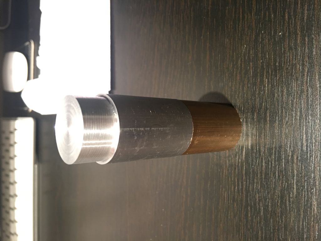

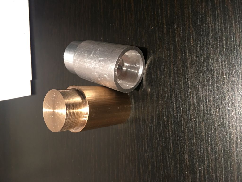

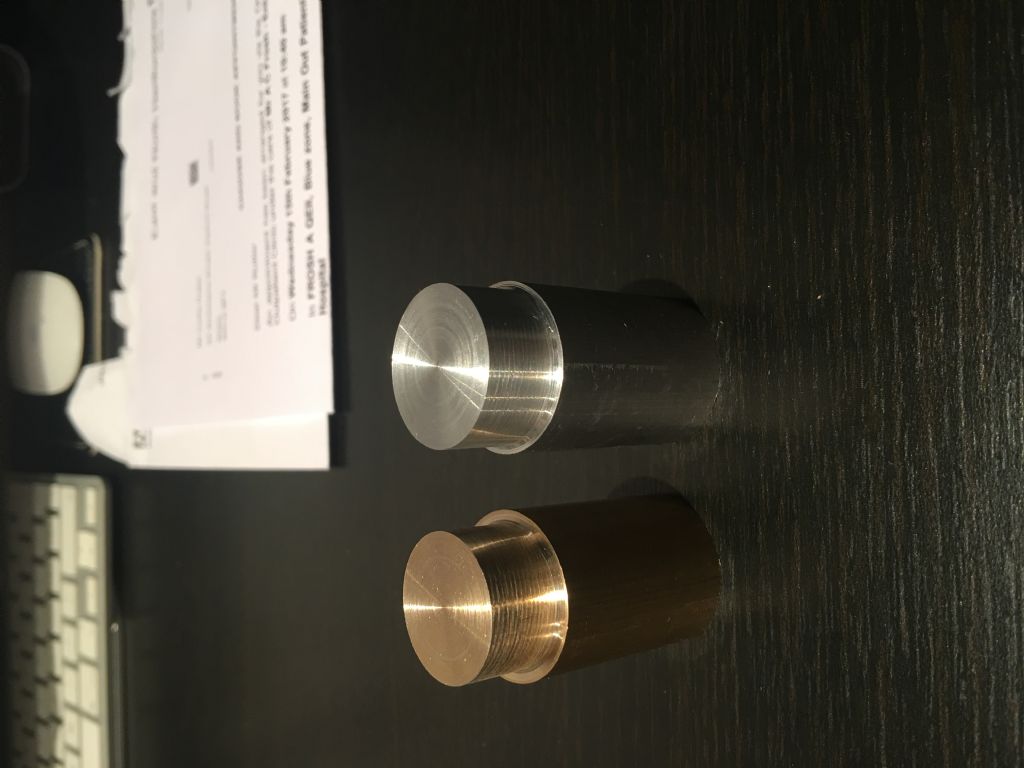

                                                  Just done these…..not much but I'm pleased with them, first time boring and trying to do anything accurate instead of just making swarf ….p.s how do you rotate photos??
                                                    Good practice, but I thought that was what we were meant to do
