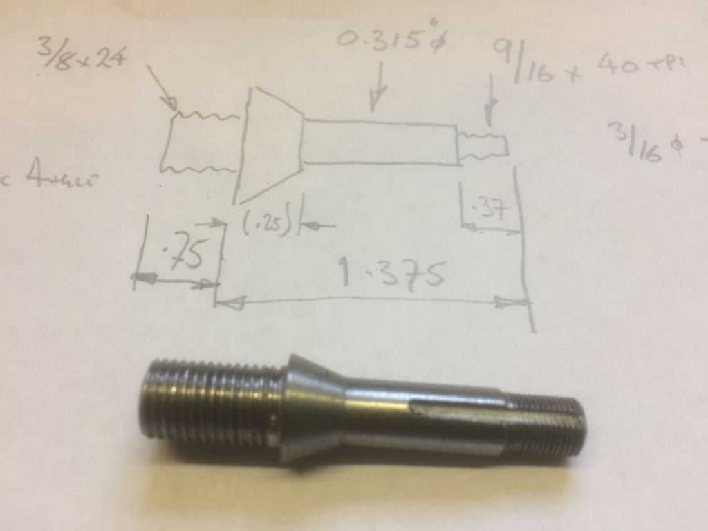

      Made an 8mm collet / chuck adaptor for my watchmakers lathe. Now looking for a chuck to fit – see WANTED section please.

            Gross apologies – I tried to correct things without going out on a cold wet night BUT, the drawbar thread is 7mm by 40tpi. (not 9/16 x 40 as shown on sketch) Please ignore the previous couple of attempts to put things right.
            I guess its the problem of making things to fit as opposed to making things to drawing !!
            As an aside, I looked on the Lathes site, but did not find 'my collets' there. The lathe in question doesn't have a makers name or serial number etc, just a number on all 'matched' parts.

                      JA, Regarding the 8mm lathe collets.
                      Metric OD, probably thread form BS Brass. I cut a lot of my threads using either some old hand held chasers (held in the toolpost) or chasers from Tracy Tools. Sometimes we MEs get a bit hung up on exact dimensions and fits. Sure, when we are talking safety critical items we need to pay attention. The Tracy chasers are inserts from Coventry style die heads and can be bought in sets with a holder or odd ones.

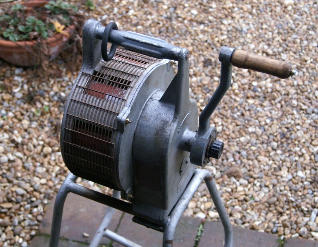

                        Odd one this week; a ww2 air raid siren. Had to replace missing gear teeth and generally fettle it. Interesting one way gearless ratchet on the crank handle. Testing it gave the neighbours something to worry about

                          Be aware that some of the Watchmaker collets have buttress threads.
                          Do you have any photos of the lathe and/or the collets ?

                            Michael G, photos in my album Watch Lathe

                              I always thought that the diameter of the thread on watch lathe 8mm collets was 0.268 ". On rare occasions 0.700"
                              From The Watchmakers Lathe by Donald De Carle

                                                Edit: That's a pretty distinctive headstock … I suspect it may be the Polish one, as illustrated here:
                                                http://www.small-lathes.co.uk/8mm-Watchmaker%60s-Lathe-%5BTDA8%5D/734.htm
                                                … I would check your collet dimensions very carefully …
