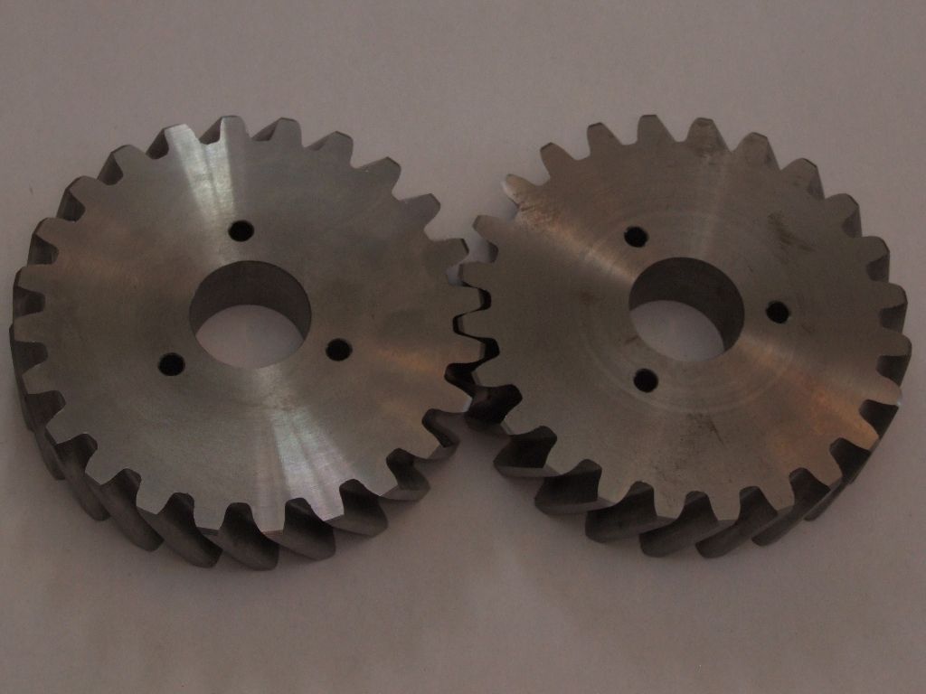

                On a more practical note I took this afternoon off from working on the electronics for non-dispersive infrared sources and detectors and made the mating helical gear to my previous effort. For the gears to mate on parallel shafts the second gear needs to be lefthand rather than righthand. This involves swivelling the mill table in the opposite direction, and adding an idler gear to the gear train so that the dividing head rotates in the opposite direction. The idler gear can be clearly seen in the picture:
                The setup was a right (or should that be left) faff. In order to maintain clearances I had to move the dividing head one set of T-slots over, move the cutter towards the overarm support and use my home made riser blocks so the division plate didn't clash with the table. Even then it was tricky to access the division plate to index the gear. It was made easier by having made the stop for the plunger on the division plate, so that I could lock it in the out position. That meant I was much less likely to accidentally move the indexing arms. All went well and the second gear appeared, on the left naturally:
                They seem to mesh smoothly, and the centre to centre distance is as it should be, at least as measured with a rule.
                Tomorrow the plan is to do some 3D printing of internal gears and pinions, and have a play with the gearing on the dividing head to explore low leads. Sunday will be admin, and then I'm afternoon tug pilot.

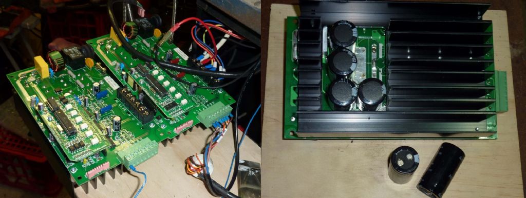

                      My Seig SX3 mill has recently been having problems and the push-buttons would fail to work although the motor would continue to run at whatever speed it was previously set to. The only way to turn it off was to hit the emergency stop putton. Re-set stop button and everything would work as normal for a while.
                      I cleaned the electrical connections with CRC contact cleaner and all seemed good. Meanwhile Ausee Machine Tools had a sale on all products and I purchased a spare controller board as a spare. Today the problem returned and I replaced the old controller board, swapping one wire at a time from old to new board to keep track of where they go. With fingers crossed, turned it on and everything works.
                      When I removed the board from its mounting, 2 large electrolytic capacitor fell out and not being an electronics expert suspect that these were the cause of the problem. The wires had snapped at the base of the capacitors. I am surprised that the motor would still run with broken capacitor connections.
                      Paul.

                        Andrew ,regards helical cutting on the A/S 2E,your photo shows your Elliott dividing head with the index plate facing towards the machine, not wishing to offend but I think your set up is wrong,your Elliot head should be set up on the right hand side of the table with the division plate facing you then its a lot easier to carry out indexing. Some manufacturers notably Cincinatti and Parkinson placed their dividing heads to the right hand side of the table. and looking at your Elliott head they must have done the same,though the Victoria machines which were aquired byElliott placed theirs to the left and the later heads were badged Elliott Victoria,your head is badged just as Elliott,so why they made a RH head I do not know.I learnt my milling on a 1950s Victoria universal,one regular job was a 10 tpi acme screw thread milled with a form cutter mounted in the rack cutting head, to get over the lack of a short lead attachment a pulley was mounted on the spindle which held the index plate and driven by v belt from a geared slow speed motor mounted on the left hand side of the table. Now there is mention that your adcock and Shipley 2E mill having different connections for the windings on the 2 speed main motor, I have the same mill powered via a rotary 3 phase converter and can only get the slow speed to work ,could it be that one of the two connections does not suit my converter which is 25 years old and was from the cheap end of the market at the time. Todays work well thats a magneto gear for a Ruston Hornsby engine and then a 63 T gear for a Harrison.

                          Paul, my SX3 had to have the board replaced and also the touch panel which had broken up at the button positions. Now it won't reverse, and the handle-activated tapping function has not worked for years. I need a new main board, and as wiring it through to the head is a lot of work, I was quoted roughly $A1000. I basically really like the machine but it is hardly very reliable electronically.

                            Nigel: I've been waiting for somebody to tell me I've got the dividing head the wrong way round. smile Indeed it is, but that's the best I can do with the kit I've got. The dividing head manual shows both left and right hand heads, so presumably Elliott made both. Of course for conventional dividing I can put the dividing head on the right hand end of the table. But for spiral milling the pick off for the gears is on the left hand end of the table, like it or not. So I have to put up with it.
                            As far as I'm aware the 2E has a Dahlander motor which uses pole switching to achieve the two speed ranges. It also changes from star in high range to delta in low range, to minimise the loss of power due to halving the angular velocity, by rearranging the order of coils within the motor.
                            I'm not sure why there are two high/low switches on the machine. I assume that the electrical looking switch on the right, under the speed changing dials, is the main control for the spindle motor. But It's not clear what the tortoise/hare switch on the electrical panel does. When changing speed ranges I've always changed both.

                              I'd say your dividing head is a less common one from all the ones I see on ebay. The K&T manual makes a feature of theirs being designed for right hand mounting for right hand use. But as most operators want a right hand handwheel the left hand one is often left off for driving the head in spiral mode so the head is made to fit on the left. So K&T put an extra shaft geared 1:1 on the right of some mill tables to drive their 'non standard' head.
                                Trust me to have the odd one; probably why it was cheap. smile
