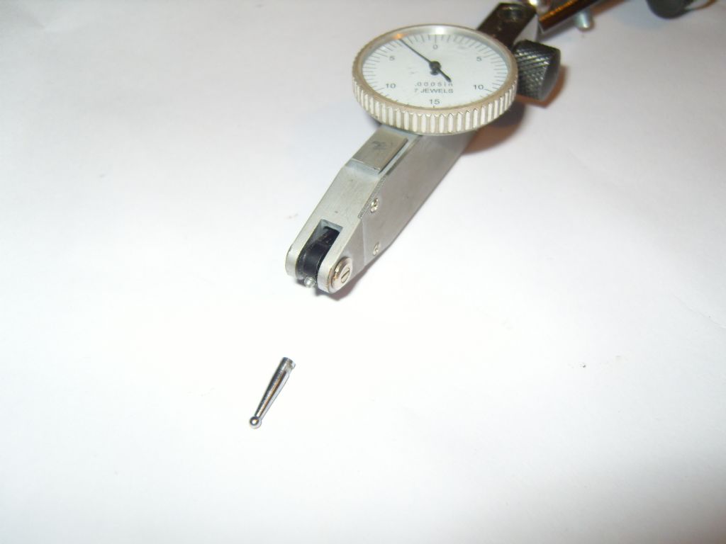

                      Posted by Nicholas Farr on 06/09/2014 22:44:39:
                      The word Wally springs to mind.
                      What on earth did you manage to do to cause that? Enquiring minds want to know. DTI's ain't cheap.
                      * Danny M *

                        Hi Danny M, had my back to the lathe while moving some wood and caught it with my elbow and knocked it onto the floor. Serves me right, I should have put it away when I'd finished with it the other day.
                        Regards Nick.

                          Who says DTI's aren't cheap I got one for £11.79 including postage, made by that well known firm Mitutogo. I do have an expensive copy though, it's made by some Japanese company of a similar name. smile p
                          Regards.
                          David.

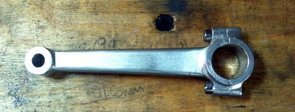

                                    I made a Con rod for a Lister

                                        Good Day HobbyNut,
                                        The Lister con rod looks good as does the rest of the engine. Keep up the good work.
                                        George.

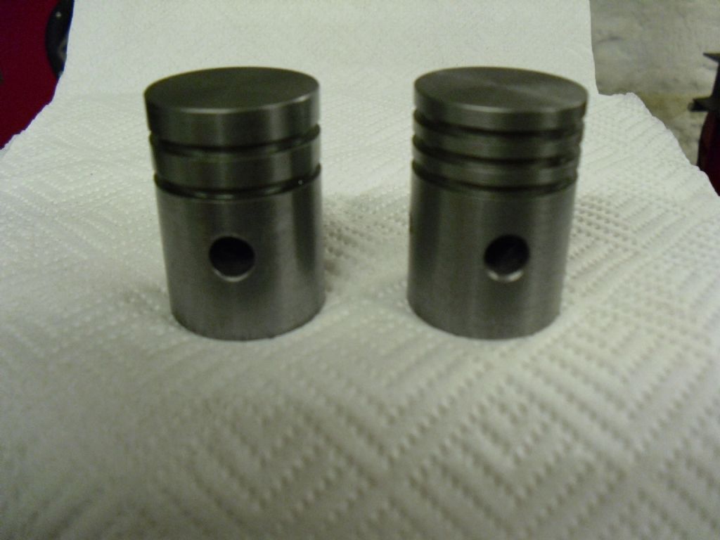

                                              sdc10236.jpgA busy day today. I managed to find a bit of spare time in the workshop so I finished off these two pistons for the Red Wing engine.
                                              The one with two piston ring grooves is the earlier type shown on my drawings from LA Servicessdc10274.jpg. The piston with three grooves is the type from the later revised drawings. This later type has two piston rings and one rubber O ring to help retain oil in the cylinder.

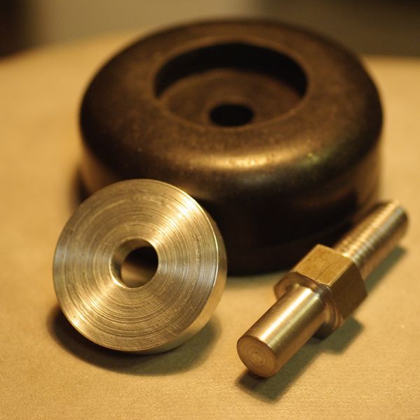

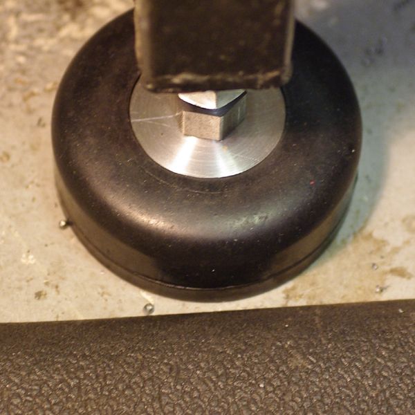

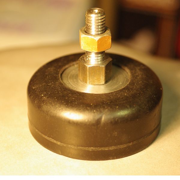

                                                A few days ago I was visiting a large DIY shop in a nearby city. I happened to spot these hard rubber rollers among the boat trailer accessories @ $4.95 CAD each X 4. I reckoned they would, with some minor work, make suitable pads for the bench that I made for my Speed 10. I had originally used ice hockey pucks but found that if I took a sudden lurch with the blind staggers and bumped into the bench, the pucks would move slightly on the smooth concrete floor. When I constructed the bench, I welded 1/2"X13TPI nuts to the bottom of each leg. to allow for adjustment so no additional work required there. Small boat trailer rollers come with a 1/2" bore.
                                                As-purchased roller. Note they allow for a 1/2" bolt and washer to be installed in a recessed manner when building a boat trailer. I turned four 1 3/4"x1/2"X3/8" aluminum bushes to fit the recesses so as to better distribute the weight. 3/4"X2 3/4" mild hex was turned to 1/2"X1" on one end which kept the bottom 1/4" from the base of the rubber to allow for unknown compression. 1/2" was left intact for a spanner and the remaining 1 1/4" was turned and threaded 1/2"X13TPI, sufficient for adjustment on the relatively level floor while allowing for the addition of a lock nut..
                                                The completed assembly ready to thread into the bottom of the bench leg. The lock nut has been added to secure the adjustment once the bench has been leveled.
                                                The pad installed. Initial compression of the rubber appears to be in the range of 1/32" at the tailstock end and slightly more at the headstock end. The rubber really grabs the concrete floor. The pad would not budge when I gave it a substantial push. Free ally and hex so total cost about $25 CAD. It will be interesting to see how the pads react to compressive forces over time. Me likes 'em.
                                                Bill
