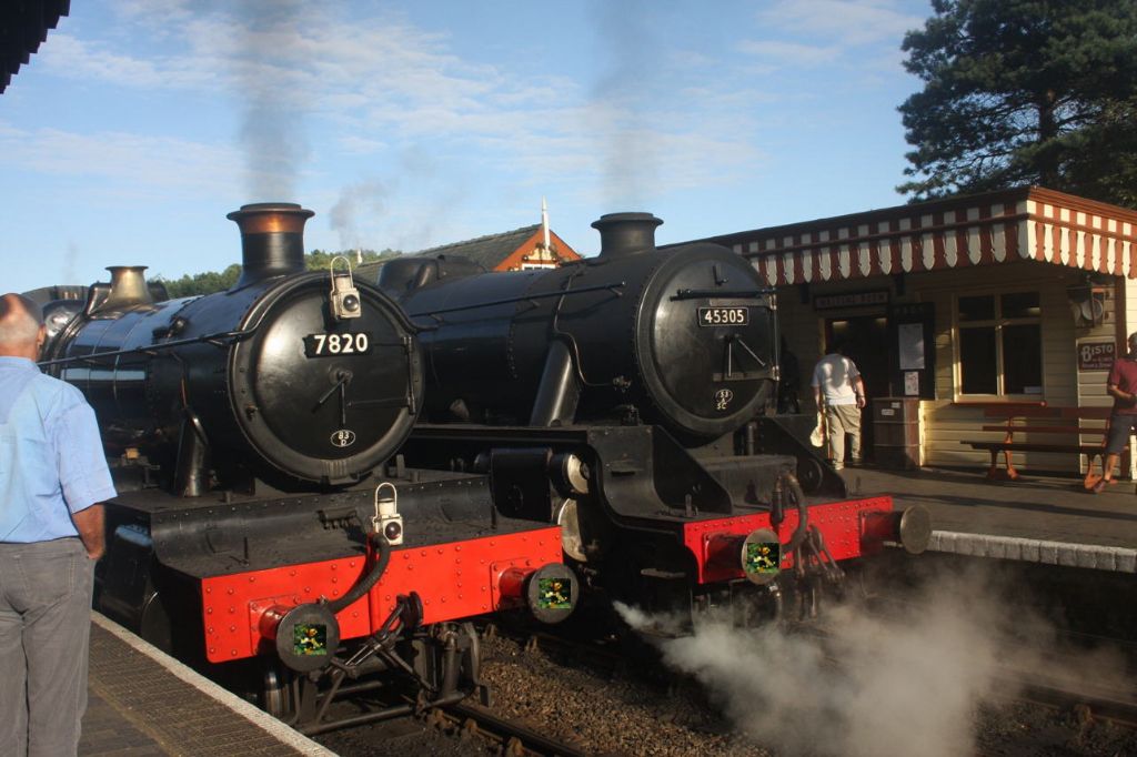

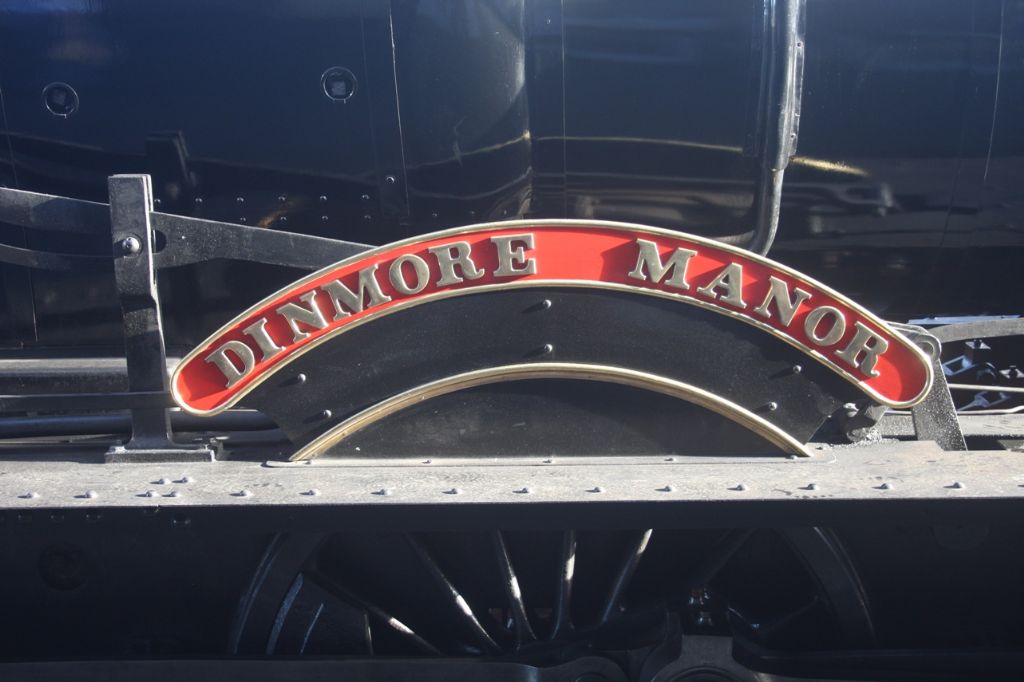

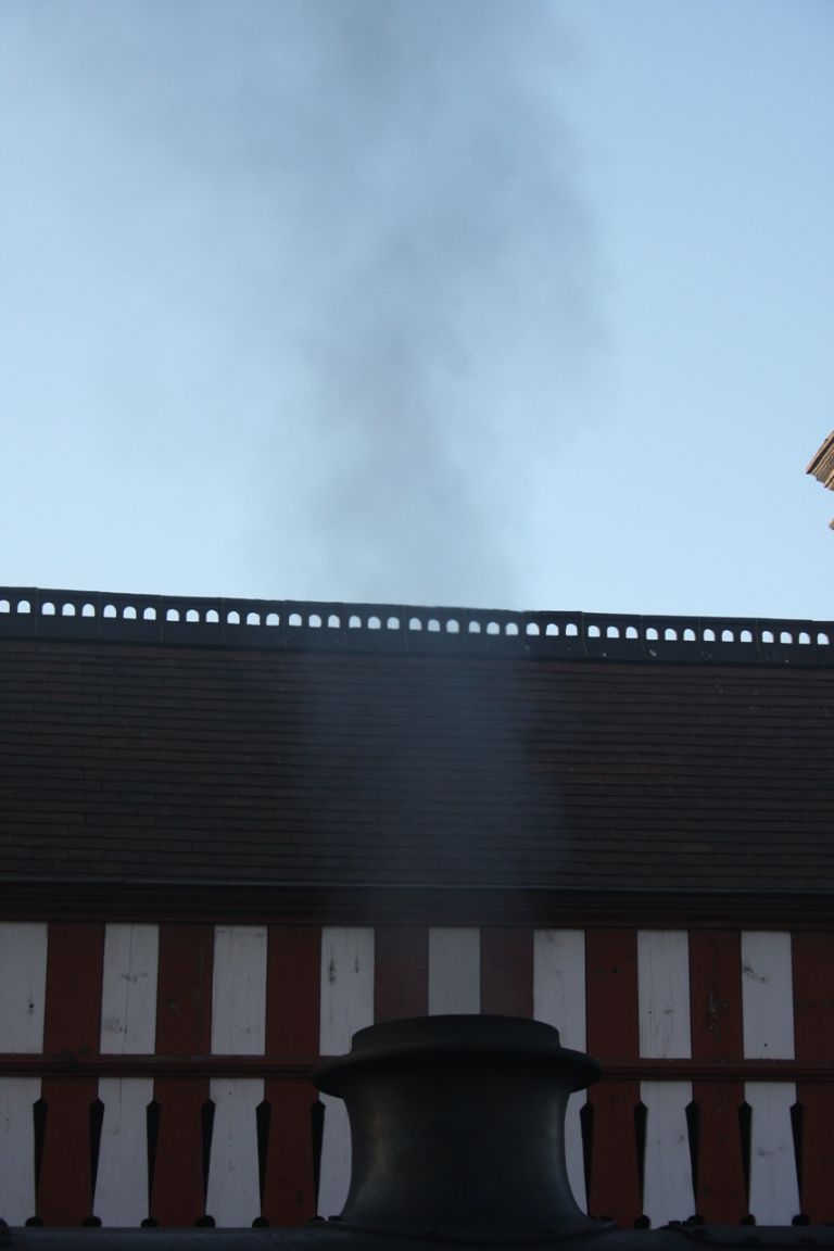

          Hi, this afternoon I went and saw a bit of engineering that JS really loves. Heres a clue in this picture below.
          This next one should give you a good idea.
          Yes it's a Steam Gala and it was at the North Norfolk Railway,
          A few more picture can be seen at this **LINK**
          Regards Nick.

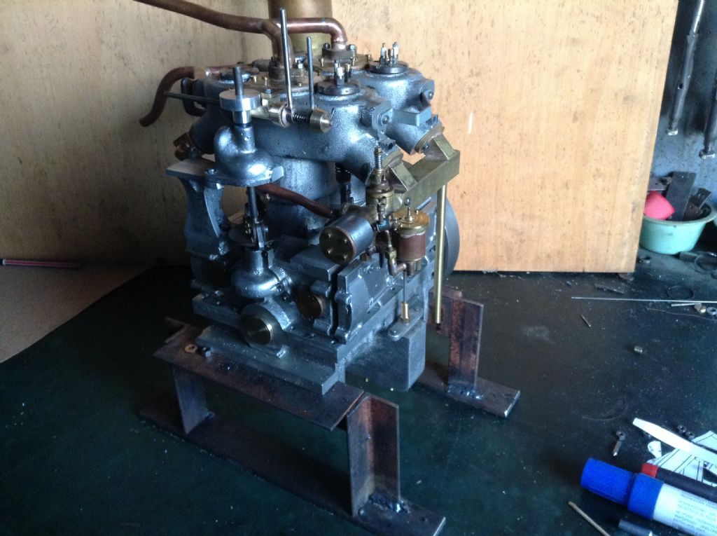

                                                    image.jpgToday I have been working on the drive to the magneto and distributor of the Saunderson & Mills tractor. This area also contains the governor and all the controls – still some work to do as they all have to line up and work. The two levers are for the advance / retard and governor and are linked with friction clutches with spring pressure. The photo looks as though the engine has been painted with a hammer finish paint. This is the effect of taking a photo quite late in the afternoon light! It looks as though the project is near the end but it will take quite some time to detail all the parts, have the engine running and then paint the model. I hope to complete the tractor by Christmas.
                                                    George.

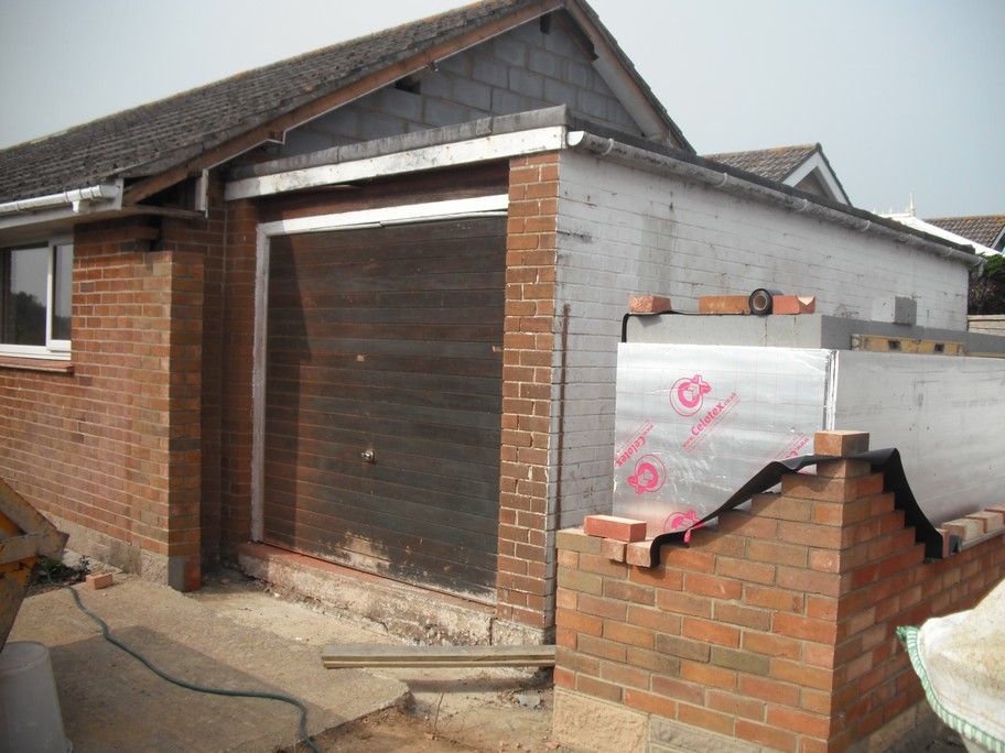

                                                      Not quite today more like this week, progress on workshop/garage
                                                      Made some progress on the walls, first lift inner leaf with insulation attached and made a start on the brick work.
                                                      Bob
