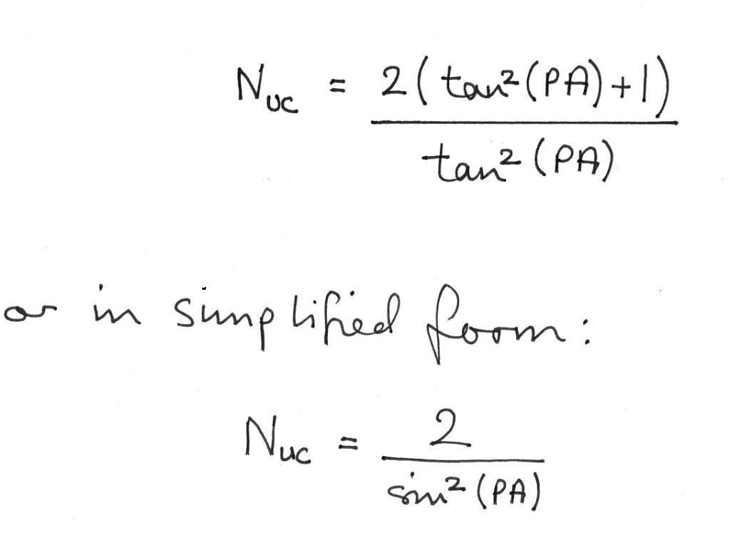

        Jim: Thanks for the elucidation on the method. I'd agree that 25 facets on an 11DP gear would be pretty much invisible. I had a trawl through my gear design books and found the following equation for the minimum number of teeth before undercutting occurs when using a straight sided hob, it depends only upon the pressure angle. The second equation was found elsewhere, but is mathematically identical, albeit in a more elegant form:
        Regards,
        Andrew

          Whether or not you use Solidworks (or even use any form of CAD at all), here's an interesting video showing how to construct a gear model. Using parameters, the module size and number of teeth can be dialled in and the rest adjusts appropriately. This approach could be applied to DP (imperial) gears with minor changes.
          It takes a little time to build up the model but about 10 mins in, the tooth construction is apparent.
          Murray

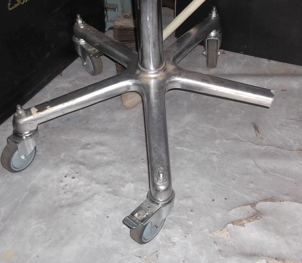

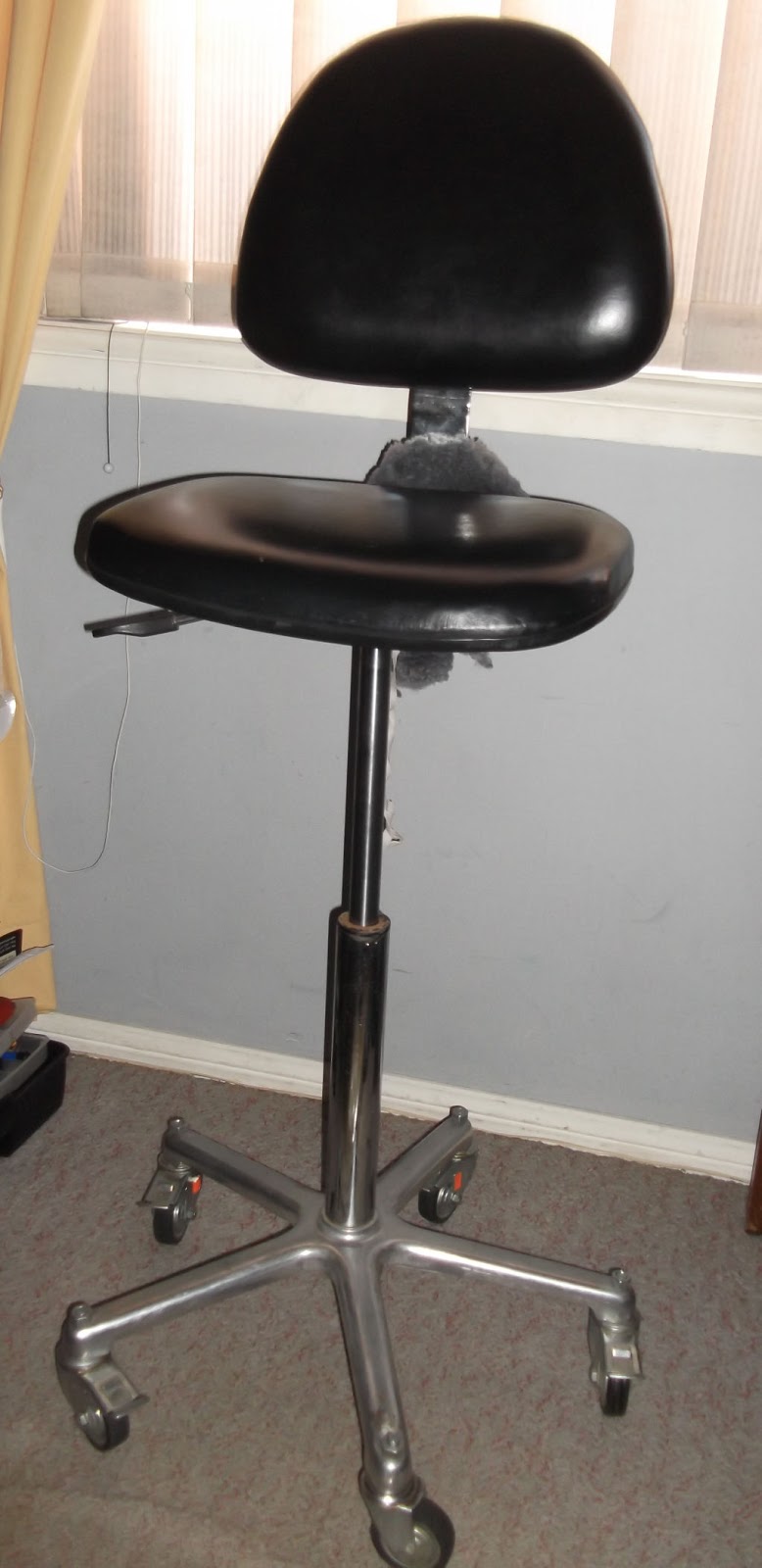

            I went for a spill off my workshop stool.
            One of the ally feet broke and I found another cracked latter on when checking.
            Its just 2 weeks since I put new wheels on and when doing so didn't notice any signs of cracks.
            I was sitting at full height as its a draughtmans stool and toppled over backwards sort of, some injury nothing major a twisted knee and ankle and hurt pride.
            I have a spare stool so can head back out tomorrow.

              Raymond,
              Please forgive me if this sounds critical; but I suspect that your improvements may have been a contributing factor.
              … Those fixings for the castors look non-standard for a stool, and may have created some "stress-raisers" [ in the mechanical, rather than the emotional sense ]

                Irrespective, don't you just feel like a Balloon when something like this happens!
                I really need to get myself something along the same lines but without the wonky foot
                graham.

                  The chair I'm sitting on now has similar geometry, it doesn't seem to have an excess of metal, probably about 3 mm thick, with some webs across the inverted U shape. The castors are pushed into holes in the die casting, and drilling these through would indeed weaken the structure. On closer inspection my chair will not fail through metal fatigue, it's made of plastic!       Ian S C

                    Posted by Michael Gilligan on 28/08/2014 07:51:35:
                    Raymond,
                    Michael I've been using the draughtsman stool now for some 7 yrs it has not had an easy life goodness knows how old it was before I got it 2nd hand. I know of many who had suffered similar fates and worse during the years draughtsman used them. The place I buy my castors from have done the same with their plastic office chairs much lower of course.
                    The stresses I put the chair under moving about the workshop with the alloy as thin as it is although well webbed structure it has been a good chair.
                    Glad i have a spare the same.

                        Ian it didn't snap/crack at the hole but about 10mm away. I won't say the castors didn't add to it but after 7yrs use by me in a harsh environment.
                        The plastic base ones well like the wheels they don't last long and I have seen them snap the whole arm off anywhere from the castor area right to the centre join. That use has been in offices by lighter persons than myself.
                        I have had thoughts of making a tube frame and new centre of steel as this is a long term situation for me.
