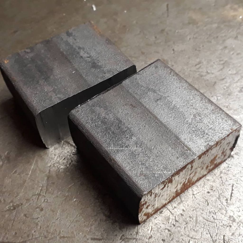

      Getting more confident using my first mill, a Chester 626 and experimenting with heavier cuts now the novelty of it all is being overtaken by a desire to get the job done in reasonable time. I'm wondering what people would recommend for shifting metal fast on a small mill? For instance I've just been making big square nuts for an old plough and needed to take approx 8mm off the edge of some 25x50mm hot rolled steel bar. I found I could take a 1 mm cut with the big (60mm diameter maybe) brazed carbide tipped shell mill that came with the machine but once that is blunt I'm thinking to invest in something with replaceable inserts but would appreciate any advice on how big to go, how many inserts and what type will give the best performance?
      Thanks, William.

            50mm shell mills with APMT 16 inserts are easy to get hold of and will cut to a shoulder. 50 and 63mm 45 degree shell mills which take SEKT 12 inserts are good for facing and are easier cutting.

              Machine spec states 63mm max face cutter so you need to look for an MT3 arbor to fit the face cutter to, unless you can get an integral unit.
              With a 2HP motor you should be able to remove material in a timely manner but remember the more metal you are removing the greater the force is applied to the vice or other material to table securing method.
              You may also need to lock all slides not being used to prevent vibration causing a poor finish.

                      To take big cuts you need a big mill with plenty of power and rigidity. Here's my experience. Last year I bought 50mm, 63mm and 80mm insert milling cutters from Arc. Overall I'm impressed with them. On the Bridgeport I only use the 50mm cutter. The Bridgeport doesn't have the power or rigidity to utilise the bigger cutters; if overloaded it tends to lose tram. I have recently been trimming up a lot of hot rolled steel on the Brdigeport. With the 50mm cutter parameters were as follows – 800rpm, width of cut 25mm, 1mm maximum DOC and 350mm/min feed rate. The mill seemed happy with little cutting noise and the chips coming off blue. Note that the Bridgeport has a mechanical varispeed head so even at 800rpm I get full motor power. If that isn't the case the OP might be better running a 10mm 3-flute carbide endmill at around 2500rpm, the full 8mm DOC, 1-2mm WOC and 500mm/min.
                      The Bridgeport cannot fully utilise the insert cutters, although they are convenient for milling large surfaces and the inserts seem to be lasting well. When I first got the insert cutters I used the 63mm one on the horizontal mill on some hot rolled steel. Parameters were 450rpm, 50mm width of cut and 450mm/min with a depth of cut of (wait for it) 4.5mm – the maximum recommended. The cutter went through the steel like a knife through butter, throwing chip everywhere, and left an excellent finish. But the mill has a 5hp motor, geared spindle and weighs nearly 2 tonnes.
                      By all means get an insert cutter but accept that it probably won't be possible to run it to the limits.

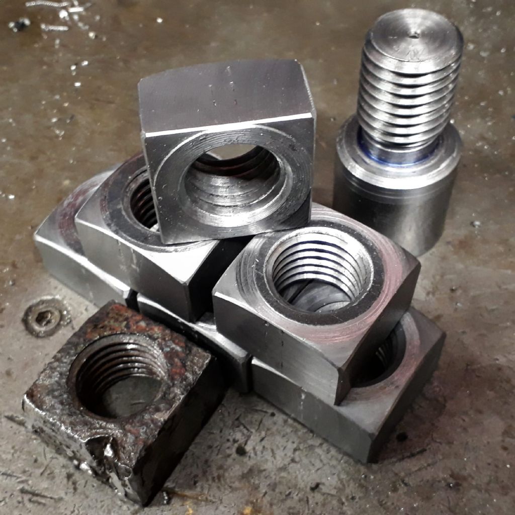

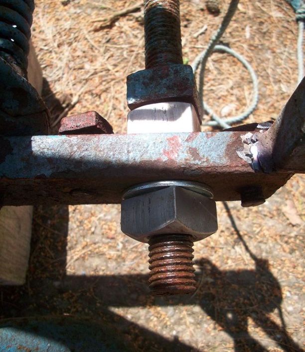

                                                All done now. Big cuts were to make big nuts for my brother in law's 1930s Ransome plough, 1 1/8" BSW 7tpi. He had some offcuts of 50mm x 25mm hot rolled (which were just too small to make 2 of course) so I started by rough cutting to length with an Aldi bandsaw. Then I milled to 41.5mm square 2 at a time using the aforementioned 60mm face mill. I did use the bandsaw to rough down the second side on some of them to see if it saved time on milling – it did. Final op on the mill was to centre drill then into the 4 jaw on the lathe to drill, bore and screwcut.
                                                big square nuts 02.jpgbig square nuts 03.jpgbig square nuts 04.jpgbig square nuts 05.jpg
                                                  If you are wanting to save on machining time, forget the boring part – drilling is to slightly less than tapping finished size.
                                                  I would rough screw-cut the threads and finish with a tap (under power in the lathe?) – likely saves time compared to getting the single point threading just right.

                                                    sorry i am confused if you got a tap why not drill it the correct size and tap the thread
