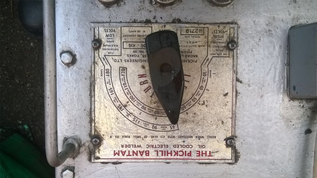

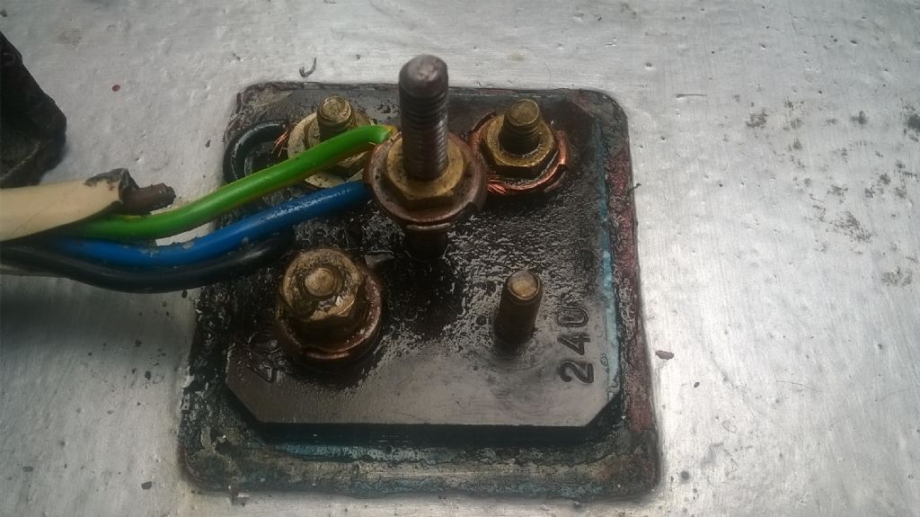

      I got a big set of welding equipment, sticks, masks, welder, etc.
      The main highlight, the welder is a Pickhill Bantam and originally thought "Oh darn, its a 3 phase one I will have to sell it".
      This is where the supply cable goes into the body, notice that the cable has a black, blue, green/yellow and brown wire. But only the blue, black and green/yellow is wired into the machine.
      The black is on a stud labeled 400 and there is another empty stud below that labelled 240. Should I switch it?
      On the voltage section it says 240V, 400V and 415V.
      Does anyone know if it can be used on 1PH?

          That looks very much like my long gone Cytringhan Bantam welder.
          IF it is you can use it on 1 Ph. 240V. I did on a 16A supply but you can't get the full grunt from it.
          The 415V is obtained between 2 phases, not 3 IIRC. but not certain.
          You may get some confirmation by searching for Cytringhan Bantam info.
          Beware! The oil may have PCB's in it no if it's ancient

            Looks to be the solution move from 400v connection to 240v connection.
            If in doubt ring them up and they will advise.

                  As Dave said above, those old oil cooled welders are a bit strange in that they only use 2 phases + earth of a 3 phase supply. You will be able to hook it up to single phase, the live will go to the 240 v stud. I run mine on a 20amp supply, but don't expect to burn much more than a 3.25 rod, I usually use 2.5's which is big enough for most home use.

                      Update! Neutral wire goes to 0 and the live wire goes to 240. And that way it kind of works.
                      Two days back my Aldi stick welder had the electrode holder fall off and I used 2.5mm sticks at 80A on that one.
                      With this one I tried the same thing and and after a few seconds the 13A fuse blew in the welder plug. While I knew that doing 180A would probably cause something to blow I didn't expect 80A to do anything untoward. That said I was using an extension cord because I didn't want to move the welder (its heavy), not sure if that effects it.

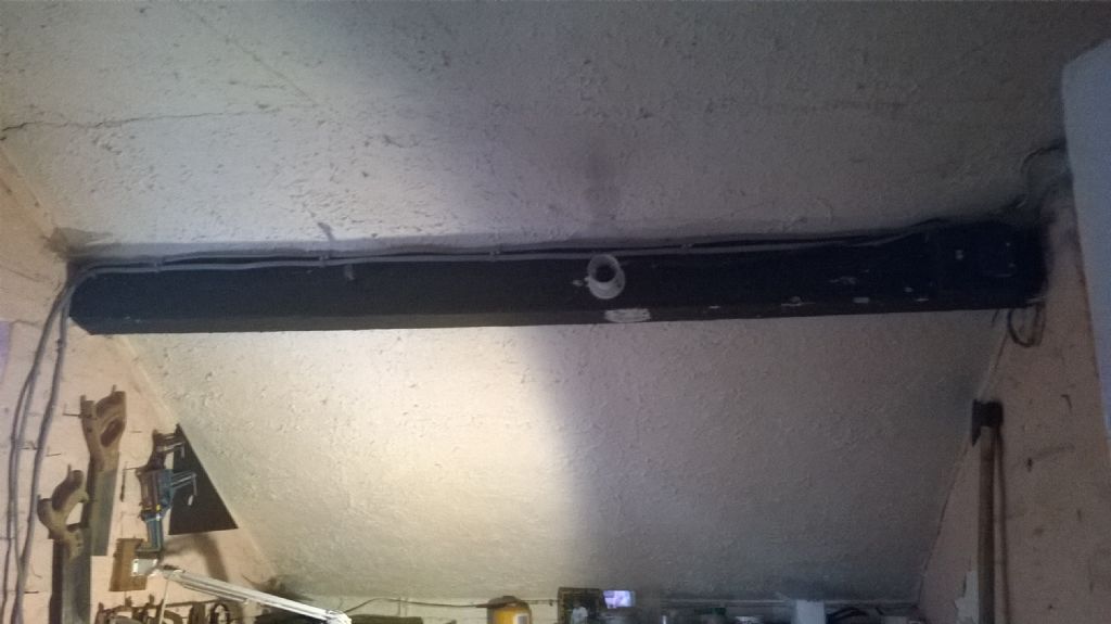

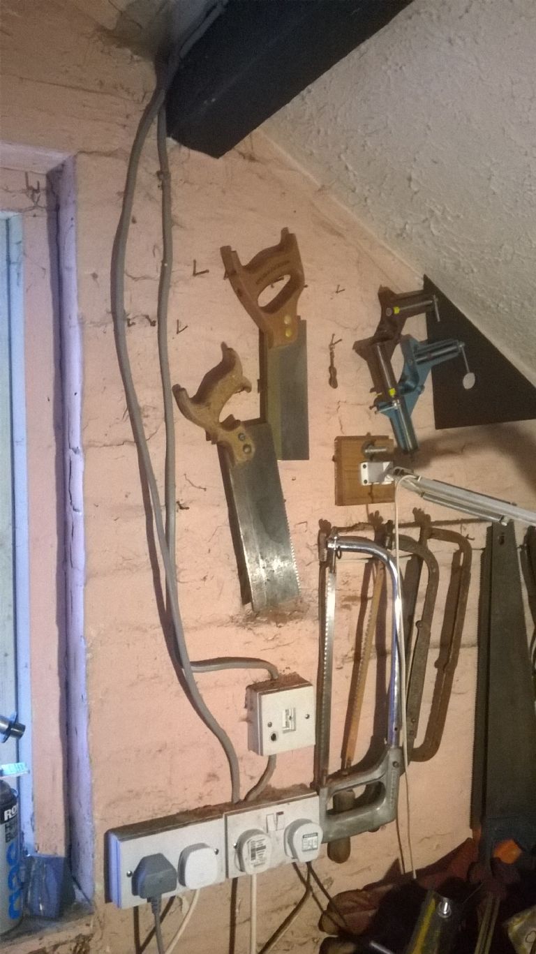

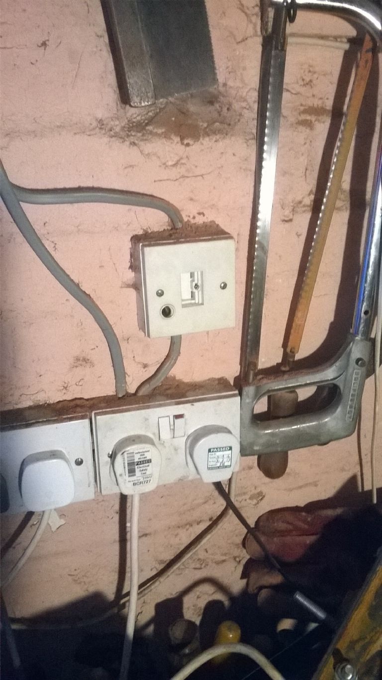

                                              So heres the wiring situation:
                                              The outhouse actually has its own fusebox (see it on the first image mounted to the right of the beam) with two fuses. One white (4A) and one blue (15A).
                                              I'm assuming the 4A fuse controls the lights while the 15A goes left across the beam and down the wall to the two double plugs.
                                              The I opened the spur box to check what amp the fuse was and uh… There wasn't a fuse in (why is it even there the fuse box is right next to it). When I turned the fusebox back on the plugs still worked without even putting the insert in. I didn't open the insides but I'm guessing the fuse blew once and instead of replacing it someone just ran the cables straight through the box and bypassed the fuse.
                                              This 15A circuit has a fridge attached to it, a washing machine, a tumble drier and then tools. Usually not all at once but the fridge is always on. This leads to 2 questions:
                                              1. Can I change out the 15A fuse for a 30A fuse by changing the wire?
                                              2. Should I change the fuse wire to 30A? Cause I imagine that if I have the 15A in then the welder would break it. But at the same time lets say the scenario is that no tools are welders are connected and the only thing running is the fridge. Then I have the problem of that the fridge could probably catch fire before the 30A fuse went. Don't know how realistic that is.
                                              I mean maybe 15A could power it anyway? Through the power of google and various forums and diy sites I now know a lot more about mains wiring than I did 2 days ago. I might still just get a qualified electrician depending on how much he would cost.
                                              #233591
                                              Speedy Builder5
                                                @speedybuilder5
                                                That little fusebox looks like an outlet for a fixed appliance ie: a cable would come out of that round hole straight to the appliance. The appliance would then have its own fuse sitting in that box. The circuit looks like a ring main and doesn't need a fuse in that box. Unfortunately, that fuse box has a fuse limit of 13 amps, so you could not wire your welder into it and put a 20 amp fuse in the box as it would not fit.
