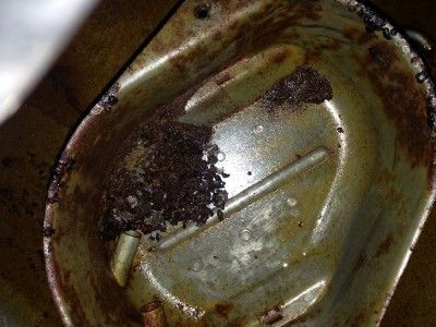

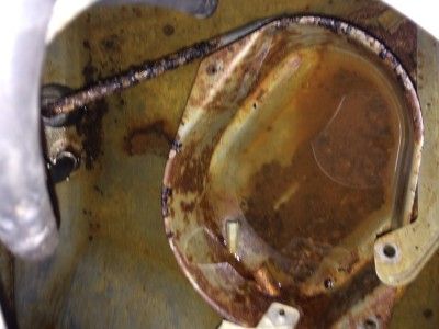

        I have a few pictures of the petrol tank, vintage 2001, and the two fuel pumps vintage 2017. These apparently replaced the originals when the problem was first noticed. I would attach them if I knew how to.

              Thank you Michael for the link, I've now created an album and will include the photos. (unfortunately the photos seem to have a mind of their own on here and I can't get the text where I want it, sorry about that. First attempt to load photos).
              These show the degree of corrosion in a car from 2001, so not that old. The tank is of that vintage but the pumps are only two years old and are genuine Jaguar parts.
              Top pic shows the pumps
              Middle pic shows the bottom of the tank
              Bottom pic show the pump sump in more detail
              My fellow club member had a lot of hassle trying to diagnose the loss of power with the car, and after exhausting all ideas (On board diagnostics didn't really help in this case) finally had the courage to remove the tank, not an easy operation. What he found amazed everyone, but he has now replaced the lot with new genuine parts and it's all OK again, but for how long?

                    Sorry, I missed out a crucial bit of the detective work….and age thing.
                    The diagnostics seemed to point to the fuel gauge/sensor not behaving as it should, and after a long time spent getting to and removing said sensor, this is what came out and focused attention on the tank and pump condition.
