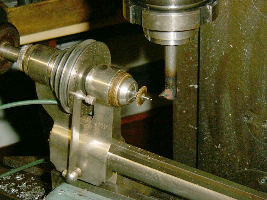

                                                    I have exactly the same lathe, and to be honest it does not get used every day, but there are some jobs where I would not be without it.
                                                    For instance, here is a photo of a musical box worm wheel being cut using the Boley as a tiny dividing head on the milling machine.
                                                    Phil
