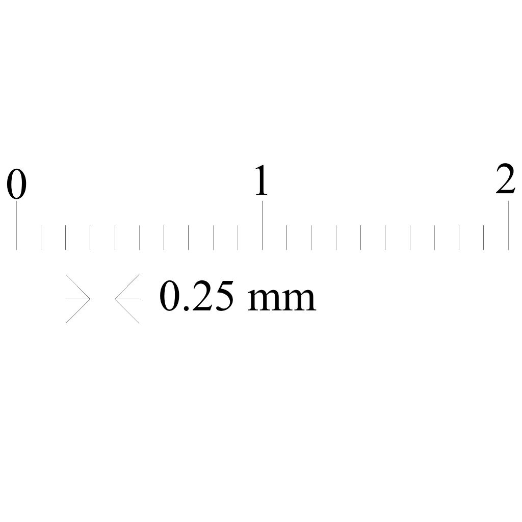

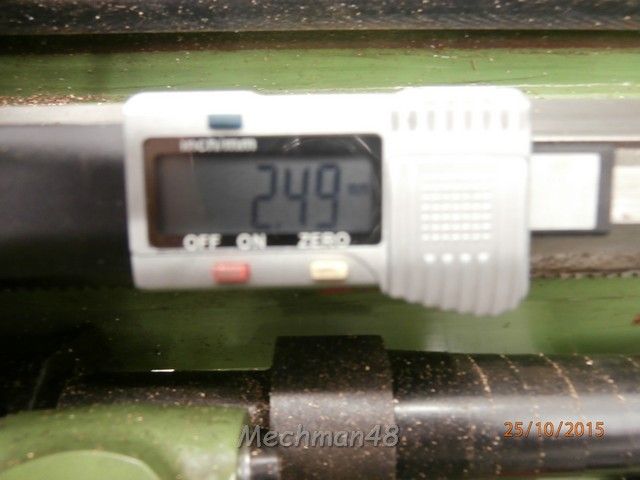

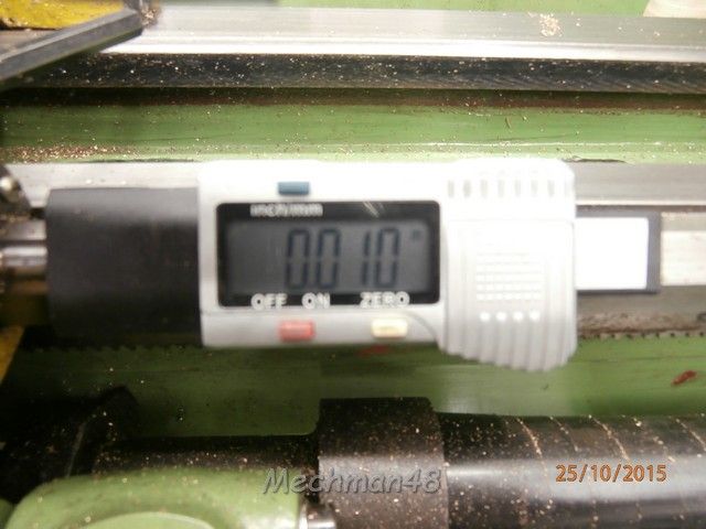

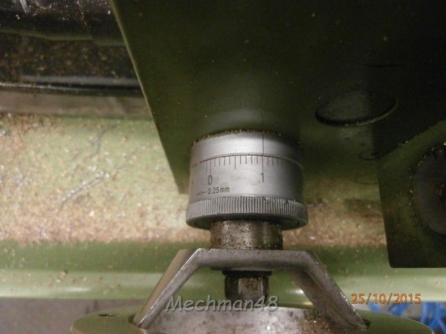

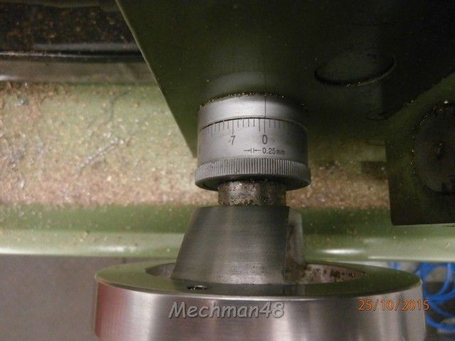

                            I’ve noticed on my new 250V lathe that the dial on the carriage hand wheel is calibrated with each division shown as 0.25 mm. So far so good, but the scale on the wheel then counts 10 graduations as 1, 20 graduations as 2, and so on and so on (see photo). This seems really unhelpful as to work out how far it’s moved you have to multiple the wheel by 10 then divide by 4. I’m just curious as to why it has been done like this ? Surely it would have been better for the first major graduation to read 2.5 ?
                            #209142
                            Roderick Jenkins
                              @roderickjenkins93242
                              I imagine it's so that each major division is a "tenth" of an inch.
                              Rod
                              #209155
                              Roderick Jenkins
                                Posted by Roderick Jenkins on 25/10/2015 07:14:54:
                                Sorry, that should of course be 100th with each division being a thou. I wonder if the leadscrew is 2.5 mm pitch or 10tpi?
                                #209186
                                mechman48
                                  @mechman48

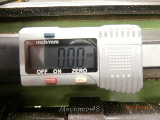

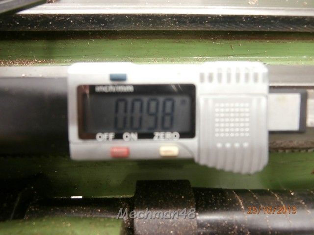

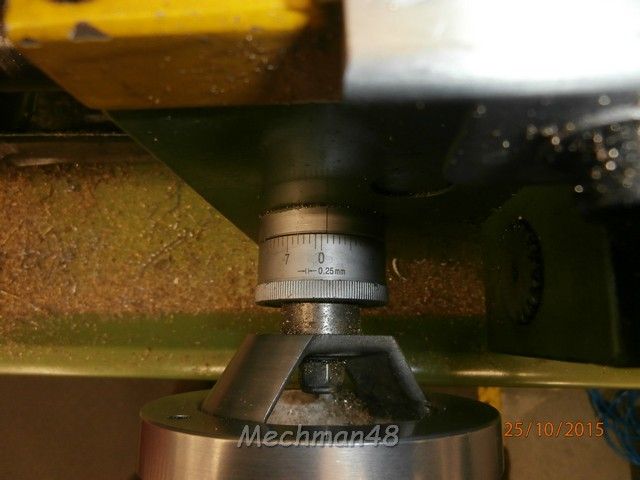

                                  David, just to clarify, went to workshop & took a couple of pics…
                                  set zero on saddle scale & digi readout..
                                  0 – 1 reading…
                                  Digi reading…
                                  Imperial equiv'… 0.098"
                                  moved saddle to 1 div'…
                                  1 div = 0.010"
                                  Hence 0 -1 on hand wheel = 2.5 mm saddle travel… 1 div = 0.010" travel ~ 0.25mm, as shown on saddle scale… ( calculator says .00984" ), readings +/- a couple of thou' all dependant on back lash on rack, accuracy of digi etc. Hope this has made it clearer.

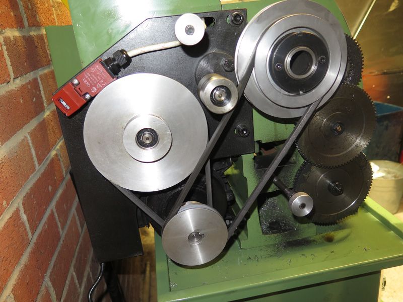

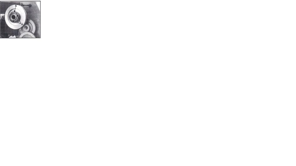

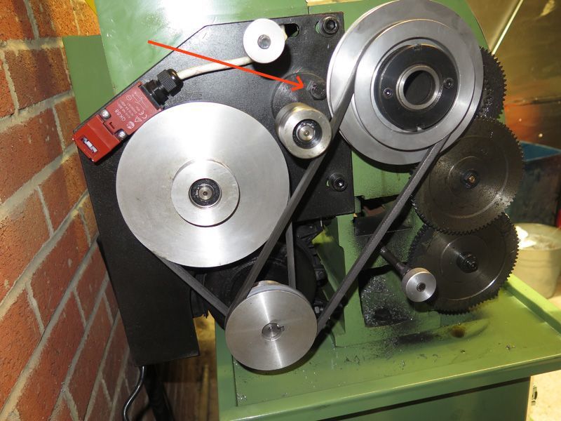

                                                The Warco 250 manual forgets to mention how to change the belt position. Does anyone know how to do this ? According to the manual it’s important that the tensioning roler is correct, but it fails to mention how to adjust it ?
                                                Thanks
                                                David
                                                #211151
                                                  Posted by David Cambridge on 08/11/2015 16:05:13:
                                                  I would imagine that adjustment is a simple three-handed matter of slackening the black Hex-head bolt; then rotating the disk to push the jockey-wheel in just far enough to set the correct tension [whatever that might be]; then, before anything slips, tightening the Hex-head.
                                                  Sounds a doddle devil

                                                    Hi David
                                                    Sorry I don't know which model 250 you have – I have a manual for the latest 250V inverter model if you need any info copying and posting here re belt positions etc. The roller (i.e. tension) is adjusted by loosing the bolt arrowed as Michael says…
                                                    Hope this helps
                                                    Cheers
                                                    Garry
                                                    Edited By Garry_C on 08/11/2015 18:01:32
                                                    #211176
                                                    David Cambridge
                                                      @davidcambridge45658
                                                      Thanks Garry. That did the trick.
