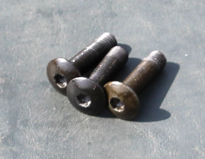

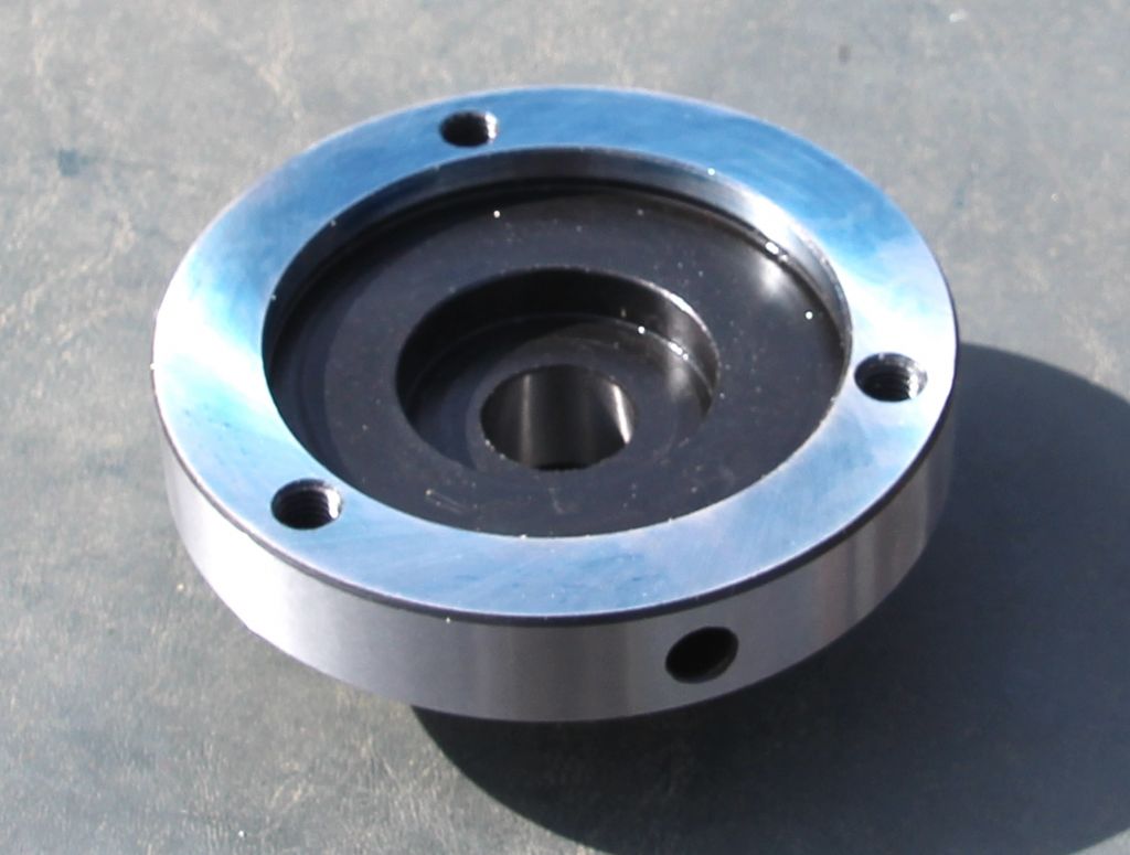

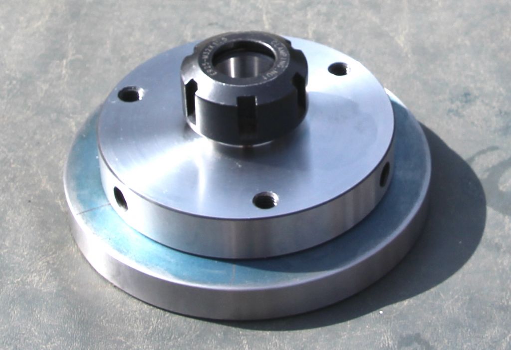

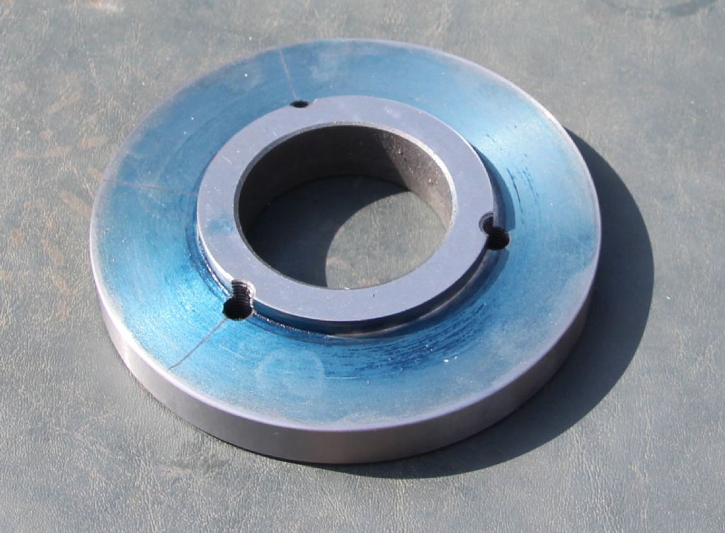

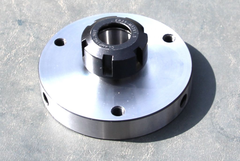

              George – pictures as requested re: new collet chuck. It's ER25 but only because my collet set was retained when I sold my mini lathe otherwise I would probably have gone for ER32.
              The register on the backplate was simple enough to turn – around 180 R.P.M and with a cheapo carbide tipped tool. I had cut some short lengths of studding to hold the back plate to the lathe spindle but found that when I tried to attach the retaining nuts – the studding turned. The solution was to dispense with my studding and use the studs that hold the 3 jaw chuck. These have flats that will allow a small spanner to nip them up and prevent them turning (they did suffer a reduction in length during the machining process but nothing to worry about).
              All that remains to do now is to clamp the chuck to the backplate and using a 17/64 drill (a snug fit in the tapped hole), spot drill through the tapped holes in the chuck and mark start dimples on the back plate.
              Next, unclamp the backplate and using a tapping drill for 8mm and the dimples as guides, drill and tap the fixing holes in the backplate.
              I intend using the three 8mm socket head screws to hold the chuck in place so I am going to need to remove the threads from the shoulder down to where they just locate into the back plate. Effectively, the tapped holes in the chuck now become clearance holes for the relieved screws.
              I have chosen to use this method as I find it soooo difficult changing chucks with all that palaver with the nuts and washers to the rear of the spindle flange. I do not have particularly big hands but it can still take ages to get a chuck changed. Have tried various dodges but am still trying to figure out an easy way of getting round the problem. I have not turned down the diameter of the backplate to match the chuck because who knows when it might be adapted for something else. I am well aware that this job can be done in various ways – this is my way! I would add that I had to remove the spring steel lead screw cover in order to get the tool up to the backplate. If you do the same I would advise using thick gardening gloves – thrise I was sliced and blood gusheth.
              I unlocked the shop at 3.00 this afternoon with the intention of finishing the job but inside the mercury stood at 109 Fahrenheit. A cold Chardonnay spritzer suddenly became far more enticing —— cheers!
              Rik

                Thanks for the write up & pics; same as you I have the ER25 set, again left over from earlier times.
                How did you remove the leadscrew cover..did you have to unwind it leaving the brackets on, or take it off all in one with the brackets as well ?

                    Hello George – I left the bracket on and just pulled the spring off.
                    Having completed my collet set chuck machining and on testing it this morn was very disappointed to find a test piece was running out .0023". Have spent much of this morning investigating and have just found out why. The Chinese machinist had bored the backplate out oversize – not a lot – but enough to account for the runout.
                    I need to speak to Mr. WARCO about this but they have not been answering their phones for three days or so. If it IS a faulty line I would imagine the bossman must be very angry with the telephone company. Or is there a little more going on – or not????
                    Rik

                        Because the backplate  hole has been bored oversize WARCO have requested I return it FREEPOST for exchange. Before I do though, I am performing a small experiment. I have reduced the diameter of the collet chuck register on the back plate by about .003". I refitted the collet chuck with screws "nipped" and using a clock, tapped the now "floating" chuck into position a' la universal grinder. It runs now absolutely spot on.
                        My thinking is that as the "floating chuck" principle works well on a universal grinder because of the light "cuts" that are applied it might just work with the lighter duty work that is performed when using collets. Tomorrow I will use the largest of my ER25 collets (16mm) to hold a piece of steel and give it some welly. I am hoping the chuck stays put, I think it will. If it does then I'll not bother returning it.
                        Rik

                                      Have managed to do more work on my "floating" collet chuck today. Going for broke I removed a further .005" from the backplate chuck register then refitted the chuck with screws just nipped up. In with a collet and a 8mm dia. x 100mm piece of ground round tool steel as a test piece. Used a tenth clock and a lump of brass to tap the chuck/test piece true – zero deviation on the needle. Tightened chuck retaining screws. Clocked test piece again – no deviation.
                                      Now for the acid test, will the chuck shift or will it stay put. Replaced test piece with length of 12mm MS. Used first my own version of a diamond tangential tool holder to advance tool .125" and removed .250 from diameter for about 1" length. ( I love this tool and am glad I spent the time making it). Repeated this with a brazed carbide tip tool. Here, I put the test piece back in and took readings – no deviation.
                                      Repeated the above twice more – no deviations on clock.
                                      Conclusion: the job seems to be a good'un. I intend giving the setup a few more weeks work and if all seems OK I will not be returning the backplate to WARCO. (Phonewise, they are back "online" George).
                                      Rik
