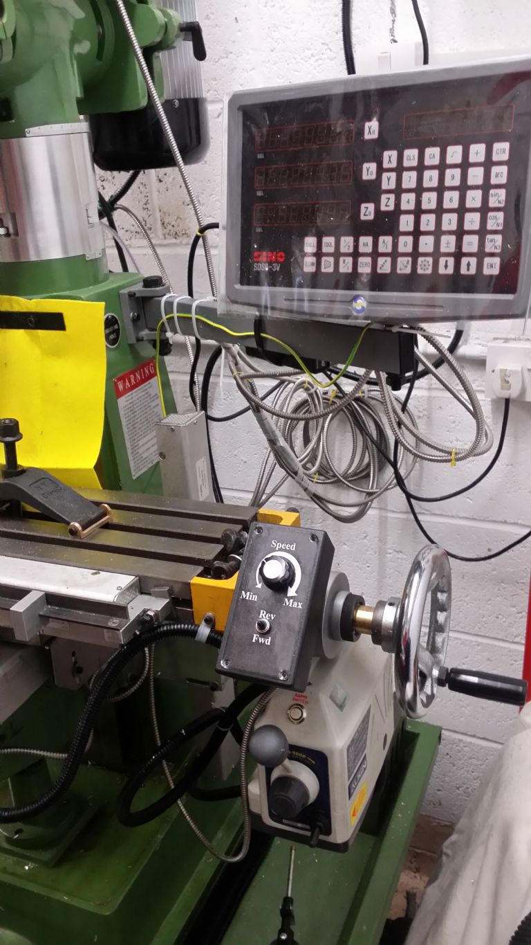

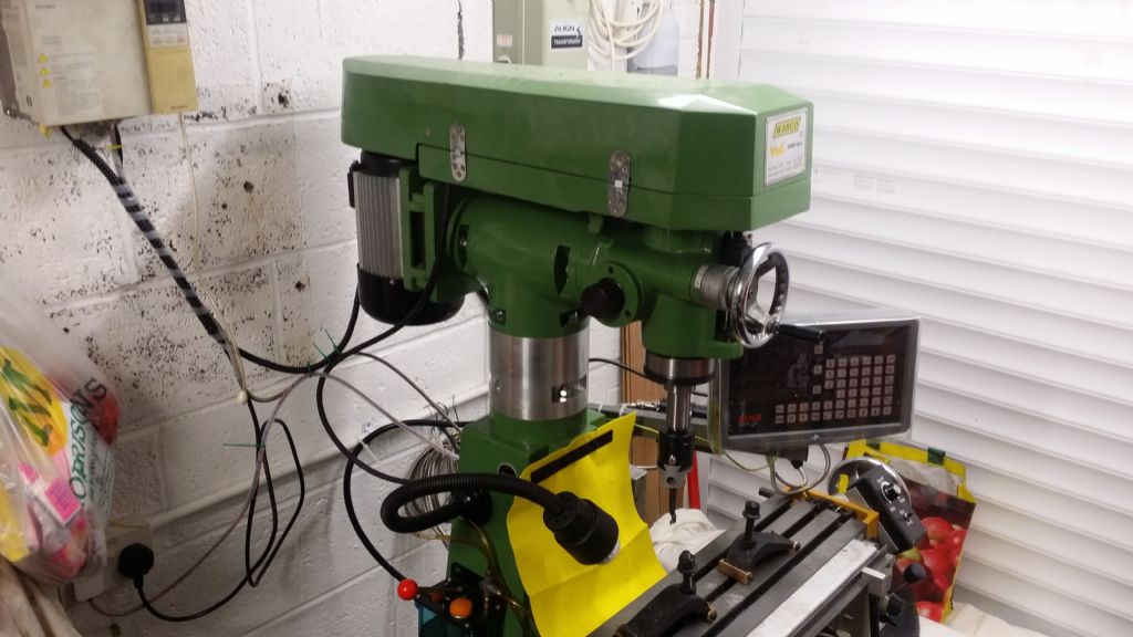

                        A friend has just purchased a Warco VMC which he ordered with a 3ph motor. I converted it to delta, added an inverter, and we added a a 3-axis DRO from MachineDRO which went on the X,Y and Z axes (knee), plus a magnetic reader for the quill which integrated with the knee. The Z display now gives the distance between the quill and the table. He also added power feed to the X-axis
                        He also, was concerned by the lack of headroom so we made a 5" raising block, which has totally solved the problem.
                        He is now very pleased with the mill, which has been checked as being very accurate.
                        The only thing he didn't like was the rather unyielding plastic sheet/cover for the knee and Y-axis dovetails, which he replaced with a far more flexible cover in a bright yellow colour, which doubles as a useful background when milling.
                        In the photos, the inverter can be seen on the wall, and the X-axis DRO scale can be seen to have an extension in front that still allows travel hard stops to be used.

                              Gary, is that riser block Alloy or Steel?

                                Gary Wooding
                                  @garywooding25363
                                  The riser block is 6082T6 alloy.
