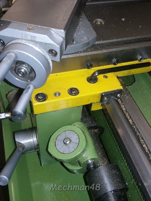

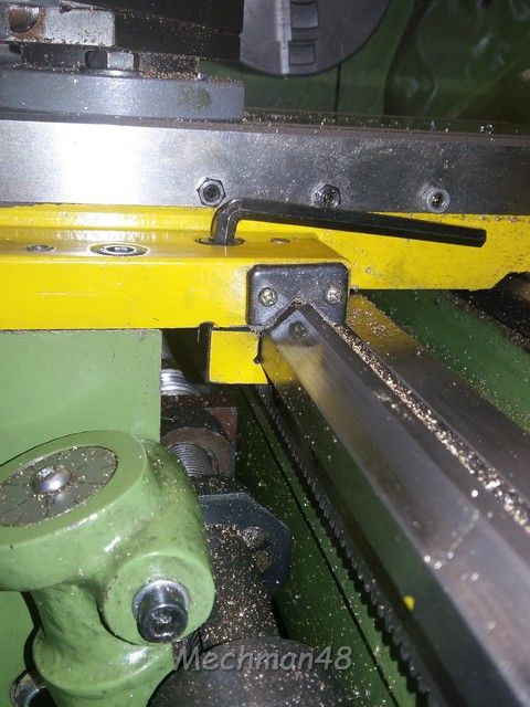

                                    #212413
                                    mechman48
                                      @mechman48
                                      Posted by Bill Dawes on 14/11/2015 18:13:39:
                                      I will have another look. At first I thought I had found the carriage lock mentioned in the manual.
                                      There are four socket head screws, two each side which I assume hold the carriage to the apron and a further two nearer the bed, one each side of the cross slide, I thought these were the carriage locking ones as you can see them going into a stepped block underneath the slideway. Locking them up however left a few thou gap so when Warco confirmed that there is no lock I decided the block was to prevent lifting of the carriage.
                                      Bill D
                                      The stepped block (item 13 ) IS the carriage lock; I have the 250V-F & it is the same fitting on mine although the manual shows a different fitting so manuals don't necessarily match the machine. There was also about 10 thou" gap in mine so it wouldn't lock the saddle up , I removed mine & filed approx' .020" off the mating surface, it now locks up quite solidly with a 1/3 of a turn.
                                      N.B. IIRC, on mine there is another cap screw that fixes the block to the apron, it screws in from the bottom so worth while checking on yours, you could actually use this to set the gap.
                                      My saddle lock… allen key is my method, you could use a hex head bolt or other means…
                                      … the other mounting SHCS is fitted from under the block to the right of the visible cap screw, check yours.
