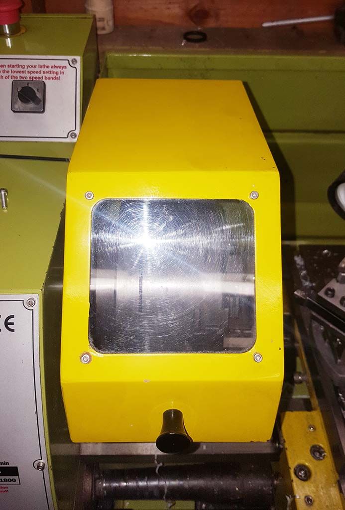

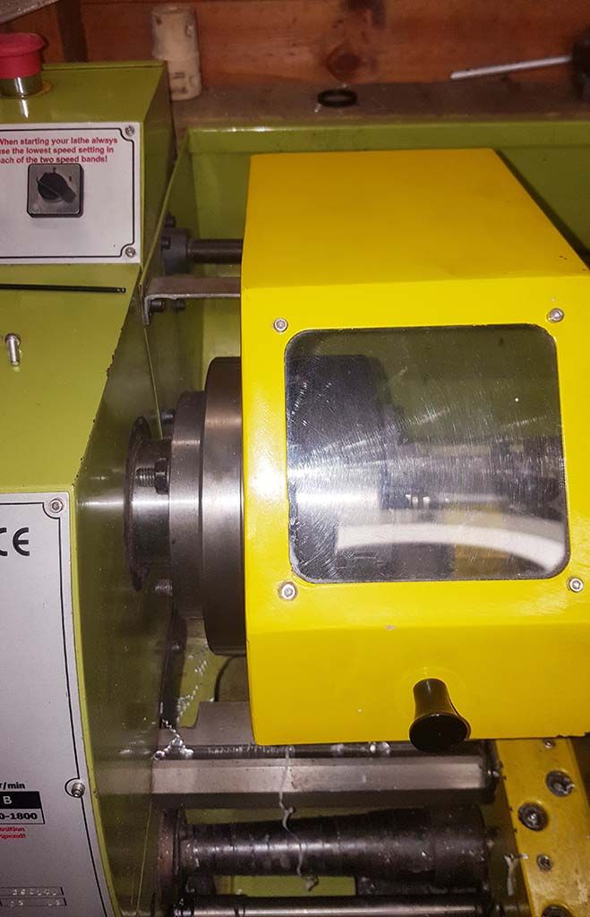

      Just thought I would share this mod
      I find when using coolant I end up getting covered so have modded the guard so it slides out over the work
      Std
      Extended

              I tend to only use it when parting off and just a case of trying to keep things clean
              Anyway was just a mod I did and I am happy with it cheeky

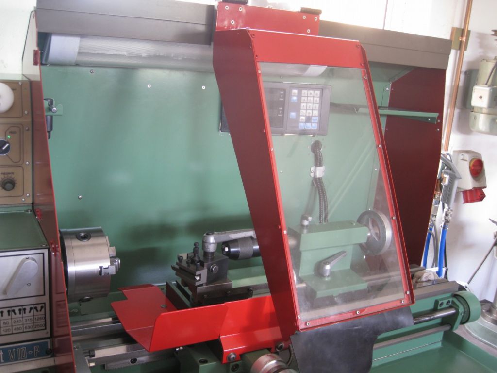

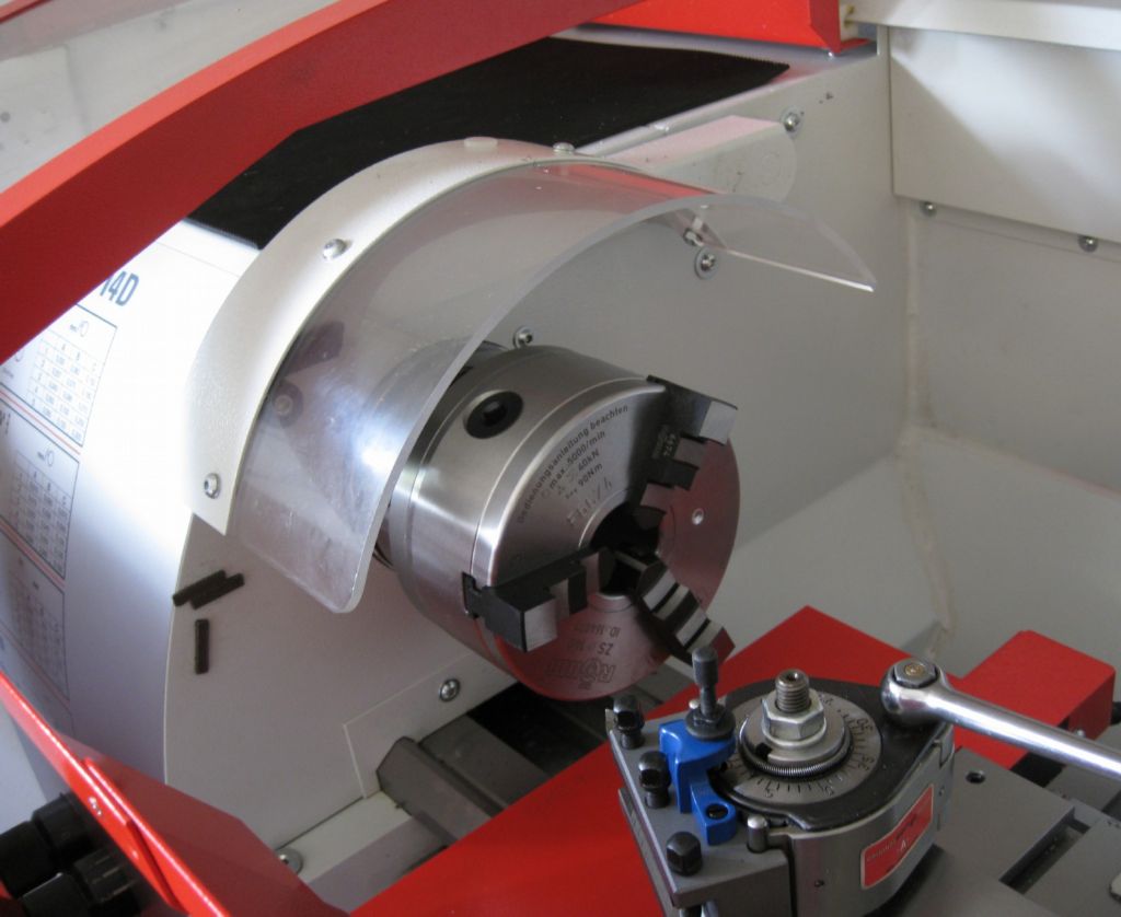

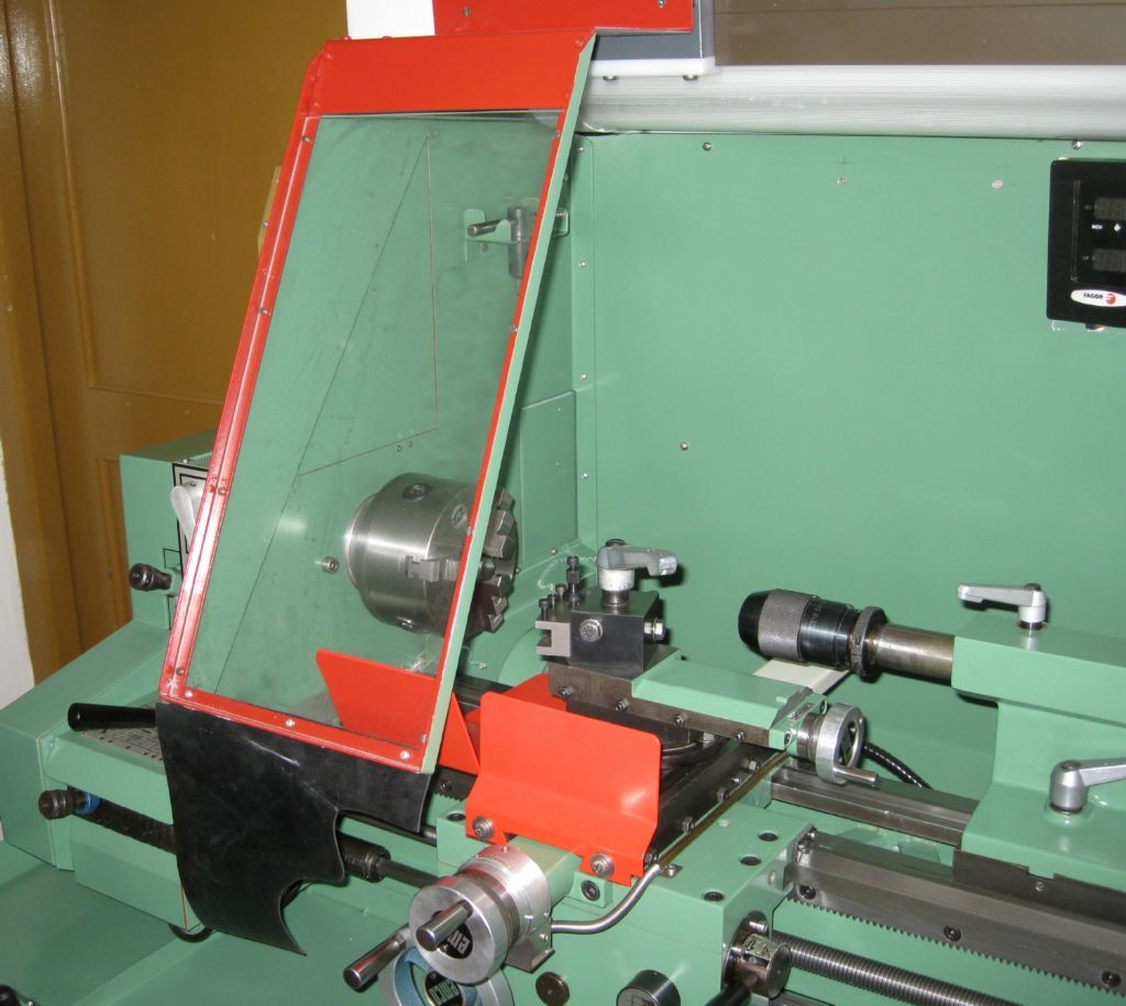

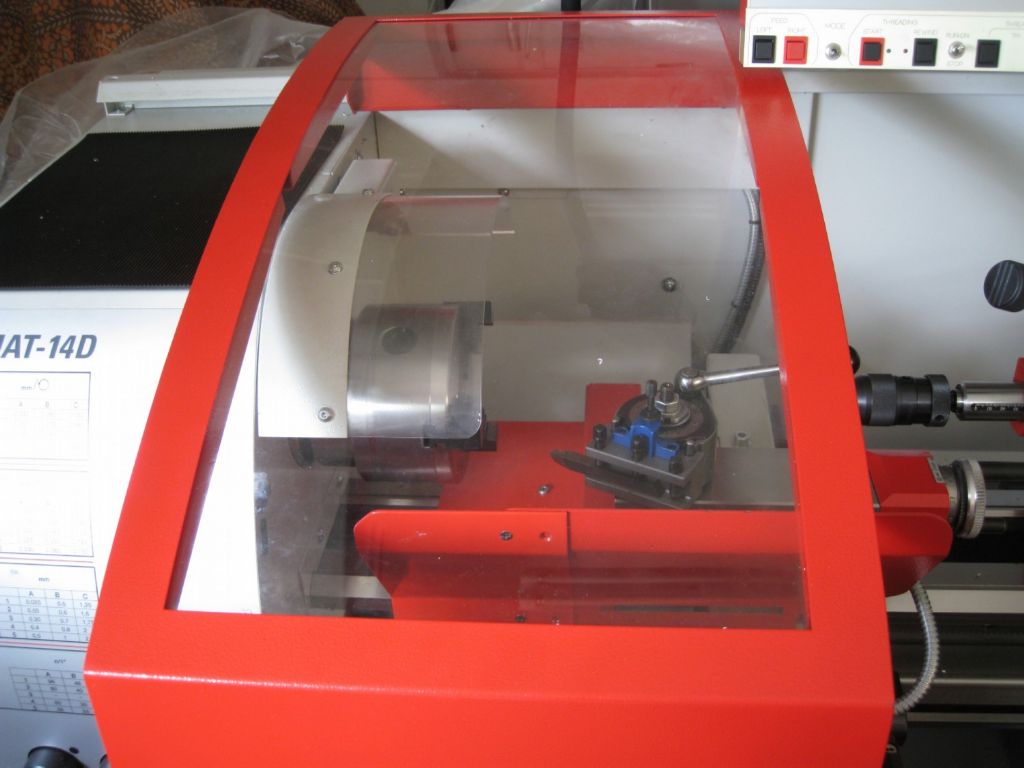

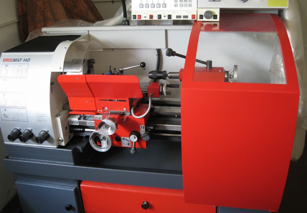

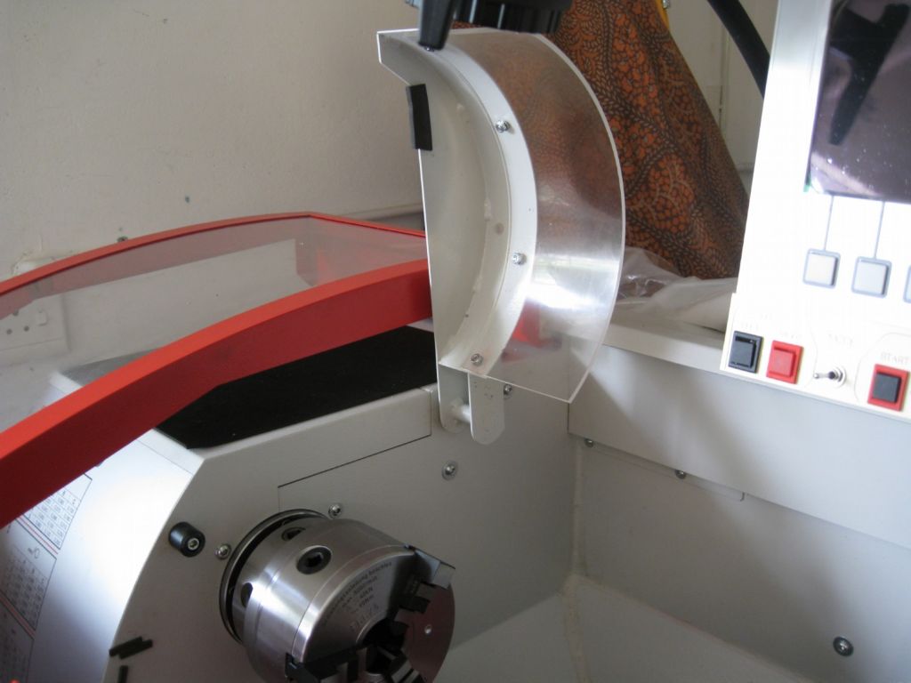

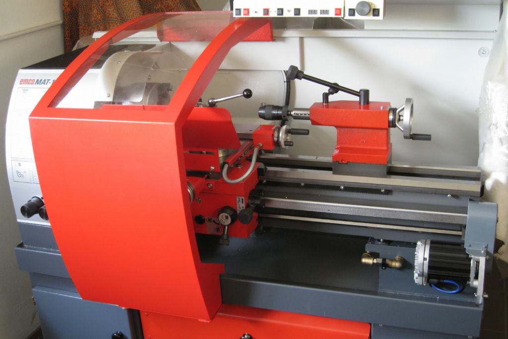

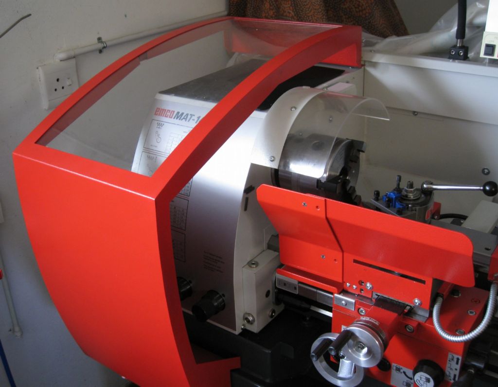

                            I made some guards for my EMCO Maximat V10P. For interest I have included some pics of the as-supplied guards on my EMCO 14D lathe.
                            The V10 Guard slides left/right on a rail, and can be hinged up completely out of the way. The 14D has a small swing-up safety/splash guard above the chuck, and then a large guard that also slides left/right.
                            I would not be without these guards – keeps swarf from taking up residence all over the shop – esp when cutting hard brass! I do not use coolant much, but when I do it is from my shop-made 'mist' coolant device – not really a mist device, but nice small drops of oil suspended in an airflow, onto the cutting edge. That does still eventually great an oil film which is flung by the chuck, so the guard does the job again – keeps the oil from my spectacles…
                            V10 Guard at left side – front view
                            Guard slid to the centre of the machine.
                            Guard hinged up out of the way.
                            14D Chuck small Splash/safety guard down in place
                            Same guard raised. Lathe will not turn on in raised position.
                            Main Guard at left position.
                            Main Guard in working position.
                            Oblique view of in-place guard. Hands and arms fit around the guard very easily to manipulate handwheels and levers.
                            Main Guard slid to the right
                            Joe
                            (Yes…I know…The machines are too clean…)
