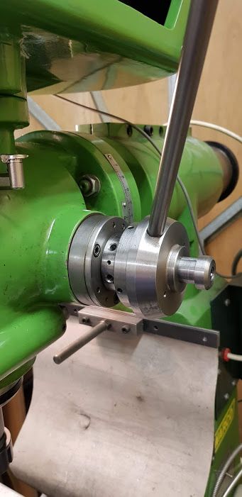

            Hi Youra.
            I have an A2F from 1998 ,the backlash from the downfeed
            pinion to the quill on my machine is .031 inch so not so much different
            from your machine, it has always been like this from new.
            Part of the problem is that the weight of the quill is unsupported ,the
            return spring is on the pinion ,i altered my machine by fitting a loose pulley
            wheel on the pinion shaft and machining a slot into the quill body and
            using a thin stranded cable (1mm) routed it out the back of the head
            casting to a gas strut which lives within the hollow tube .
            This does require some extensive machining and modifications to
            some of the parts of the head.
            This worked well until the gas strut packed up ,a suitable spring
            would do the job just as well . I altered the quill lock to a two part
            aluminium part see photo that has a left and right hand thread so that it will
            release properly and can be adjusted to give a positive feel when
            down feeding.
            You can inspect the pinion and rack fairly easily just by removing
            the parts you have identified, the handle return spring is under the
            cover on the handle side care is needed when removing
            as the spring is under some tension make sure that you fit some
            packing on the table under the quill as it will drop when the pinion
            is removed ,check also that the quill locking pads are in the correct
            position when you reassemble as they can easily be put back in
            the wrong position and damage the quill.
            Some other photo's of this machine in the album.

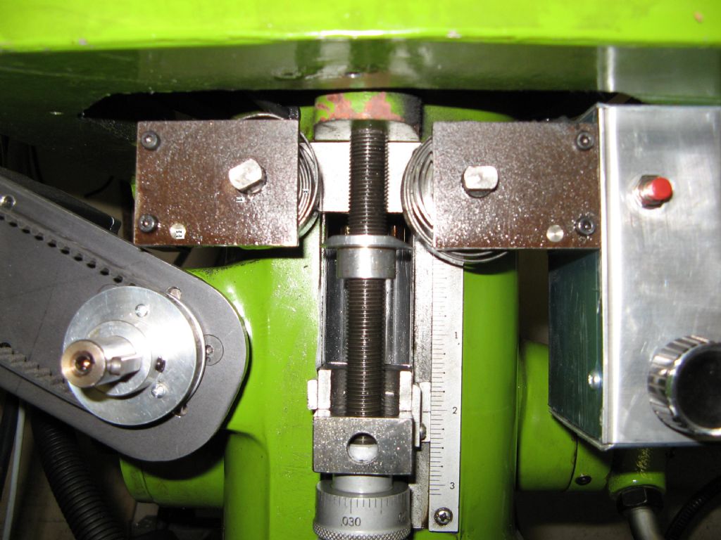

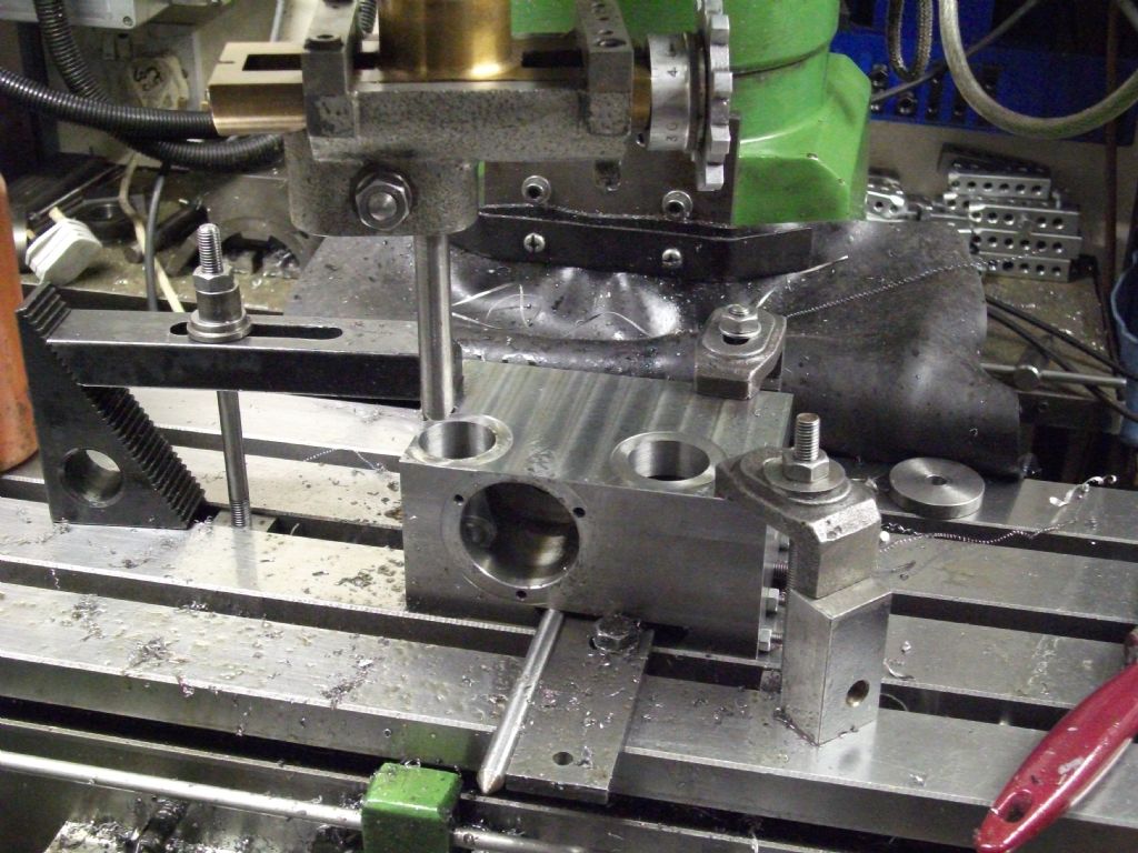

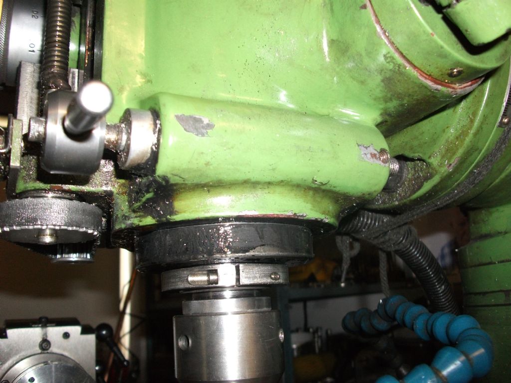

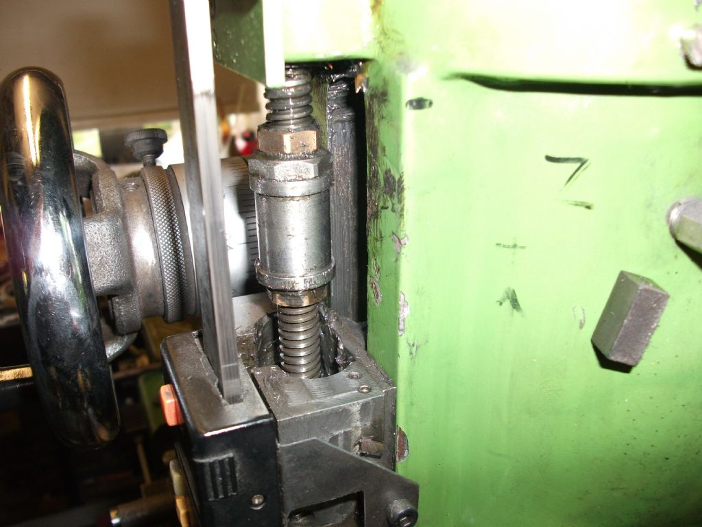

              #458715
              John P
                @johnp77052
                Hi Youra.
                The external depth stop was the first thing that i got rid of ,a completely
                useless part ,as you are probably aware the down feed index dial reads
                in units that are nothing to do with reality so a digital readout is a must for
                one of these machines.
                The cnc drive attaches to the existing holes that are in the quill from the
                the depth stop part ,the head has to be removed to rebore the top and bottom
                lugs of the depth stop to suit the ball bearings for the lead screw.
                As can be seen from the photo the lead screw is 7/16 x 10 TPI and has an anti
                backlash nut. The connection for the nut has a split clamp that mounts on a
                horizontal dovetail that connects to the quill ,to engage the nut the two halves
                are located around the nut and clamp with 2 m4 screws.The stepper motor
                sits within the original profile of the head ,as the machine is part manual with
                cnc the head can be used over at 90 deg and still get down close to the table
                if needed.
                I did consider trying to improve on the rather poor down feed problems
                associated with this machine but never use now the down feed handle for boring
                type applications .The machine has been in this part cnc state for about 14 years
                just using the Z axis for such things is easy to fit the 2 clamp screws and a control
                file to down feed and return to a set depth is much easier than using the handle.
                As can be seen in the second photo boring down in this blind hole is easy and the
                zero backlash of this connection to the quill is worth having.
                Edited By John Pace on 21/03/2020 20:24:27

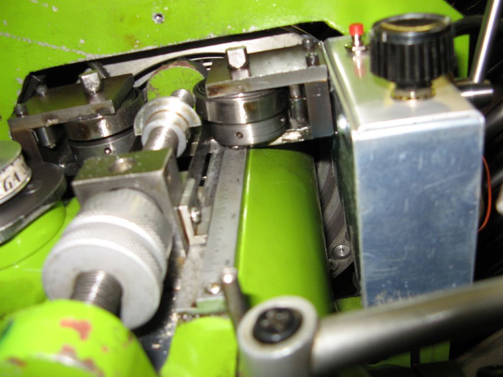

                            #460449
                            elanman
                              @elanman
                              Youra,
                              I did not use any calculations. I also have a Dore Westbury and so copied the idea from that. I made two as the quill is a lot larger than the DW. I do know that I made the springs twice as the first ones were not strong enough.
                              Sorry I'm not more help but it was a long time ago now.
                              Cheers

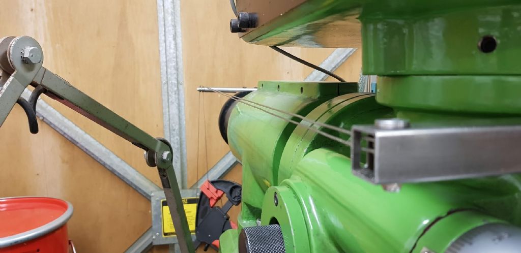

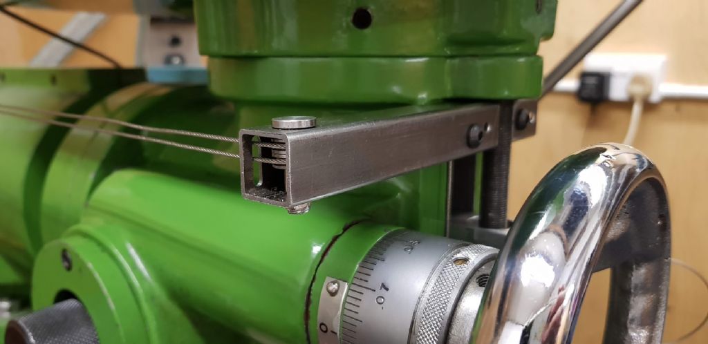

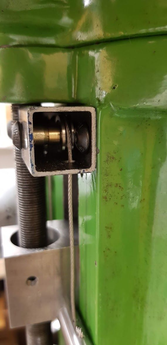

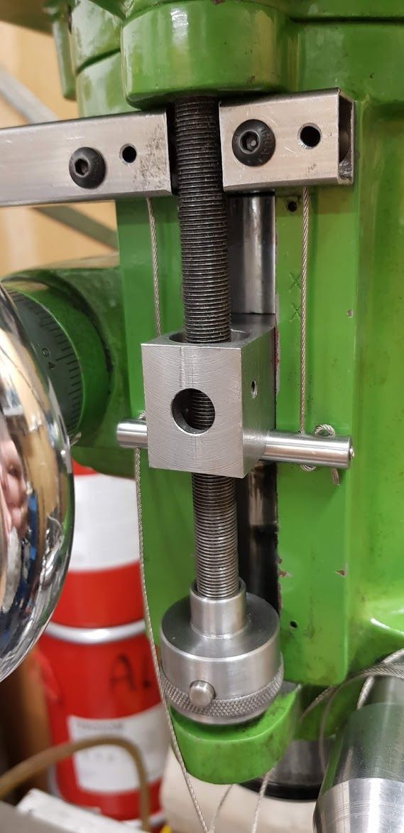

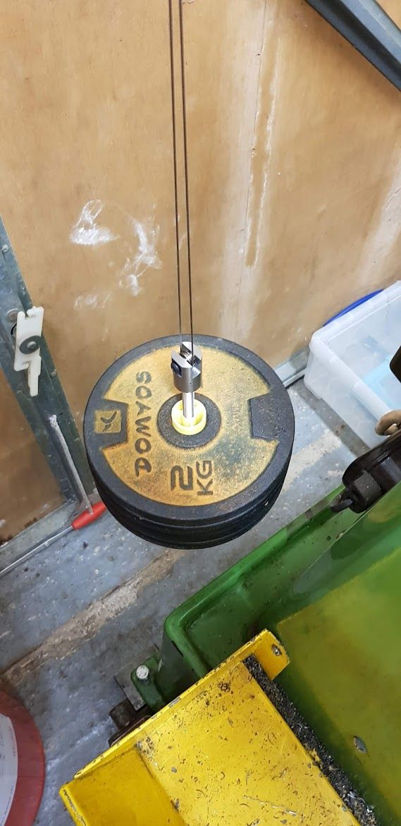

                                A few months along, and I thought I'd tidy this up in case anyone's still interested…. teeth 2
                                I decided on a weight counterbalance system, as I couldn't easily see how to get a gas strut into the space, and also wasn't too keen on the possibility that it suddenly fails. Springs were interesting, but again more challenging due to the space constraints.
                                I've adapted the existing quill guide block to carry a bar that's pulled up on each side by two 1mm stainless steel ropes that are tensioned by weights at the back of the machine.
                                The routing of the cables to the back is dealt with by a series of pulleys in a length of steel box section:
                                and finally there are ~8kgs of weights hanging on the end pulling on the cable. I printed a spacer bush to keep everything central and nicely symmetrical – much more material efficient than turning up something from the stock I had to hand:
                                (Some of the pictures were taken before the weights were attached, hence the cables are slack)
                                So far, it's doing really well – I'm confident that the cable strength is sufficient for the application – each cable only carries around 5kgs, and the manufacturers tell me that even with de-rating, each 1mm cable is comfortably rated at 25kgs. I've used the largest hardware (M5 mostly in pairs) that I could comfortably fit in, so in theory at least nothing is close to breaking.
                                Finished a week or so ago, I think it's doing the job I might add some more weight to make the upwards force a little more positive, but the backlash and lumpiness is largely gone!
