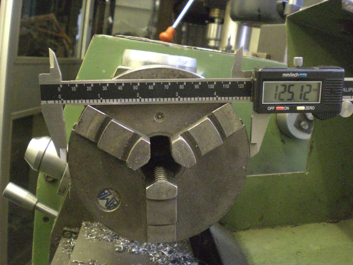

                    #715459
                    Nicholas Farr
                      @nicholasfarr14254

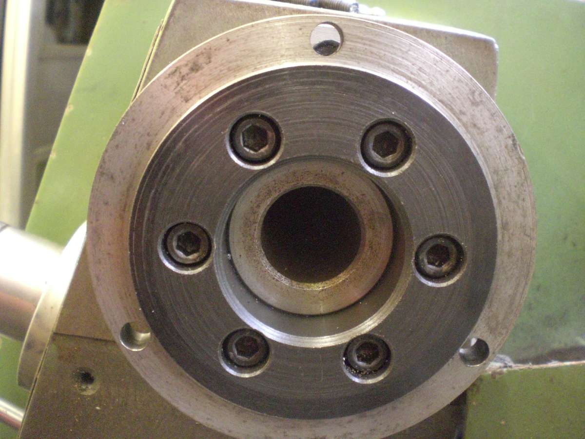

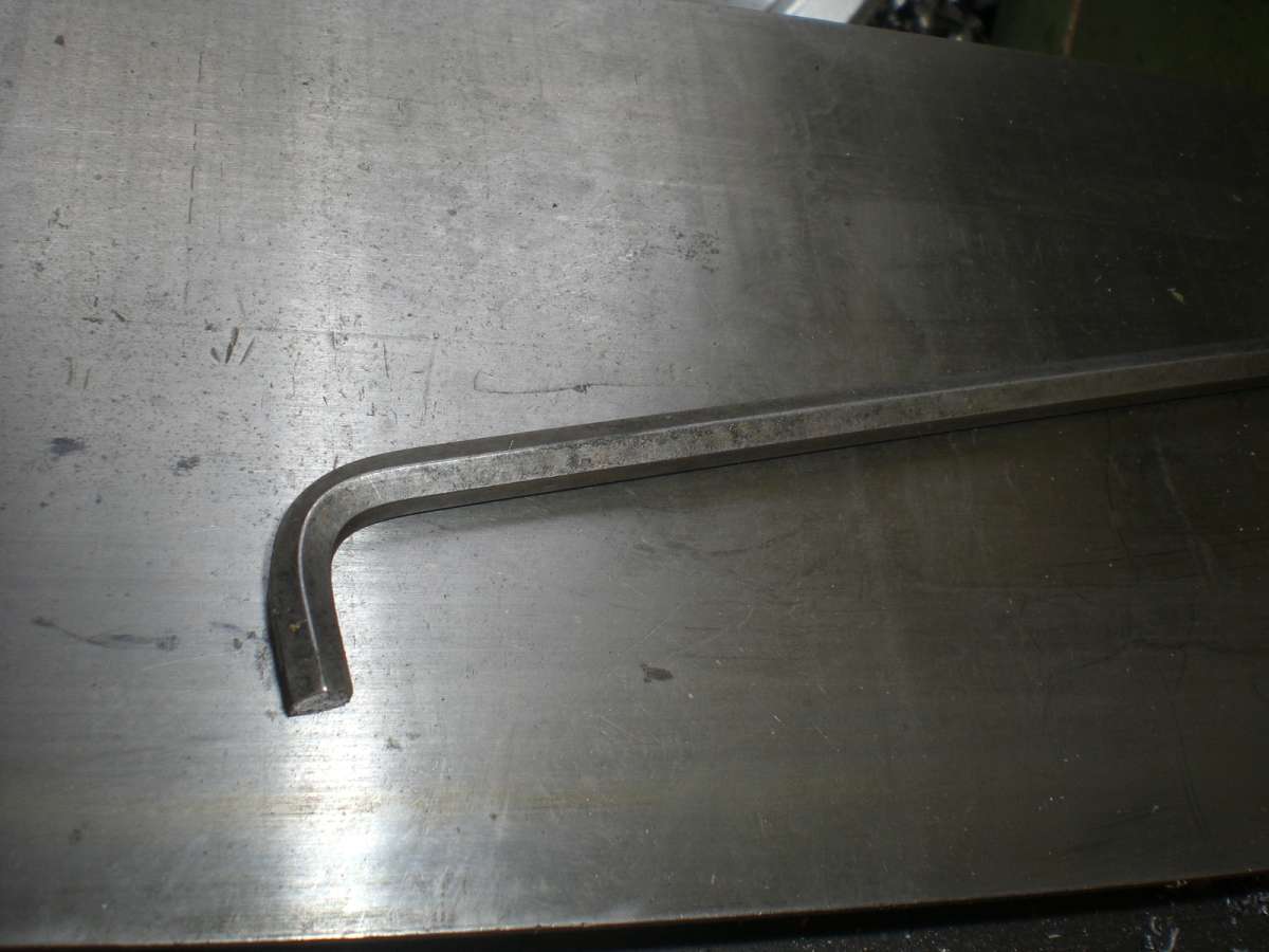

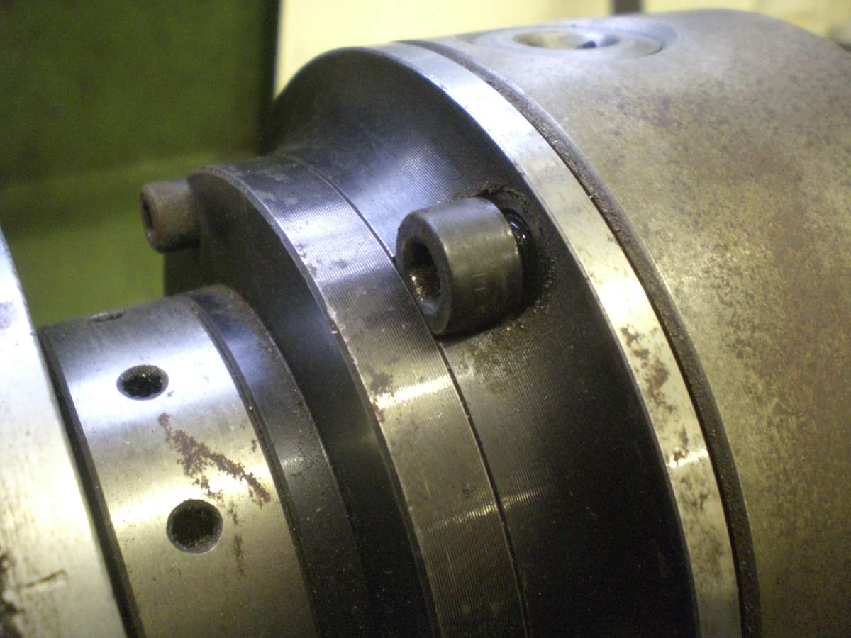

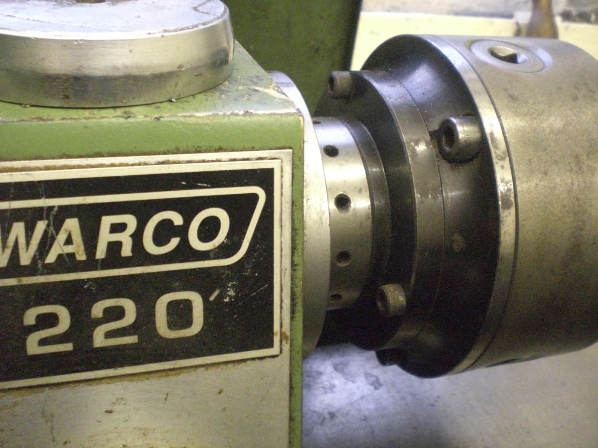

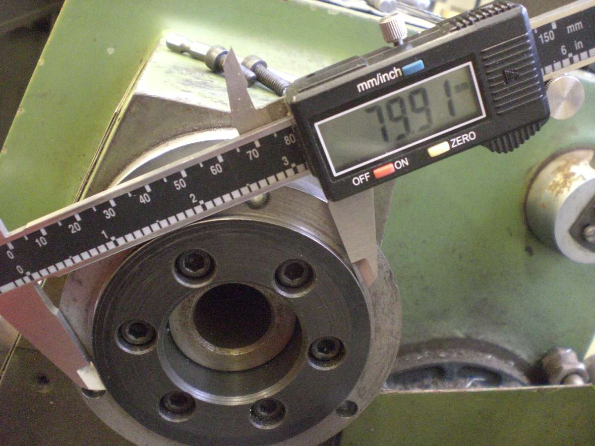

                      Hi, I’ve had a look at my Warco 220 this morning, and it has a 125mm three jaw chuck, which is mounted on the six hole backplate with an adapter plate.
                      CIMG3338
                      CIMG3339
                      CIMG3341
                      As you can see in the above photo, it’s difficult to remove the chuck, without removing the adapter plate from the six hole backplate first, as the socket head screws hit the backplate after a couple of threads.
                      CIMG3342

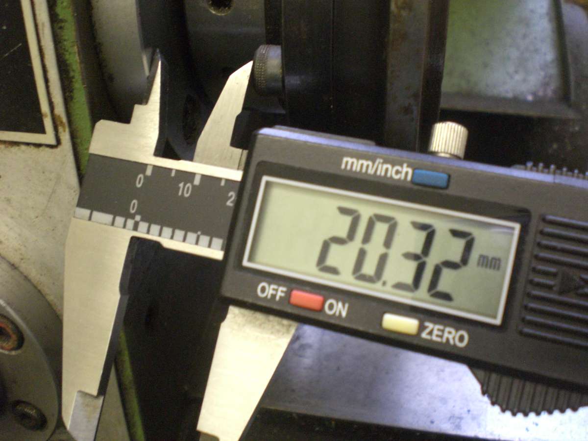

                      The backplate has its own little niggle, as there is only just a little over 20mm between the three socket head screws and the headstock, and requires a cut down socket head key, which I keep with the machine.
                      CIMG3346
                      Once the chuck with the adapter plate is removed, the six socket head screws that hold the backplate onto the spindle flange are revealed, and if you have the optional 8″ faceplate which was available for this machine, you need to remove these six screws to fit it in place of the backplate.
                      CIMG3344
                      CIMG3343
                      The register on the backplate is 80mm, as can be seen.
                      Regards Nick.

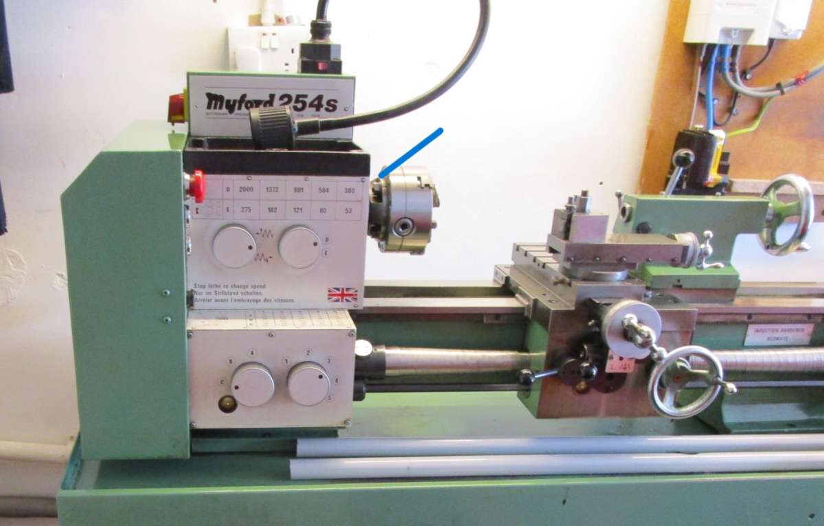

                      #715467
                      MichaelR
                        @michaelr
                        Could you fit studs into the chuck body and attach the chuck to the backplate with shouldered nuts
                        Similar too the Myford 254s marked with blue line
                        IMG_0187

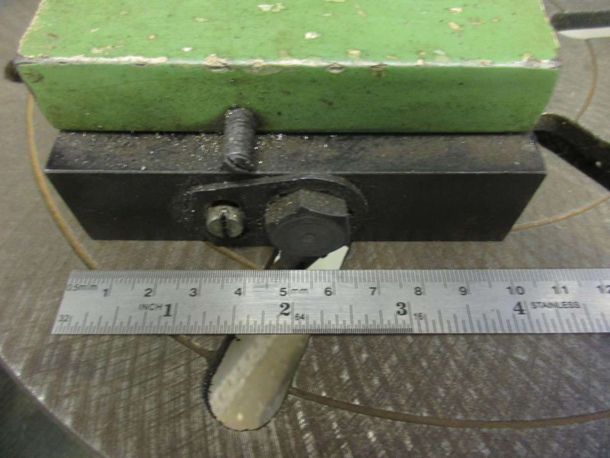

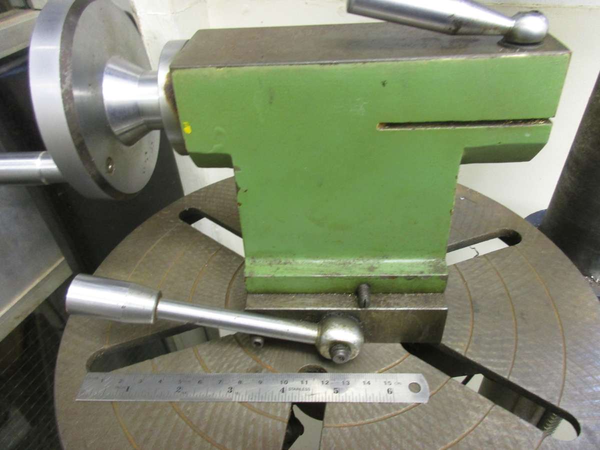

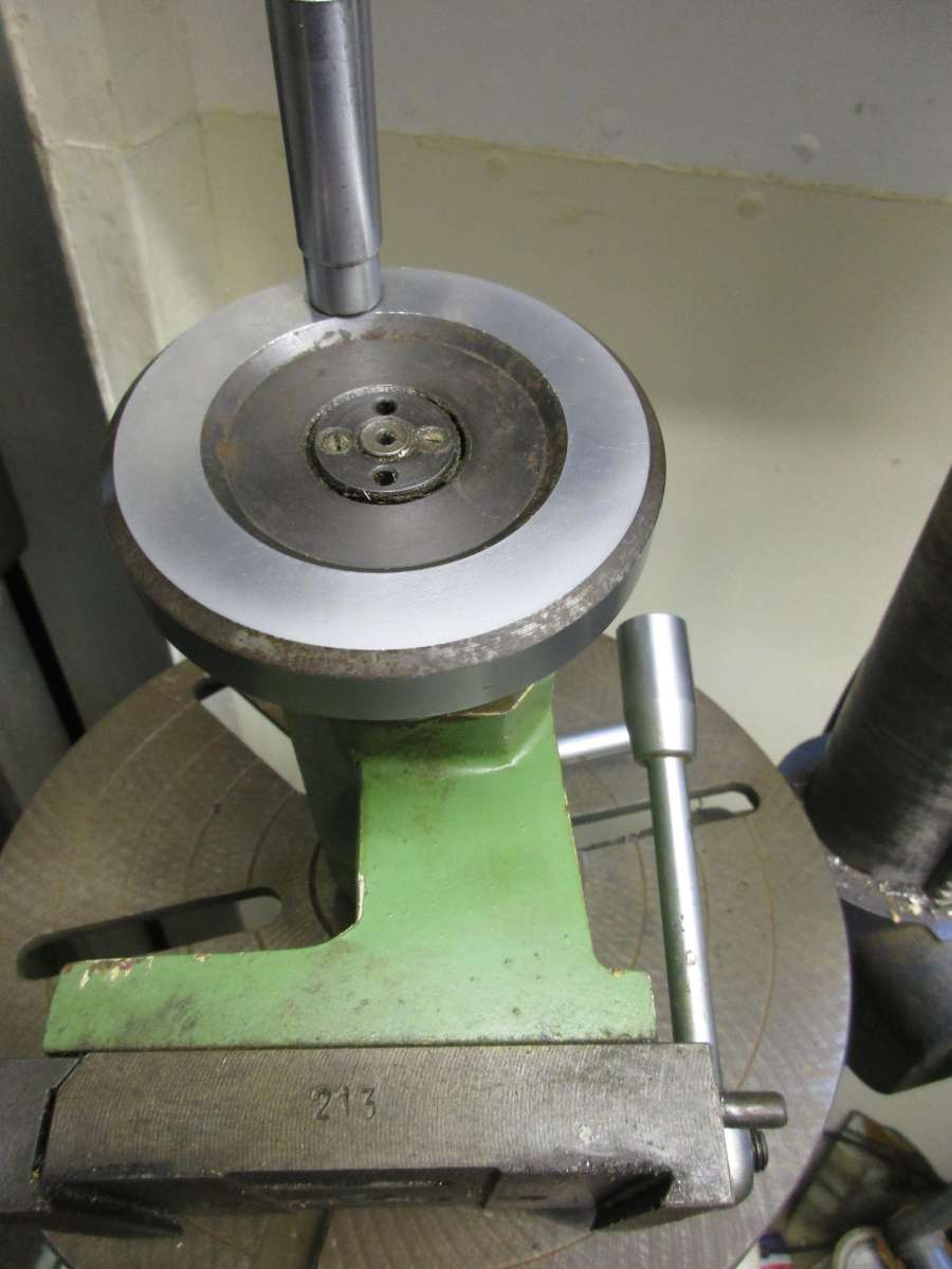

                                          #715536
                                          Nicholas Farr
                                            @nicholasfarr14254

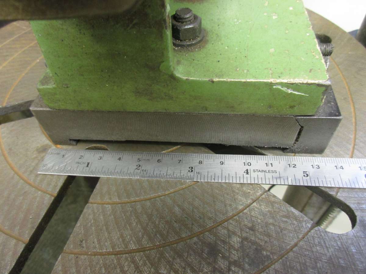

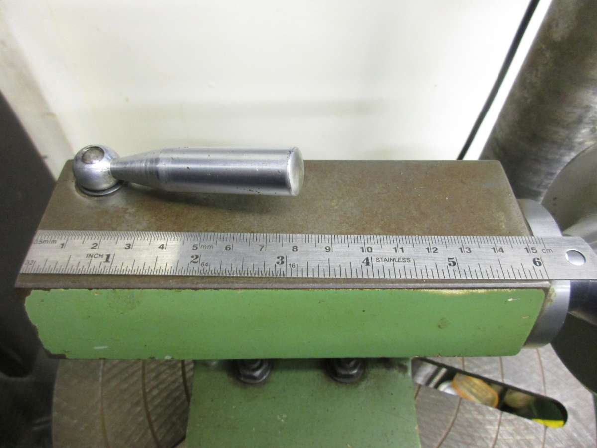

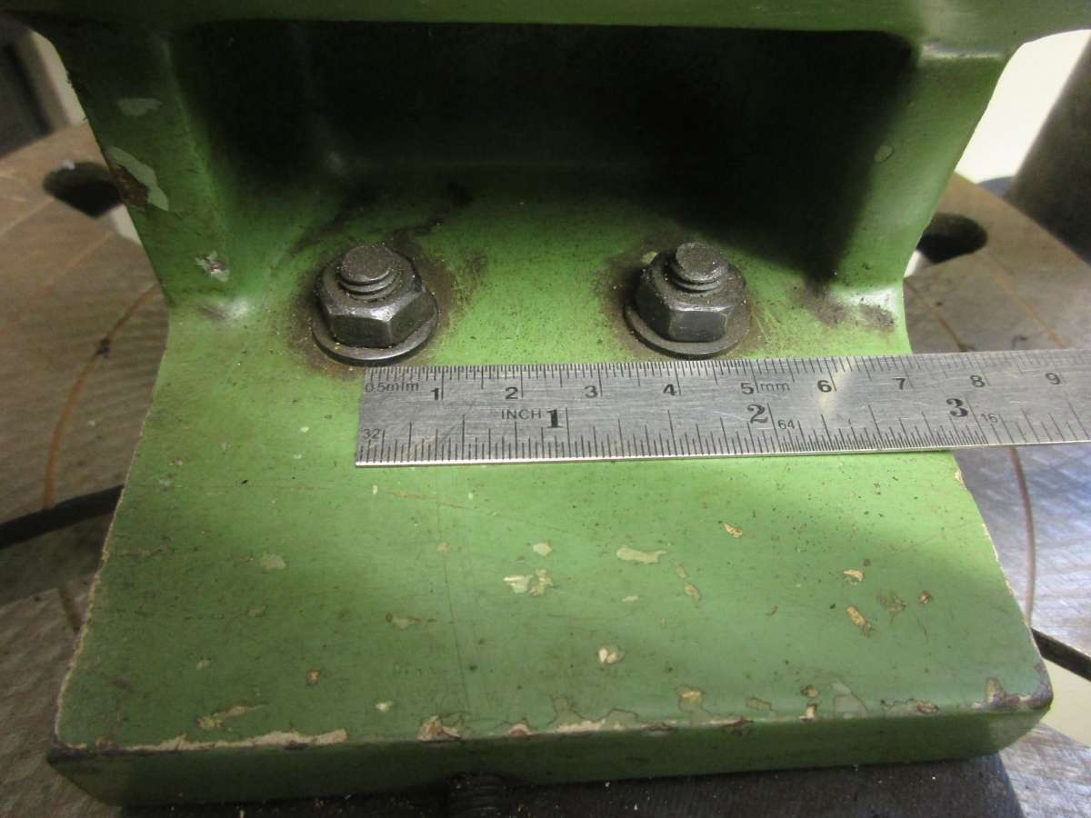

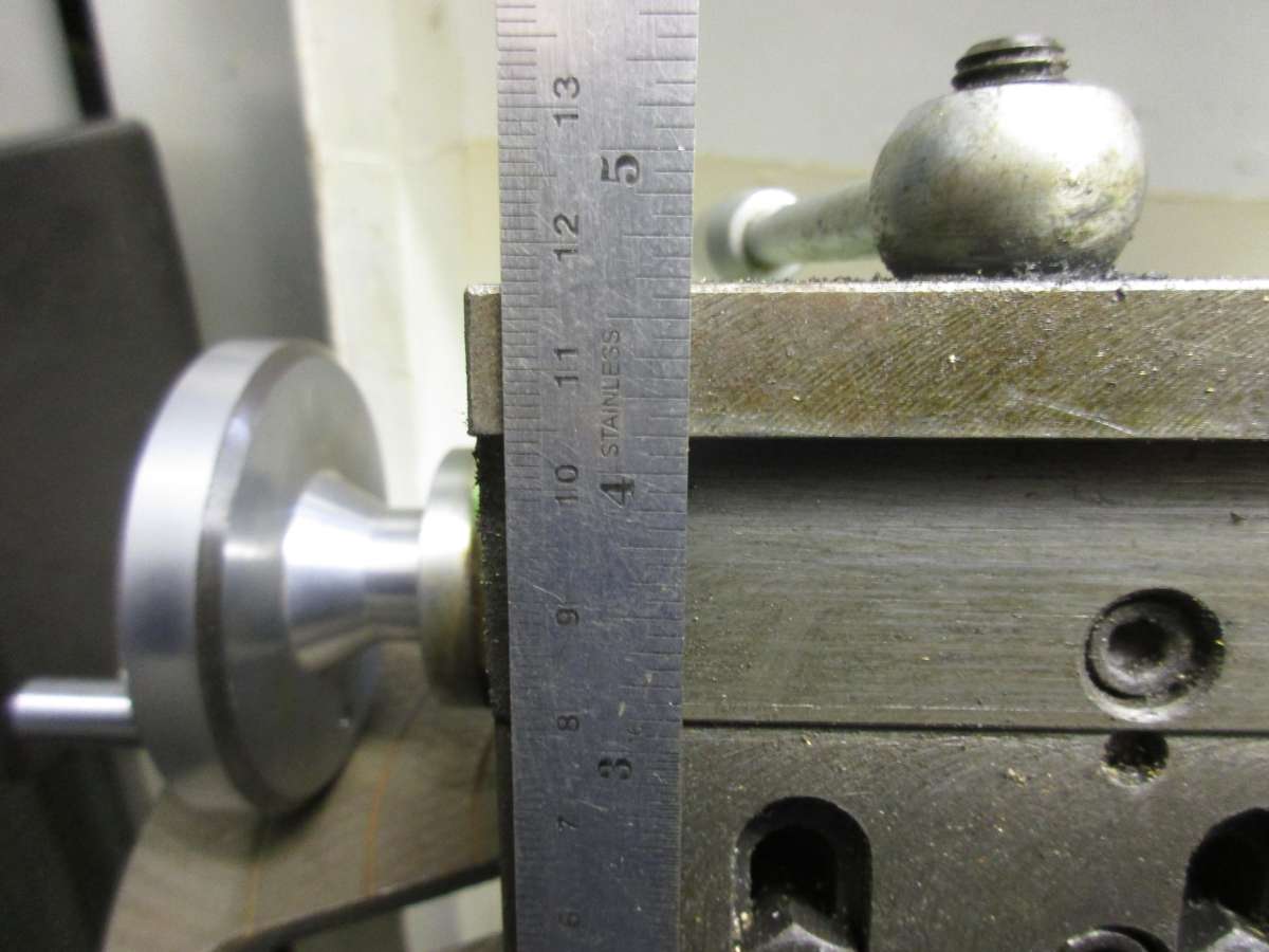

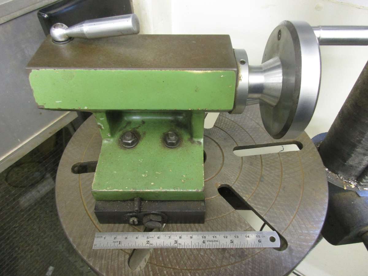

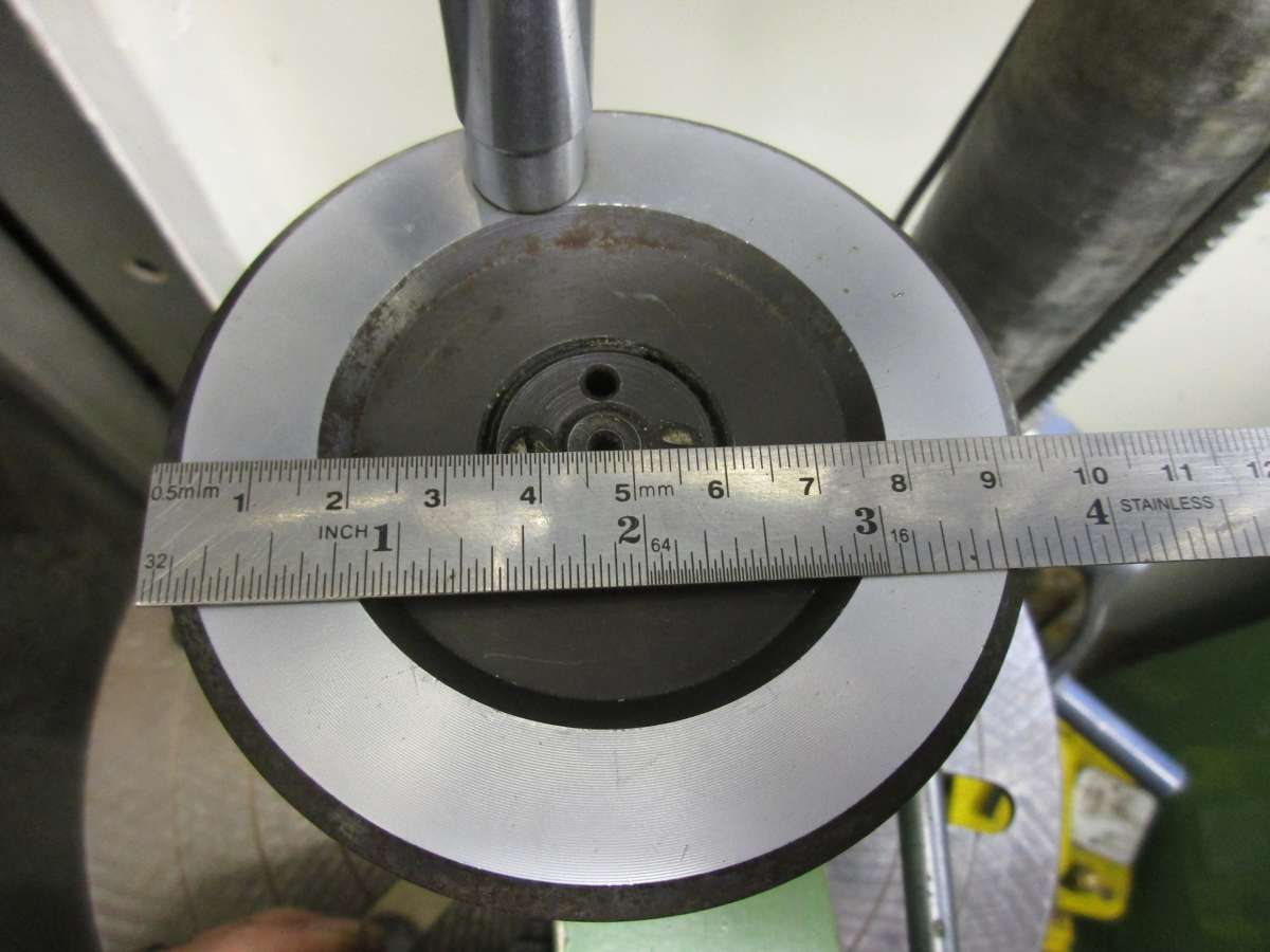

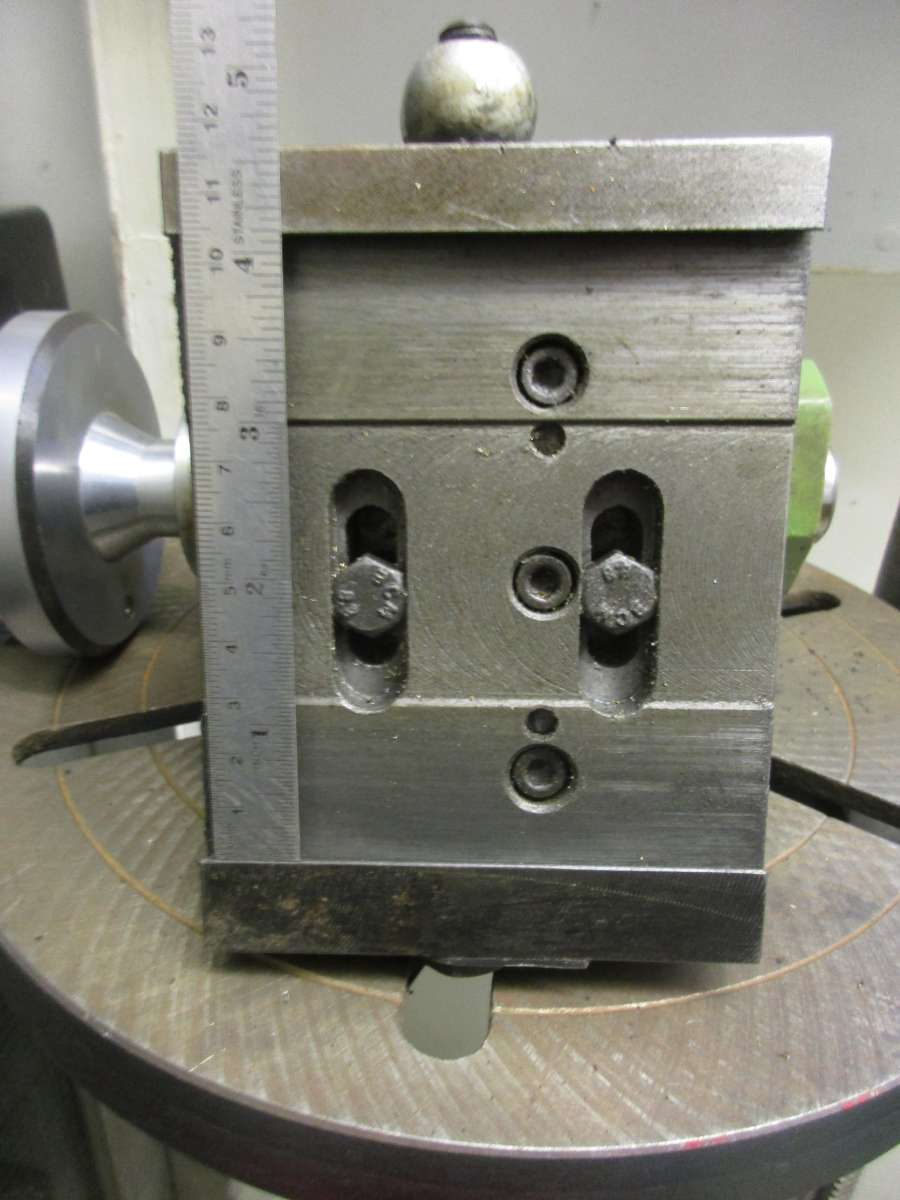

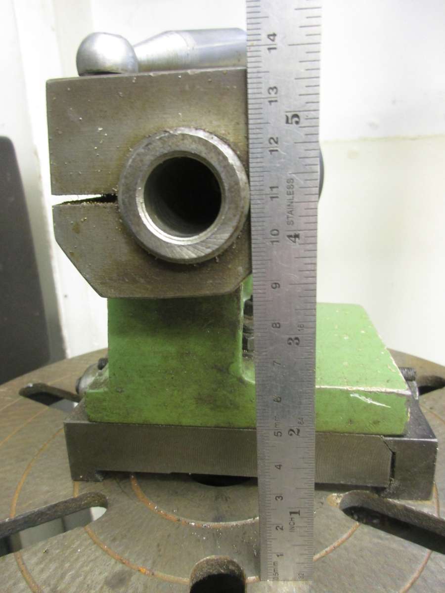

                                            Hi, a few photos of the 220 Tailstock, which might be helpful.
                                            001a
                                            002a
                                            003a
                                            004a
                                            005a
                                            006 - Copy
                                            007a
                                            008a
                                            009 - Copy
                                            010a
                                            011a
                                            Regards Nick.
                                            #715555
                                            peak4
                                              @peak4
                                              Since the bed design is flat with dovetails front and back, and centre height is 110mm, then maybe the easiest way to proceed would be to obtain a different tailstock and modify it.
                                              As an example, a Myford tailstock is designed for a lathe with a centre height of about 86mm.
                                              Therefore mounting it on a flat metal plate about 24mm thick would raise it to the correct height.
                                              The dovetail can easily be bolted to the underside of the plate at the back, and a method similar to the original used at the front.
                                              Myford tailstocks do command a high price, but I’m sure something similar, from a different lathe, would be available in Daniele’s home country
                                              Bill
