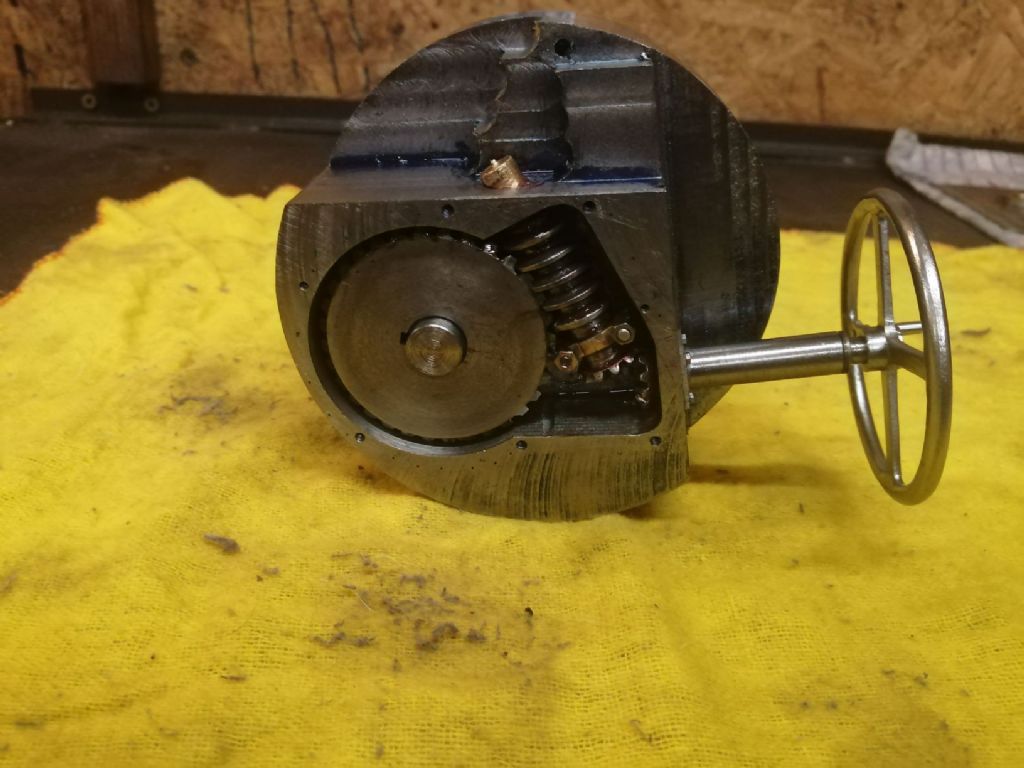

      #486098
      mal webber
        @malwebber91786

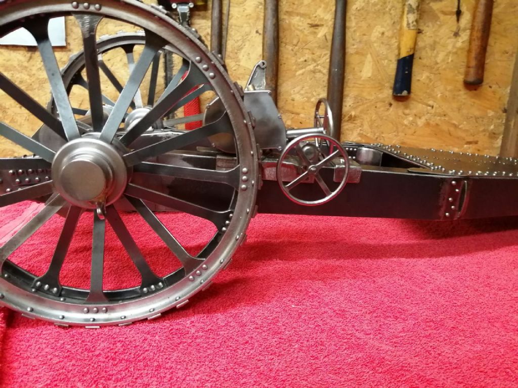

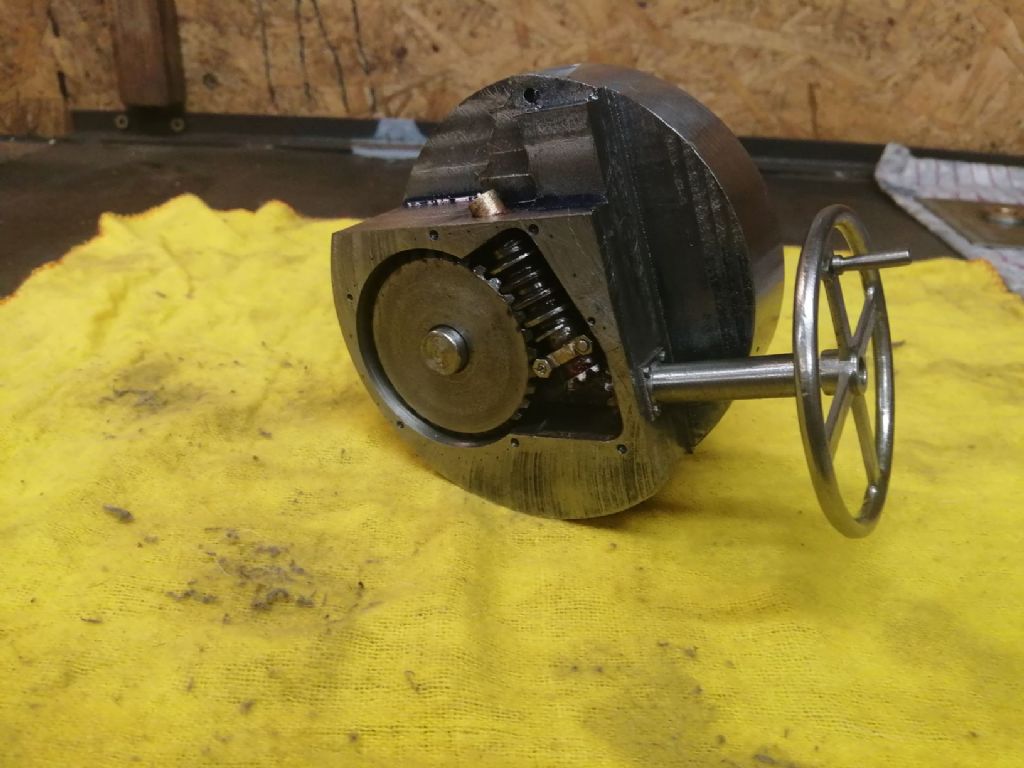

        Well got some shed time in the last week or so and now I have a functioning elevating gearbox ,loads more to be done to make look something like the Howitzer gearbox but getting there.

          #486128
          mal webber
            @malwebber91786
            Thanks Adrian, did try and post a small video of it worked out but could not manage it somehow.
            Mal.

              #486160
              mal webber
                @malwebber91786
                Thanks Dom , short vid how the box turns 32/1 ratio quite happy with so far
                VID 20200716 181948 Howitzer gear box try

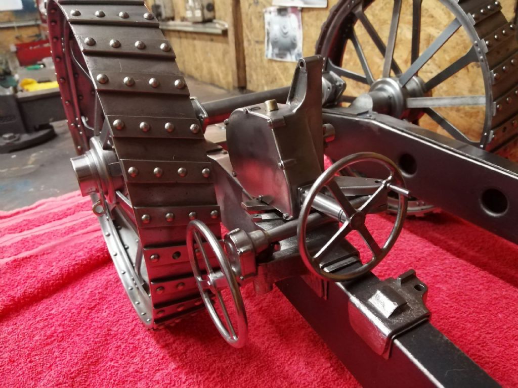

                #489769
                mal webber
                  @malwebber91786

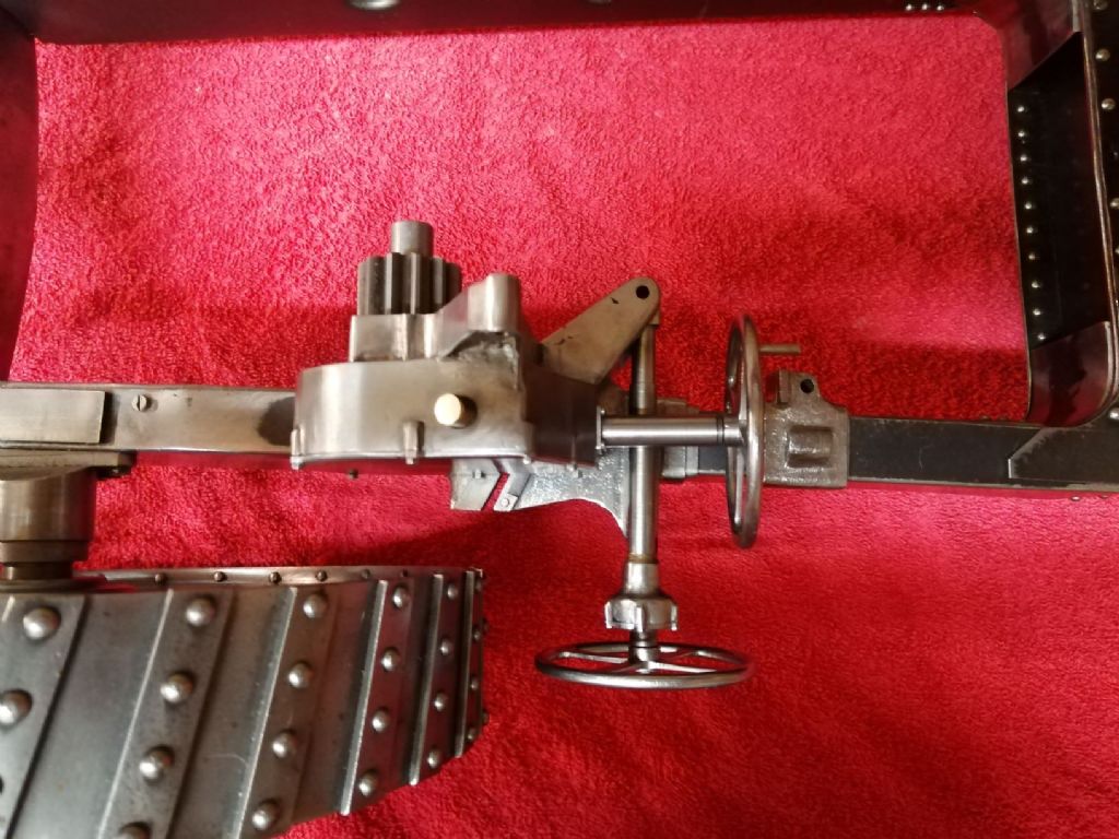

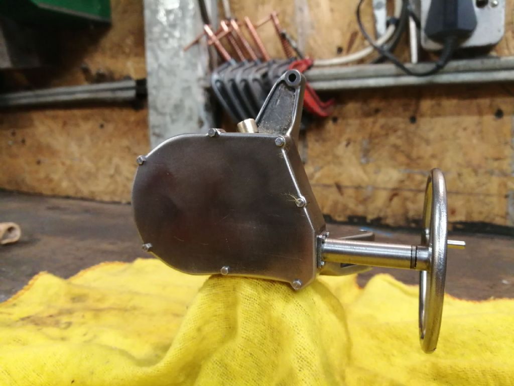

                  Well managed to get that lump of bar stock to look something like the Howitzer elevating gear box, loads of filing and fettling and now I think it looks about right for an early version design, as I found out on the internet through pictures there are a few with slight differences ,couple of pictures below on how it turned out and how it will look on the trail.
                  Thanks Mal.img_20200808_233347.jpgimg_20200809_001147.jpgimg_20200809_001208.jpgimg_20200809_001251.jpgimg_20200809_001300.jpg

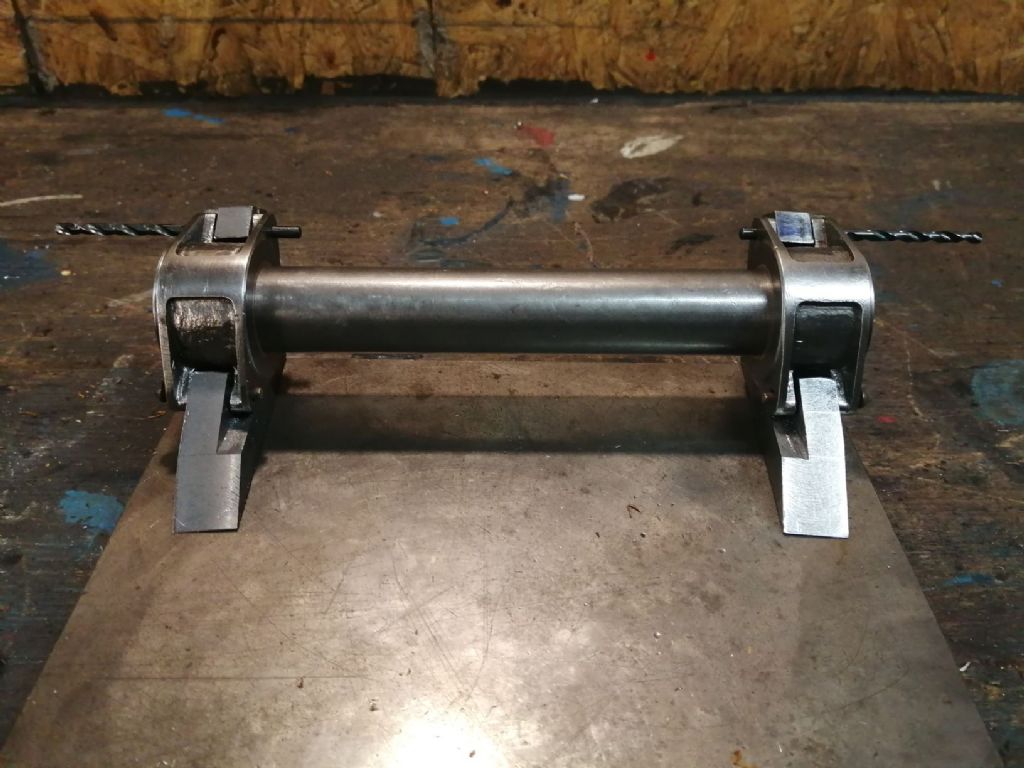

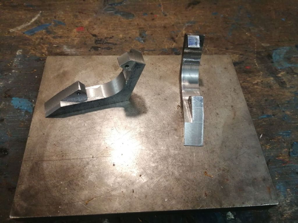

                              mal webber
                                @malwebber91786

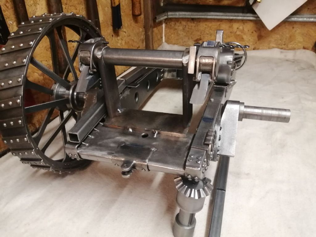

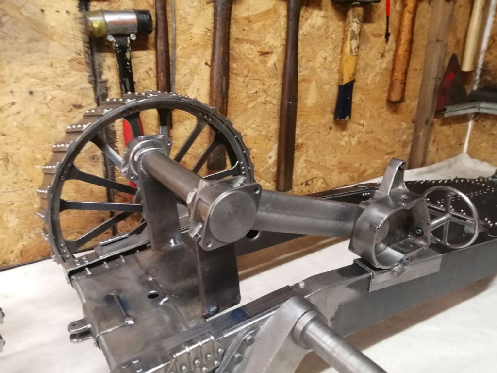

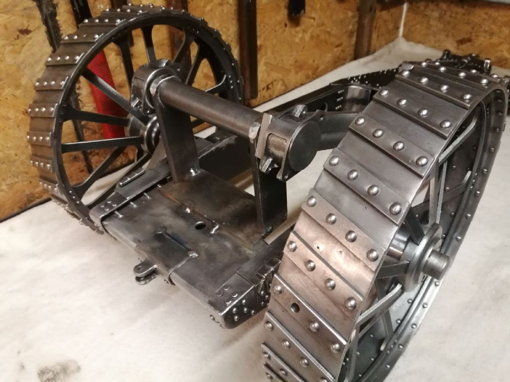

                                Hello all small update on the Howitzer build , now that I have finished the elevating gearbox I thought the barrel carriage would be next so the fixtures to the trail can be riveted in place ,decided to make a jig to suspend the top bearing were they need to be and the distance to the gearbox for the elevating cog ,going to make the carriage around these parts with 16mm box then form plate over and rivet on, made the bearing carriers last couple of days which toe in about 6 degrees against horizontal bar they still need a bit of fettling with to finish them off, couple of pics below on how things are looking.
                                Thanks Mal.
                                img_20201002_213209.jpgimg_20201002_213242.jpgimg_20201002_215650.jpgimg_20201002_215929.jpgimg_20201002_220308.jpg

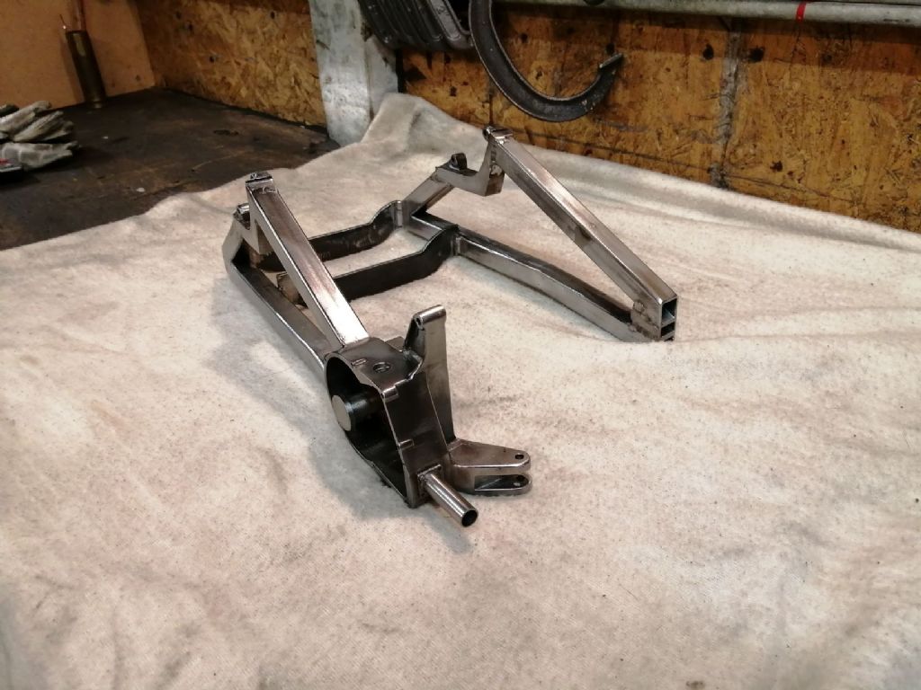

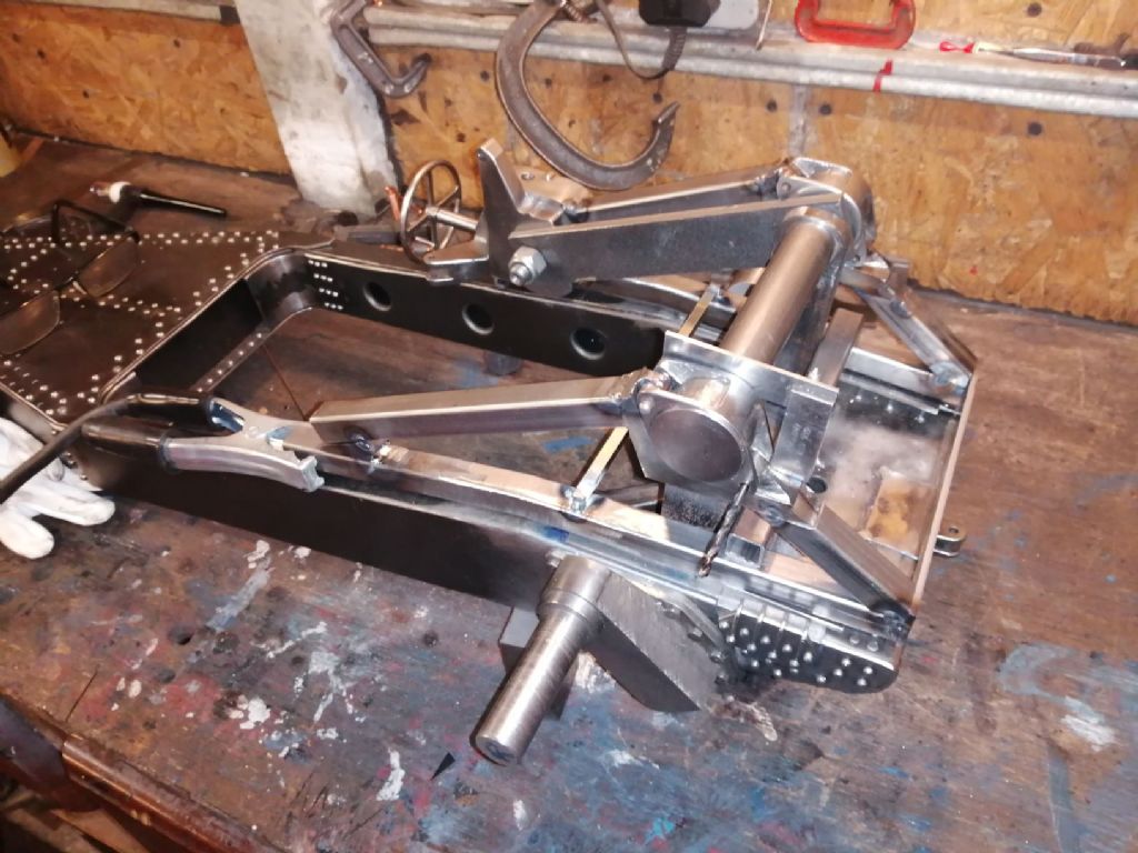

                                            mal webber
                                              @malwebber91786

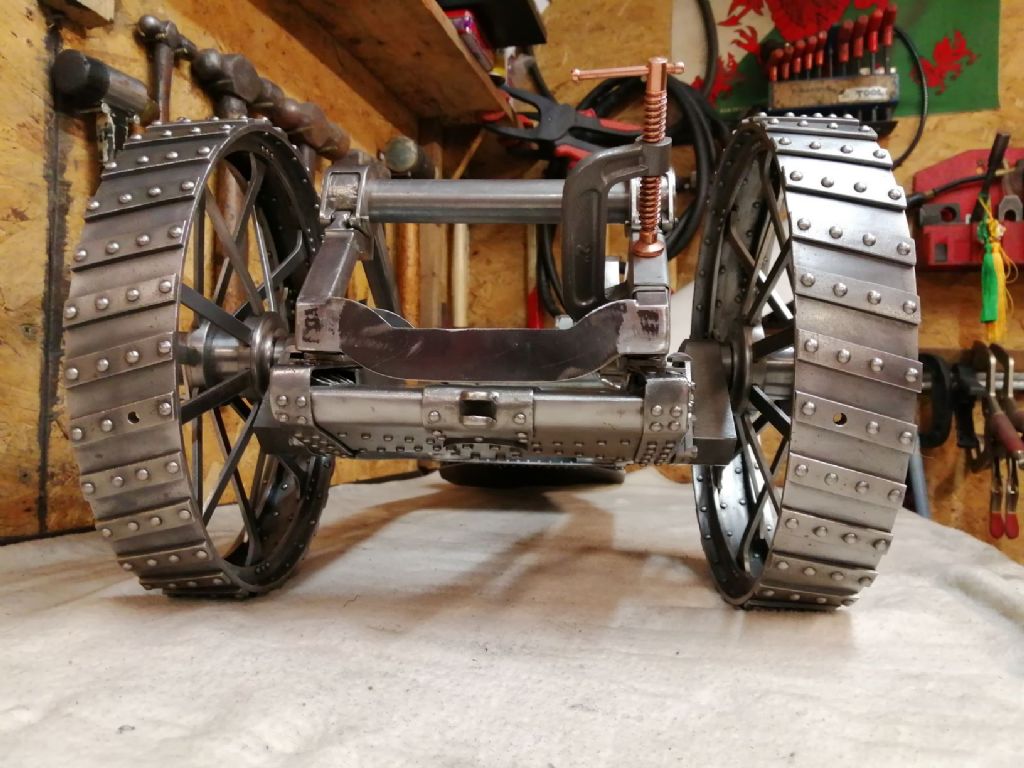

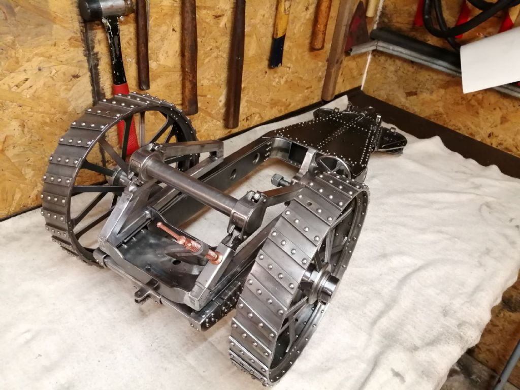

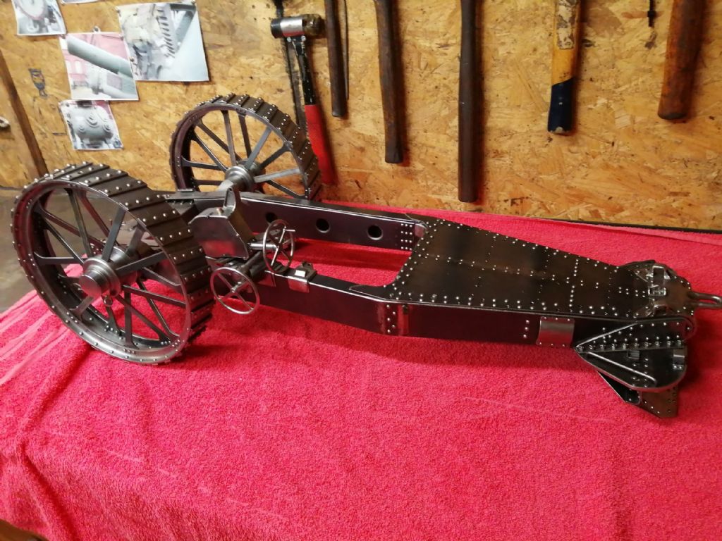

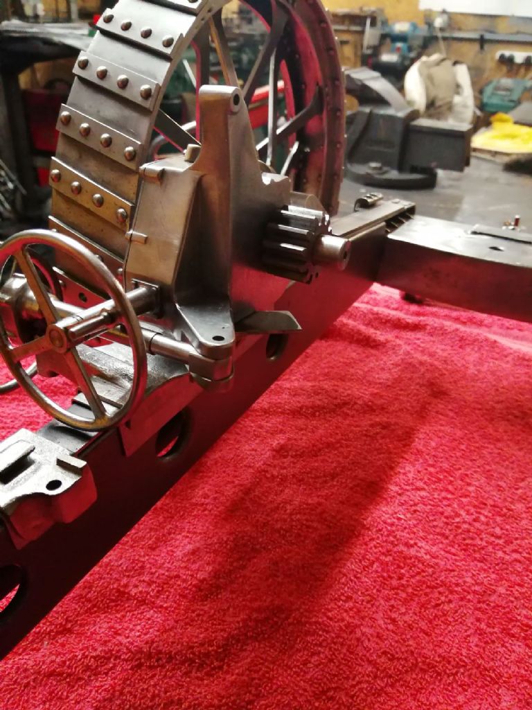

                                              Hello all ,small update on the Howitzer build, I have been busy making the carriage frame which supports the barrel on the cannon , this has been made out of 16mm box section cut into various shapes and welded together [fighting the dam heat distortion ]. Next on frame will be to plate over with some sheet steel an rivet on but first I'll try and finish some fixtures on the trail, couple of pictures below on how it's looking.
                                              Thanks Mal.img_20201022_194858.jpgimg_20201025_163503.jpgimg_20201025_165230.jpgimg_20201025_170603.jpgimg_20201025_170427.jpg
