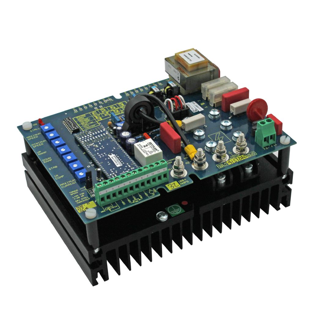

        Please show the manufacturer and model number of this pic – I don’t think it is the unit under consideration at all.
        I realise that the picture isn't the largest, but even with my less-than-perfect eysight I can read "XSY-AT1" on the rating plate. It appears to be a product of the Xin Shuang Yuan Co.Ltd (also on the rating plate) who appear not to have an easily findable website.
        Maybe my version of Google is different to yours (not being funny here – I get different results from my home computer & work computer for the same search term), but searching for XSY- AT1 only gets me these units. There are also AT3 (380V 3 phase input) & AT4 (220V input 380V output) devices. Looking around I can see that there are some Chinese vfds with more exposed terminals, but non of these have been marked XSY-AT1. It would be helpful to have a link to the units you have seen.

            The first hit on epay showed a smaller unit clearly (or unclearly) with a flip-up cover.
            But still with a cover. Covers do not appear to be compulsory :
            Currently available UK manufactured chassis mount DC drive. Bit easier to access the mains terminals than on a compact VFD with a flip-up cover, but still available for sale.
              Nigel B.
              That is clearly a "component" meant to be incoroporated into a final "product" by a competent entity that ensures it's safeand compliant. Most VFDs fall in the same category it's just not so obvious from looking at them that you need to put them in a box with an isolator, fuse, filter etc.
                Which is the point I was labouring to try & make, Robert.
                In some ways, the type of terminal cover NDIY prefers seems to me to be less safe overall, as it leads untrained users to make the wrong decisions about mounting these (at best) IP20 components – screwing them to walls behind the machine being the all too regular dubious choice. More visible terminals might make some reconsider this approach, though I accept that some might just go ahead anyway regardless of the consequences.
                Nigel B.
