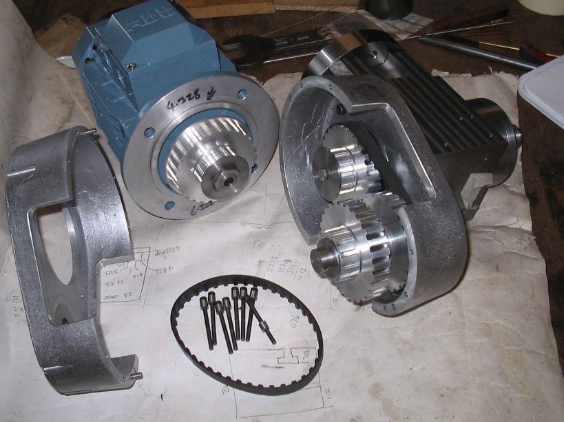

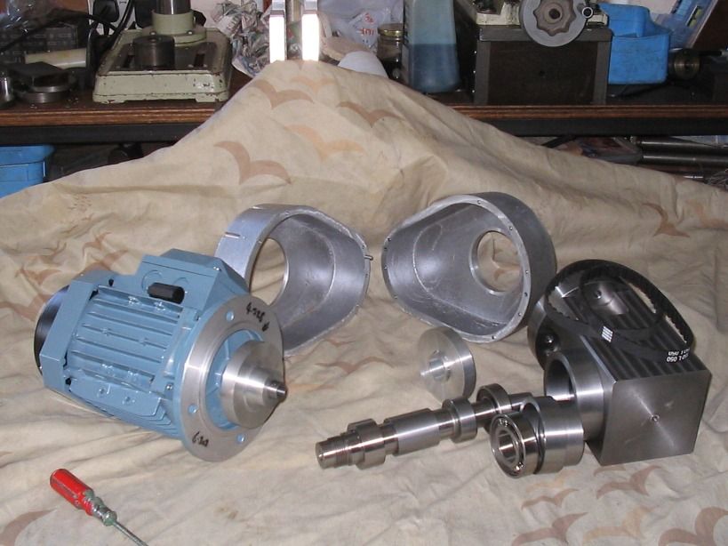

                        Seeing the Harrison that is described in "lathes UK" the vertical heads
                        don't seem have a specification that would be of much use these days.
                        It would be a simple job to make a bolt on head similar to
                        this seen here that i made for my Dore Westbury cnc conversion.
                        Entirely fabricated from steel and cast iron and 2 simple castings,the 4 main
                        parts are the mounting plate in steel bolted on to the the main body of
                        cast iron , the quill assembly is eventually loctited into the main body
                        The 3 bearing spindle has the taper for the er collet bored in directly
                        and uses a Myford 7 nose thread so all Myford accessories fit.
                        The aluminium castings made from 1 pattern hold the motor on top
                        and through 8 toothed belt pulleys and the inverter the head has a speed
                        range from 100 rpm to 10,000 rpm . I don't have any drawings, something like this
                        you can draw up on the back of an envelope ,i did ,its just a matter of working
                        out what you need.
                        There may be a more recent published design for a bolt on vertical milling head in
                        MEW but i cant find it ,there was one published in MEW 34 for a Tom senior
                        that used parts of a Dore Westbury milling machine .

                                  Posted by John P on 12/09/2022 19:21:05:
                                  out what you need.
                                  I agree that the Harrison's 1:1 ratio and 22-1000 or 63-1500 speed range isn't particularly well suited to vertical milling with modern cutters, when a 10mm carbide endmill will happily run at 4000 rpm in EN1/EN3 and 2000rpm in 709M40T, which is a big part of why building rather than buying makes sense…
                                  "Why pay over the odds for an attachment which would ultimately be unsuitable for a good proportion of my existing tooling anyway?"
                                  The assembly you're showing for the spindle of your vertical head mirrors the way I planned to assemble the spindle if I make one myself.
                                  However as with my comments to Clive there's a consideration as to how hard translating horizontal to vertical rotation would be and how that compares to the inconvenience of storing/lifting a much heavier assembly with a motor mounted on it; the approach you've taken is definitely simpler to execute from a manufacturing perspective than having mitre gears and a power-take off from the main spindle.
