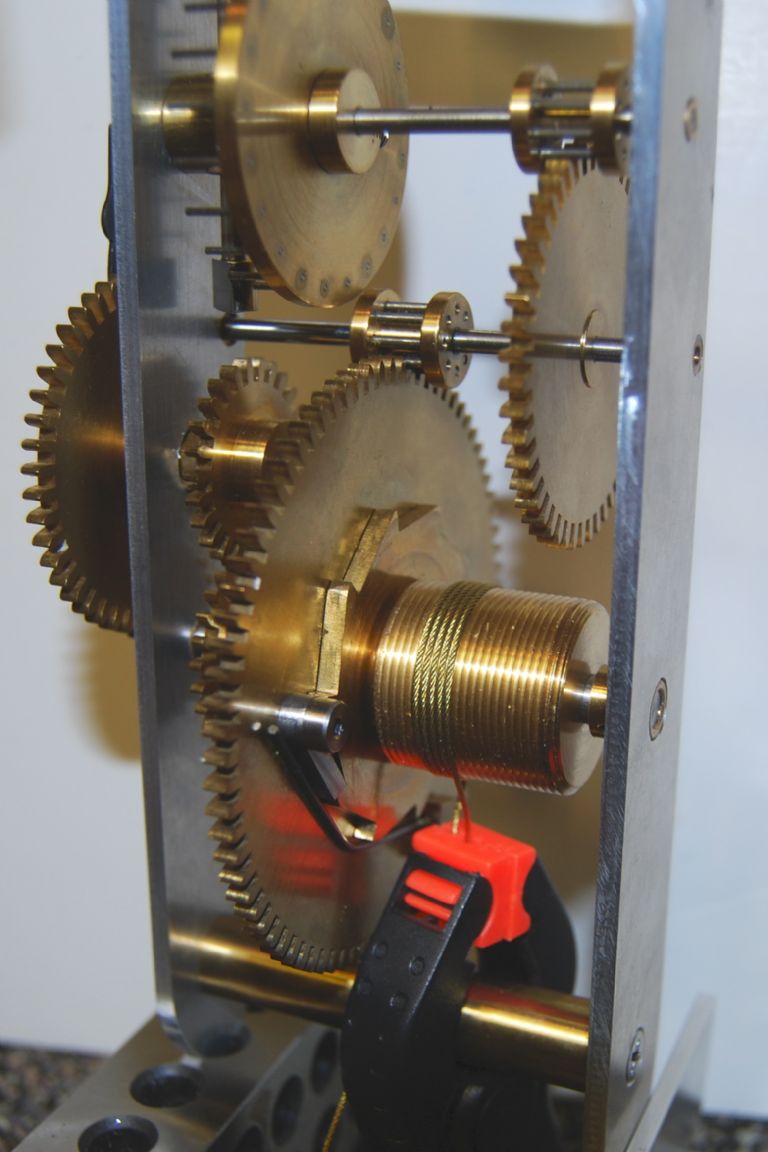

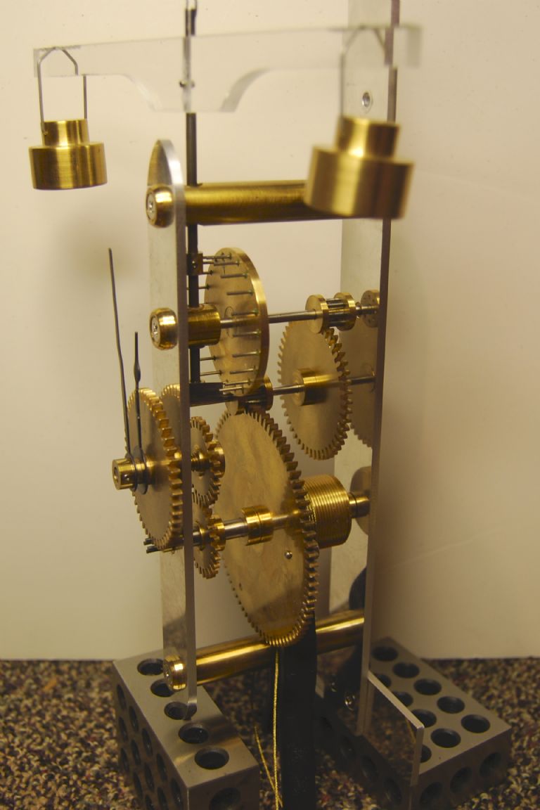

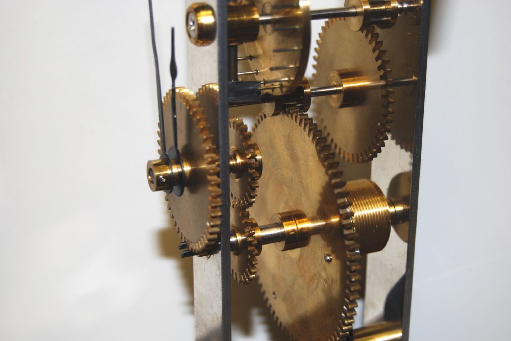

            Hello,
            I purchased Conover’s book some years
            ago and made my own adaptation of his design: added a minute hand, used a cycloidal
            gear cutter instead of home made triangular tooth cutter, made a
            windlass for braided brass weight cord, and other practical and
            aesthetic changes.
            I’ve created an album here and posted some photos.
            I can recommend the book as a good introduction to the design.  I’m not myself interested in making an exact copy of anything, preferring to pursue my own ideas.
            You don’t say where you are located.  I’ve visited many clock museums in Europe, and can also suggest the museum and library of the NAWCC in Pennsylvania.   see:

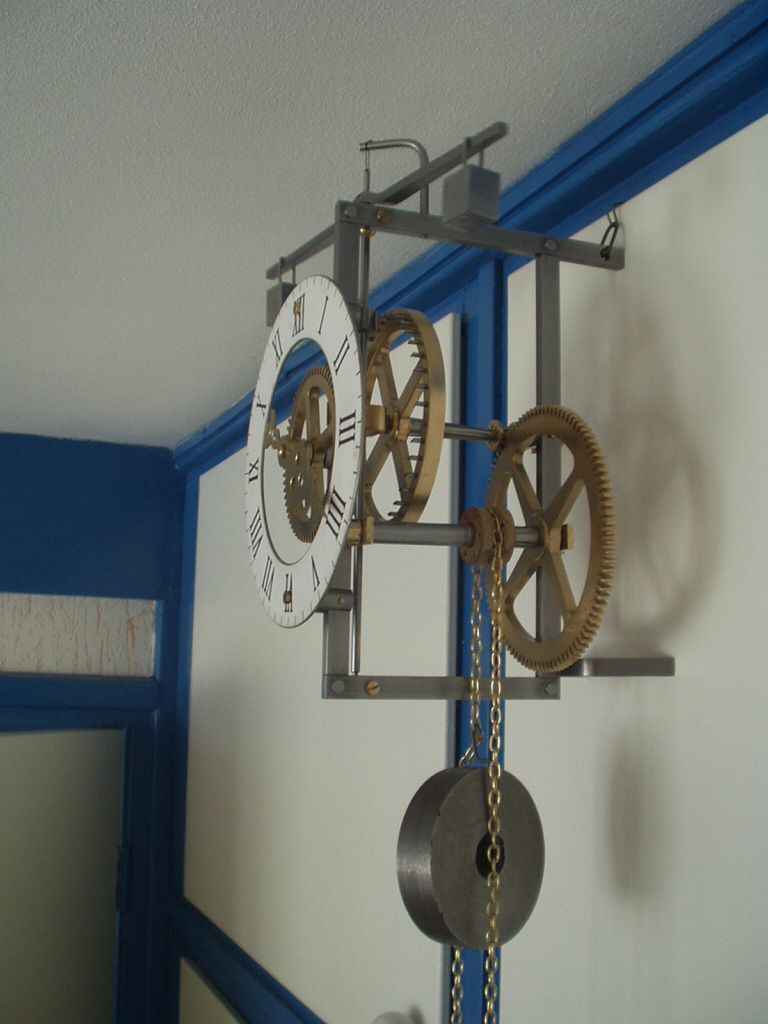

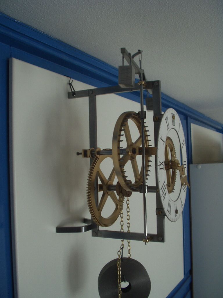

                Dear friends,
                After having build a few simple steam engines and some tooling, I am currently building my first clock.
                It is a very simple foliot clock based on this design:
                Although the winding mechanism is still to be made, the clock runs since last night with a temporary weight. See the attached pictures.
                Best regards from The Netherlands,
                Gep

                  Hi Gep,
                  Your clock looks great and would seem to be a fairly simple project for a first attempt at clock making. I had a quick look at the website that you listed but unfortunately my Dutch is not  quite good enough to enable me to translate the notes included on the plan! Do you know if the plans are available in English?
                  Regards, Martin.

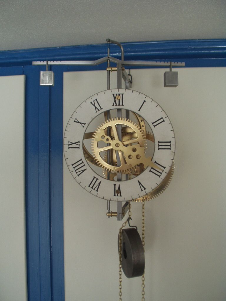

                    #42478
                    Gep Engler
                      @gepengler40547
                      Hi David,
                      I had a full size picture of a dial (can send you a JPG if you wish).
                      Made a photocopy; glued this on 1 mm iron sheet with “Bison Tix” (a thixotropic contact adhesive).
                      Spayed this a few times with clear acryl varnish.
                      Cut the outside with my bench shear (I was to lazy for the piercing saw!).
                      Drilled both the 3 mm mounting holes (through the numbers XII and the VI).
                      Marked the centre of the dial with a centre punch.
                      I made a “backplate” from MDF and mounted the scale with 2 small screws that fitted tightly in the mounting holes of the dial..
                      With the backplate in the 4 jaw chuck, I centred the dial.
                      Turned the outside to shape.
                      Removed the dial from the backplate (but left the backplate in the chuck).
                      Cut the large inside hole with a piercing saw.
                      Mounted the dial again on the backplate and turned the inside.
                      Smoothed outside and inside with fine sandpaper.
                      Finally I applied a few more layers of varnish.
                      Dial ready.
                      Gep

                        #42481
                        Gep Engler
                          @gepengler40547
                          Hi Martin,
                          Sorry for you: you will have to learn the simplest language on earth (at least for me): Dutch! May be, you have any native speaking Dutch around that might assist you?
                          I do not expect that there will be an English translation available. But, as you can see on the low-resolution drawing, the description is very limited. And there is at least one significant failure in the drawings I have.
                          As I never made a clock before, there were several details and skills I had to “invent” myself. For instance: the most extensive description is for the 96 tooth wheel, and it only reads:
                          “Gearwheel 96T of brass. Copy shape of teeth from drawing. Cut-in with normal saw and shape wit small file. Teeth do not need to be exactly identical. Space between teeth somewhat wider than with of tooth.”
                          And the drawing of this item bears a note: “Glue on and saw”
                          I did not expect that it would make great fun to make the gearwheel (5 mm thick brass, 96 teeth) in this way.
                          So I did it  the vertical milling machine with a 1,5 mm slitting saw: one run with the slitting saw 5mm above centre and another run 5 mm below centre. And finally some filing.
                          I used my rotary table. But before starting gear cutting, I decided to first make a dividing set (dividing plate and arms)…….
                          I think, it is indeed the simplest possible clock, so ideal for a beginner.
                          Last update:
                          The chain runs via pulleys now and I hope to start making the winding mechanism this evening. I will leave making the weights until the end.
                          Good luck!

                                  #44599
                                  Gep Engler
                                    @gepengler40547
                                    Posted by Martin Cottrell on 23/07/2009 21:18:06:
                                    Hi Gep
                                    Thanks for the information. Unfortunately I have no Dutch speaking friends but Keithmart has suggested that I try to find a translation service via Google. It can do no harm to try that…who knows, if the translation is not as good as it should be I might end up making a windmill instead of a clock!!
                                    Keep posting the pictures of your clock as you progress with it. Is there any chance of putting a video of it running onto Youtube so we can see it working?
                                    Regards, Martin.
                                     Hi Martin,
                                    Sorry for the late response. This summer, I had a breakdown of my computer.
                                    I bought a new one and was condemned to Windows Vista.
                                    So it took sume time until (most of) my software was running again.
                                    In the meantime, my foliot clock is fully functional.
                                    Today, I edited and uploaded a short videoclip of this clock.
                                    Furthermore, I did some research on the WEB and found that the drawings I used, may be based on one of the following books in English language:
                                    and
                                    Keep us informed when you indeed build one yourself!
                                    Good luck and best regards,
                                    Gep
