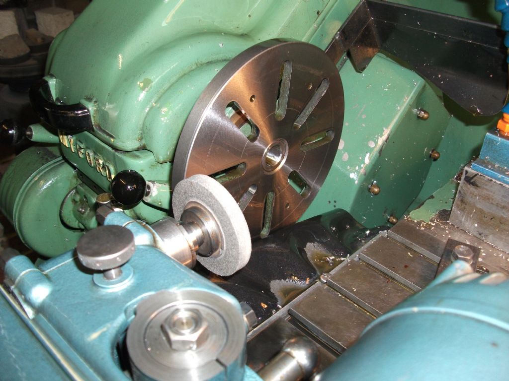

      Sometimes it would be nice to be able grind items that are too tough for normal lathe tools.
      Anyone done this and care to share some idea/pictures?

                Lots use a die-grinder, attached to the cross slide.  No real problem as long as machinery is adequately protected from abrasive dust.

                  Whatever you use to cut the hard steel will give a very shiny finish is what I have found..
                  If you do a grinding set up protect your lathe bed by laying a cloth or paper.
                  Thoroughy clean after.
                    I have a die grinder and may make a tool post for it, interesting project to keep me busy
                    Good advice re covering things up.

                      I use my Quorn grinding head sometimes in the lathe ,flooded
                      with neat cutting oil keeps the grinding wheel clean no special
                      covering on the machine as the grindings fall away in the coolant
                      stream onto the normal swarf protection and are then just
                        But preferably not cloth – which, if caght up by whatever is rotating in the lathe, can be dangerous.

                          Before using a die grinder check the play in the bearings. They are not intended for precision work so may flop around rather more than the depth of cut you are trying to achieve. Also you might want to look at the lathe bearings and slide movement or it rather defeats the object of the exercise. Doesn't necessarily apply if your only aim is to cut tough materials rather than achivee the precision and finish of normal grinding intentions.
