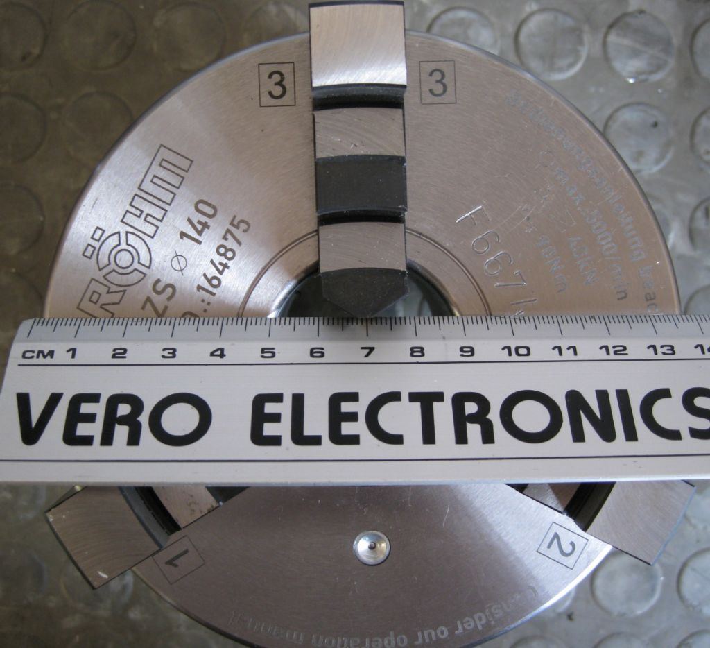

                                                Tricky:
                                                The 14D chuck size is not a maximum of 5-1/2 inch at all – the standard chuck you can opt to take with the machine is 5-1/2 inch, but thats your choice – It is not a cheesy chuck though – steel body and can run at 5000RPM – since the 14D can run at 4000RPM, thats a good thing.
                                                However, the choice of optional EMCO approved chucks given me and which I finally purchased are these:

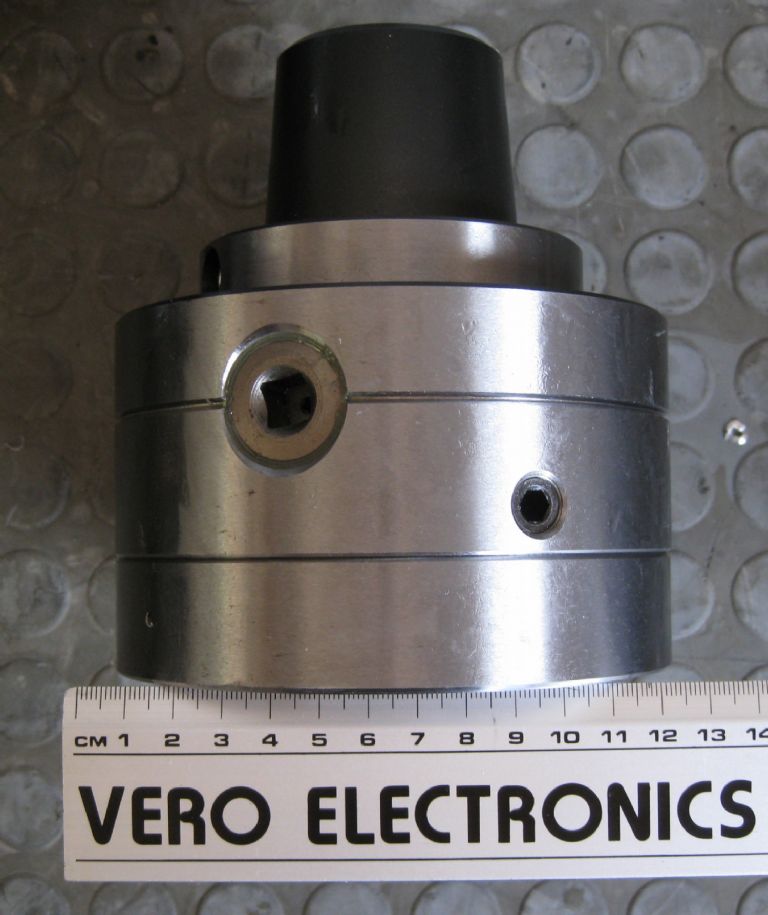

                                                A bison Steel SET-TRUE style 5C capable of 5800RPM
                                                A ROHM 140mm steel 3jaw – 5000RPM

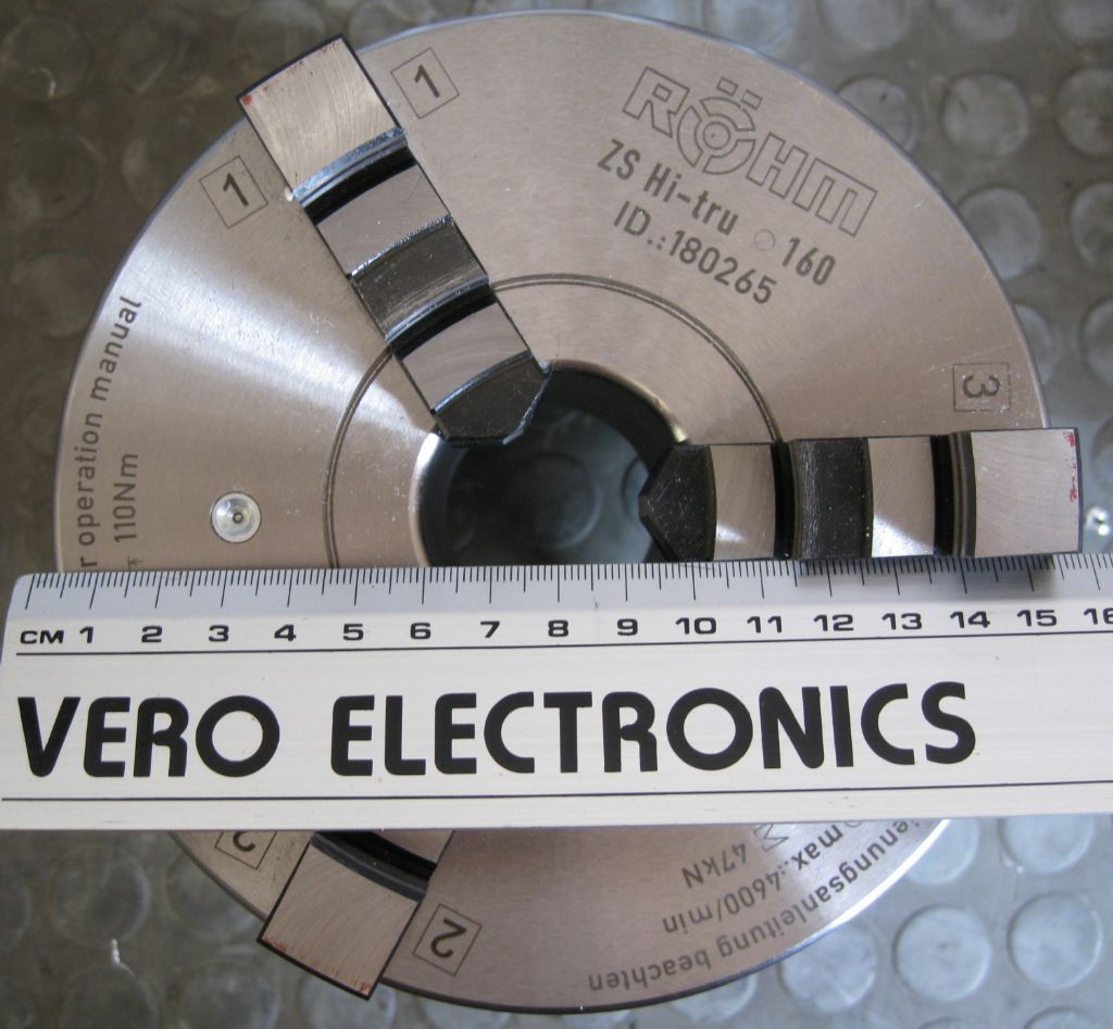

                                                A ROHM 160mm Steel Set-True 3 jaw – 4600RPM

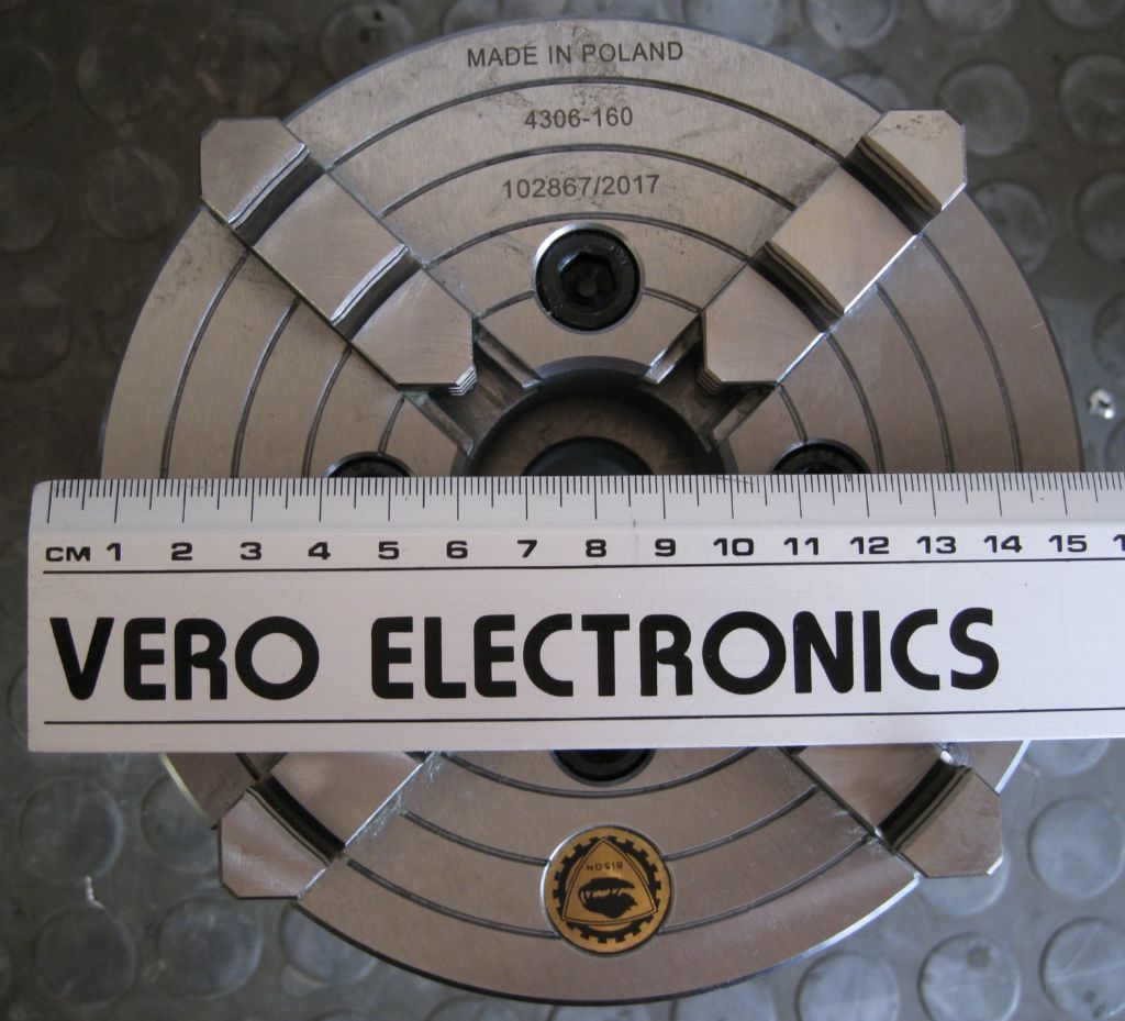

                                                Bison 160mm Steel 4 jaw 2500RPM

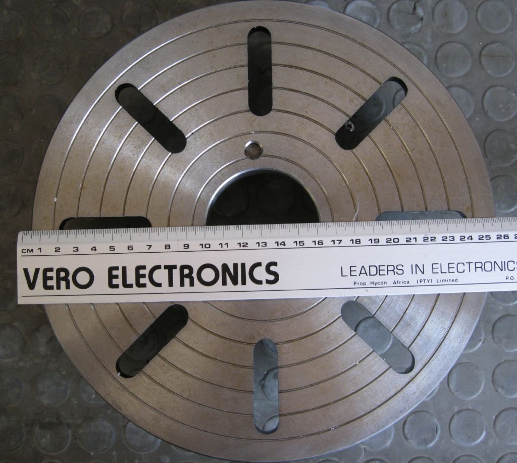

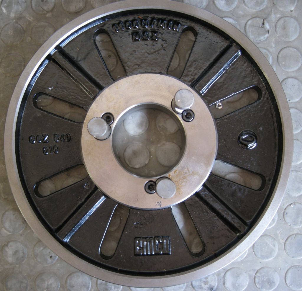

                                                And the Faceplate, or Mounting plate – 254mm, cast.
                                                These chucks are comparable to or even bigger than the chucks supplied with, or even as options on the C4, the Warco WM280 and even the Warco WM290, which has great center height and between centres than the 14D.
                                                The faceplate you mention of 'only' 5-1/2 inch is the precision faceplate – a cross between a 4 jaw chuck and a versatile backplate – all steel..and can run at 3000RPM.

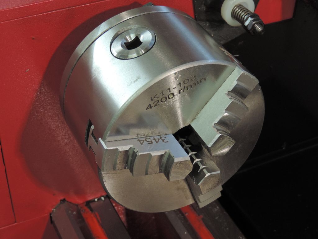

                                                  5 1/2" doesn't sound like a small chuck to me. Most model engineers get by with a 4".
                                                  Just for the record, and bearing in mind the original question, this is the one on the SC4:

                                                    I think it is just the wording on Emco's site that may put people off when they see the small sizes listed as you could easily think it won't swing larger.
                                                    100mm 3-jaw is about right on a 200mm swing machine coupled with a 150-160 lightweight 4-jaw and is what I used to run on my Emcomat 8.6. Now I have the larger WM280 which is the same size as Joseph's I have 125mm 3-jaw and 5C, a lightweight/slim 160 4-jaw and 254mm faceplate.
                                                    The one reason you may want to go up a chuck size is to make the most of a big bore spindle as the larger chuck will also have a larger through hole.
                                                    J
                                                    PS you would have thought they would throw in a fixed steady at that pricedevil
                                                    Edited By JasonB on 16/11/2018 14:07:18

                                                      Jason:
                                                      I don't think EMCO throws anything in for nothing…!
                                                      No steady, fixed or travelling, although I did purchase both, if only for completeness. I have both for the Maximat V10, and have only ever used the fixed steady once in nearly 40 years!
                                                      The sizes shown in the 14D brochure are the standard ones supplied with the machine – They will retain those and offset the cost against other approved choices.
                                                      All those chucks were a significant part of the 18K EURO – nearly 7K. So the Lathe price is actually a lot less..devil
                                                      But a very neat gadget I did purchase is the ER collet tailstock turret – I use that so very regularly that I wonder how I did without it before. It does take some care though – not snagging your hand or side of the head on that porcupine to the left of you…
