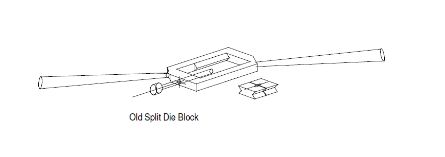

                                                    I have an old "die plate" I suppose it is, Made from hard steel with a forged handle. This has 24 threads, look like Whit. form, the largest is about 5/16 dia. the smallest is broken off but could be 1/16 ". This is just to show the variety of threads in use, in I guess about 1900.So the candlestick could be threaded with the nearest suitable size.

                                                      Merlin,
                                                      Sorry my input is late but I ran a brass shop in the 60s and would confirm that even then the tools and methods were "simplistic", to be kind. Threads were chased in brass wherever possible, one TPI for all, 26 TPI irrespective of size. Many of the tools were home made from hardened carbon steel as this was adequate for brass on slow machines or for hand cutting.
                                                      Short of a deep clean I can't put my hands on the split die block that was used to thread iron tie rods like the ones off the candlesticks, but it was after the style of the sketch below.
                                                      Being split dies it would be an easy matter to take 5/16 whit (18 TPI) and produce home made taps in carbon steel to near 1/4 dia x 18tpi (perfectly capable of tapping into brass) and then using the same dies, a little tighter, to thread the tie rods. Soft iron nuts would be similarly made with a carbon steel tap.
                                                      There was no sophisticated measurement or concern about British standards let alone Metric or American. Parts were required to "fit" and interchangeability was low on the priority list and the candlesticks .bear witness to the fact that they can stand the test of time OK.
                                                      The 50s/60s was an interesting time to enter an Engineering career, fortunate to be trained in modern methods but still able to see the traditional approach in the peripheral industries and then grafting onto that skills from both a toolmaker father and smithy grandfather.
                                                      PS SHMBO is unhappy to think your church brasses only get an annual treatment . There is a weekly rota for polishing in our church! A bit OTT to my mind.
