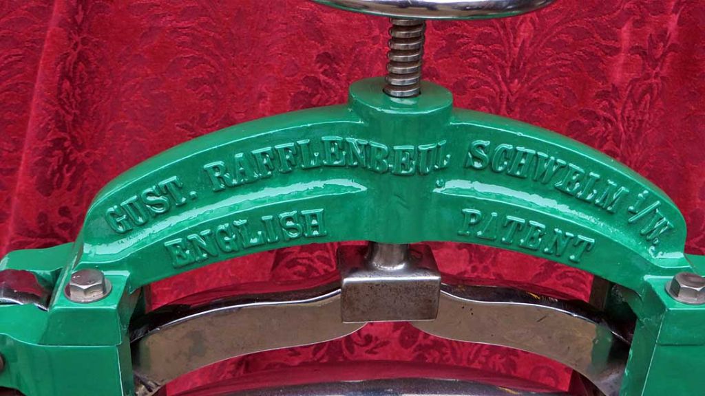

                Auction description
                An antique cobblers leather roller mangle by Gustav Rafflenbeul Schwelm, W 53cm x H 70cm x D 48cm.

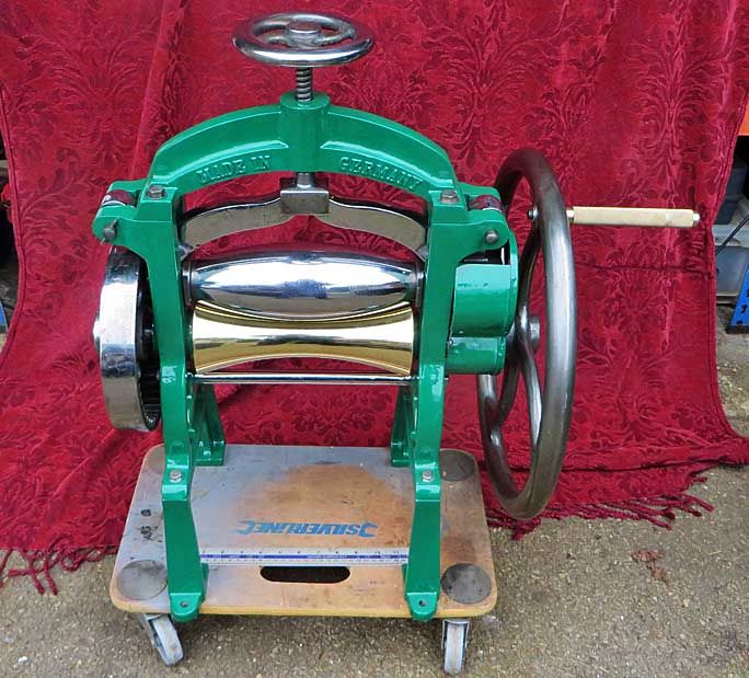

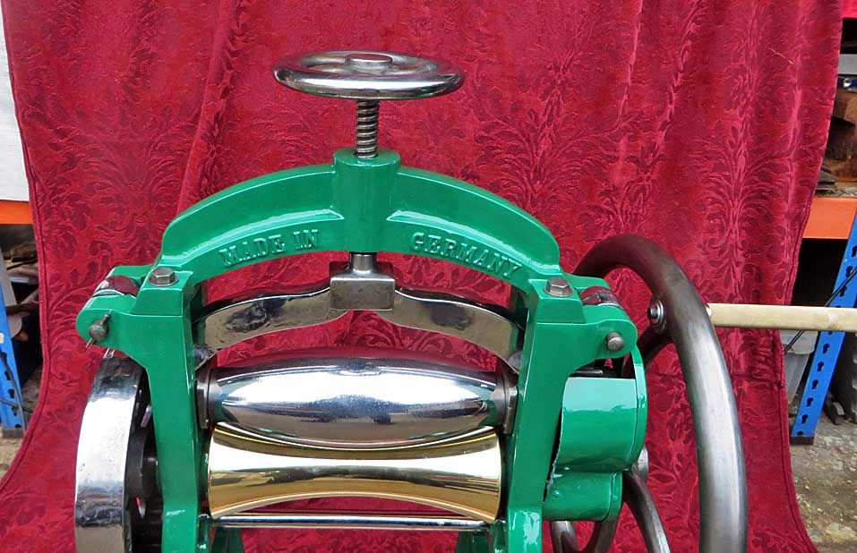

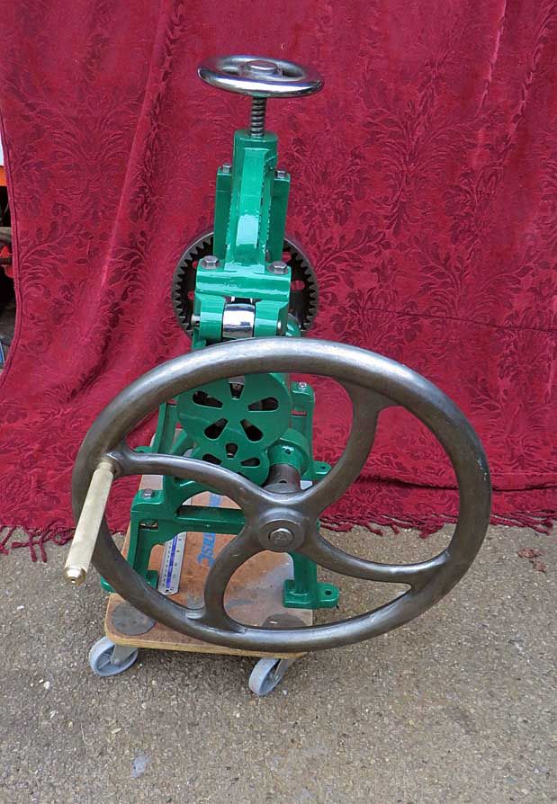

                          Here are some pics of the restored machine, now ready to go.
                          Quite enjoyable to do but the parts were very heavy.

                            Hi Martin, well that's scrubbed up very nicely. yes

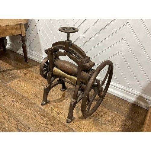

                                    Hi Martin, if you don’t know by now the use of this machine, I could give you a explanation. I just sold a machine like that, different model.

                                      Martin.  A lovely restoration and a nice brass handle, although maybe a little out of character.  Hope I didn’t put you off with my comment about greenheart.

                                          Interesting machine and beautiful restoration but I’d really like to know how the links/bellcranks apply pressure and why gears are needed ?

                                            I had one of these ,but sold it years ago. Never knew its use, but leather roller makes sense. I am pretty sure the rollers were quite heavily textured for grip (?) so I think polishing them was a mistake.

                                              Mmm….  The idea of rolling wet leather and allowing it to set sounds plausible.  But surely, once the leather has been rolled, there is nothing to support the rolled form while it dries?  Also, it would be limited to just one form/radius.  I rather favour the OP’s auction description of a roller used by Cobblers.  It looks a little small for saddlery.  A classic example of vintage engineering, and it looks good too.

                                                This is a machine used by shoemakers. Traditionally the veg tan leather for the insoles(not a slip-in insole, but the actual foundation of the shoe, as the uppers were sewn to this insole) and the outsoles were soaked in water, then wrapped in cloth/paper allowing the moisture to penetrate the leather but absorbing all excess. Once the leather was damp but not soggy, maybe next day, the pieces of leather would be hammered on a stone slab, starting from the centre and working your way to the edges. Hence the wide face of the shoe hammer. This would compress but more importantly pre stretch the fibres. While still damp, the insole would be nailed to the last, a few nails in the middle and nails all around the edge of the last. Now the leather was allowed to dry, the outer ring of nails preventing the insole from shrinking together again. This process was important  to prevent premature stretching out of shape of the shoe once the shoe was worn. The same was done with the outsole, except this time it was sewn to the welt while the leather was still damp. The above leather mangle is doing that job. The bottom concave brass roller turns faster than the convex steel roller at top. There is pressure on the leather and a certain amount of drag, which helps to stretch the leather. A 6 mm outsole has quite a bit of resistance. Yes, the rollers should be smooth.

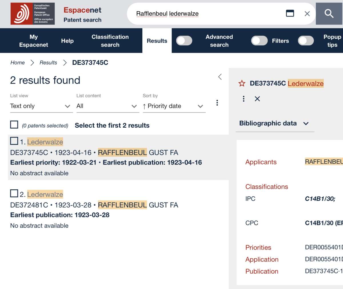

                                                  It will come as no surprise that I have been searching for the Patent
                                                  Sadly, neither of these is English, and nor do they feature the fancy rollers … but they surely get us in the right ball-park.
