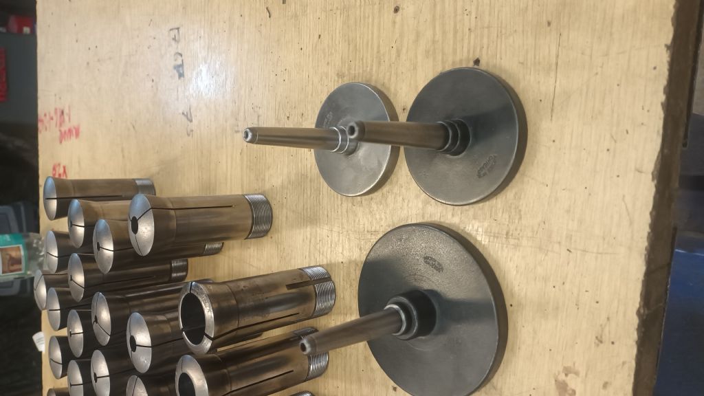

      I bought some Harding 5C collets and these were included. Could someone please let me know what they are?
      Thanks

              Looks like a Morse Taper, if the base has a rounded edge,they could be Metal Spinning formers.

                What does the text  imprint on them say, is it the manufacturer?

                  It's just the manufacturer- harding

                    They are called a 'drill plate'. See near the bottom of this page:
                    http://www.lathes.co.uk/hardinge-hlv-catalog/page2.html

                      Brilliant thank you for this although I'm not sure what it's still actually used for!!

                        I have used one to push a job square in the three jaw chuck, near enough to machine.
