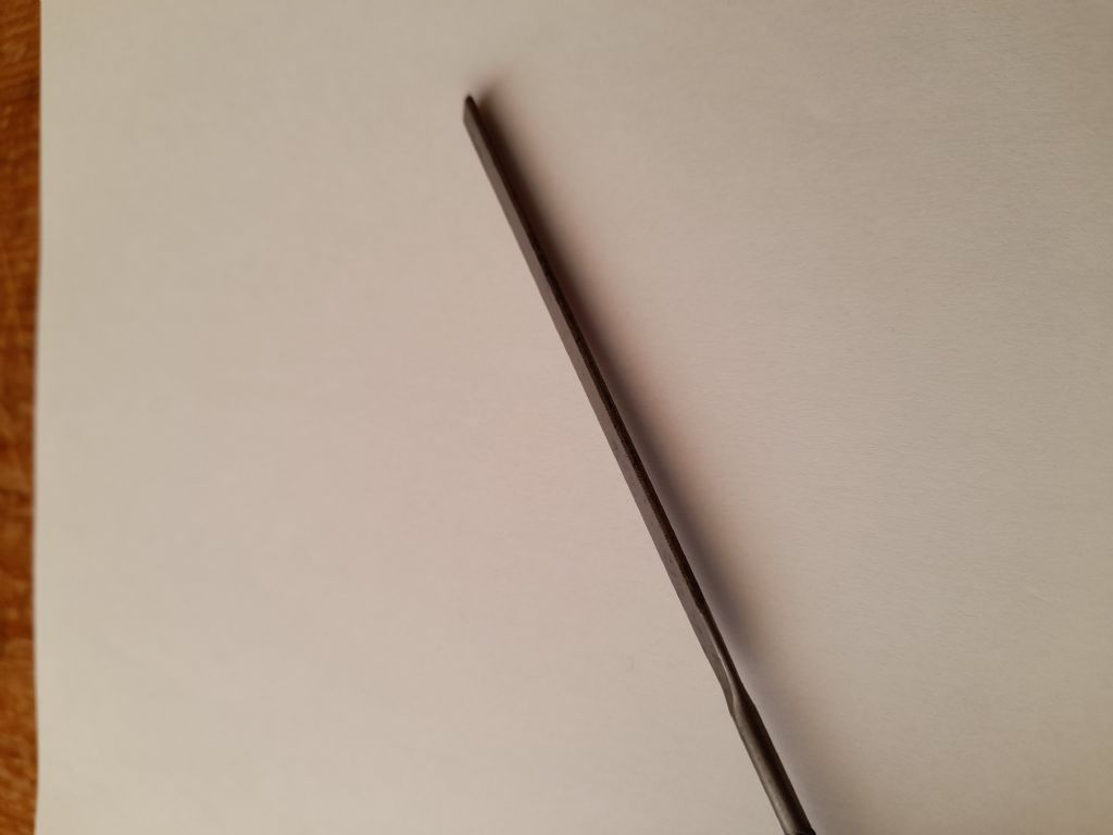

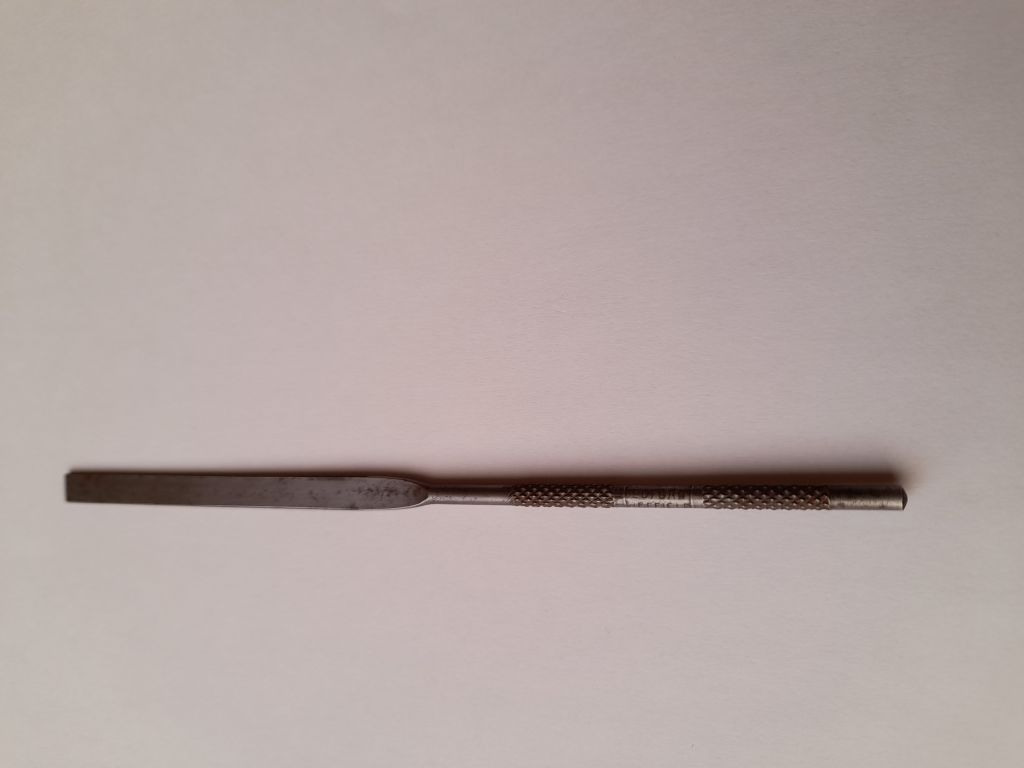

      20220126_091119.jpg20220126_090927.jpgHi, I came across this the other day and wondered if anybody knows what it is.
      It looks like a small file but the two faces are smooth, the edges have very fine teeth like a file. It is 150mm long x 6mm wide x 1.5mm thick. The handle is stamped with Bedford, Sheffield, England and it has a number 4 stamped on.
      Thanks
      Geoff

        Clive Brown 1
          @clivebrown1
          It's a fairly standard needle file for filing the base of a narrow slot. Many other shapes are available. Bedford is the maker's trade-name. The 4 will be the "cut", fairly smooth.

          #582518
          Brian H
            @brianh50089
            Usually known as a warding file I believe, due to their use to cut the ward (slots) in lock components including keys.
            The are useful when filing slots as they will only cut on the edge and do not widen the slot.

            Rod Renshaw
              @rodrenshaw28584
              I agree with Clive's thoughts, but I am not so sure about it being a warding file.
              I understand a warding file to be a slimmer version of a normal "flat file", usually double cut on both flat faces and single cut on both edges, and used by locksmiths and others needing narrow slots.

              Ketan Swali
                @ketanswali79440
                Link: Joint Square Edge Needle Files
                It was discussed on this forum in 2018: Link
                Link: Joint Round Edge Needle Files

                GeoffT
                  @geofft
                  Thanks for all the answers. Just shows you never stop learning!
