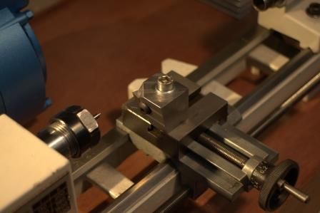

      Good evening,
      I am a retired combustion engineer from the steel industry and have developed an interest in the repair of grandfather clock movements.
      I very quickly noted that I needed some form of lathe for this and went for the EMCO Unimat SL due to it's compact size.
      I tried the original motor but it was too noisy and time restrained.
      Then I went for a standard 90w sewing machine motor controlled via a foot pedal but as well as not being able to control my left foot the motor was not powerful enough to achieve higher speeds under load.
      After research I bought a 550w DC servo motor from Amazon, designed for an industrial sewing machine.
      It was simplicity itself to fit and is more than adequate for my needs. Very quiet, up to 4500 rpm and reversible at the touch of a button.
      I have, hopefully, uploaded some photographs of the setup for your perusal.
      I am very happy to provide any more information if you so require.
      kindest regards,
      David

                    #565525
                    Clock polisher
                      @clockpolisher
                      Good afternoon,
                      I purchased the QCTP from Mars CNC Machining in Fresno, USA
                      The owner, Harry Koesnadi, is very approachable and responds to all communications.
                      He, like so many other companies, has taken to selling his wares to the public on EBAY.
                      Run a Worldwide search for QUICK CHANGE TOOL POST FOR UNIMAT LATHE DB200/SL1000, seller name HKOESNADI
                      I have just ordered four more tool holders from him and suggested that a Tail Stock riser block may generate some interest. He agrees and is looking into it.
                      I only took delivery last week and have quickly tried the various functions of the post.
                      It is superbly well made and will make my job a lot easier, I was spending more time re-chucking the workpiece after tool changes than actually working on it.
                      I have posted some photographs, showing it as well as I can.
                      kindest regards,
                      David

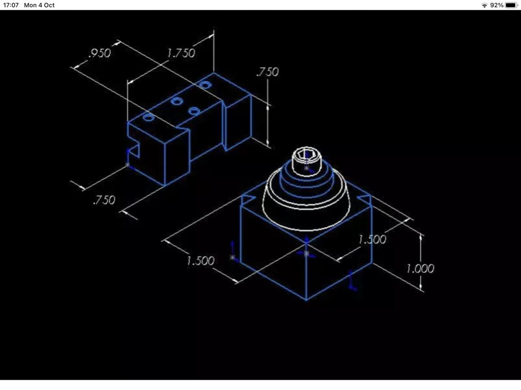

                      #565531
                        Thanks for that, David … an ebay search for the Seller name found him immediately, and I have saved it for future reference.
                        For convenience: Here’s his sketch, showing the basic dimensions
                        Edited By Michael Gilligan on 04/10/2021 17:12:10
                        #565600
                          Although it's nice to be able to change tools quickly I do wonder how practical one is on a Unimat. Firstly the additional overhang will do nothing for rigidity meaning even lighter cuts need to be taken and secondly from having made a 4-way toolpost for my U3 many moons ago it was not a lot of use whenever the tailstock was used for support which the small lathe seemed to need quite a lot.
                          I'd be tempted to make a batch of the standard toolposts which are a very simple design and leave a tool shimmed up in each then it's only a couple of turns more of the mounting screw to swap over the whole post.
