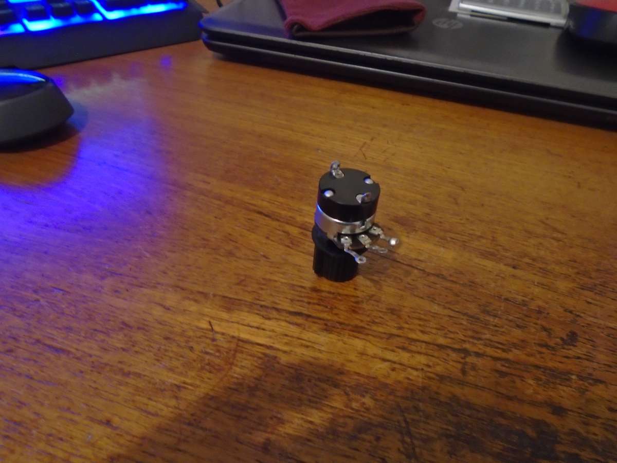

      Hi anyone know how to check my potentiometer fully, I have watched  many YouTube videos , but they never mention
      my type of 4K potentiometer , I have checked resistance on the three terminals they are fine + 4.5 k – 4.5k
      but I don’t get any readings using multi meter from the two terminals which i assume is the switch ,I tested  it
      with a bell it rings with switch on or off all the time ? maybe this how it works ,I just would like to know whether
      this is a fault or not I contacted Chest Machines for a new one but the never got back to me . Euro Trade did offer
      a new one that is similar to my machine ,this may be my only option . PVM

        Can you post a photo of the switch just to make sure we know what we are talking about.
        The switch should make an audible click as it operates.

          Thank you for replying ,I will post photo tomorrow, However  the potentiometer is just a standard pot with a switch located below main pot , Yes it does make a audible click when turned anti clock wise ,which is when you reduce spindle speed to zero and switch makes audible click, Not when turned clock wise to start spindle rotation.
          My question is should there be continuity from one switch terminal to the other terminal when the pot is turned clock wise or anti clock wise before pot range end is reached.

            Usually at full CCW the switch is turned OFF (no continuity)

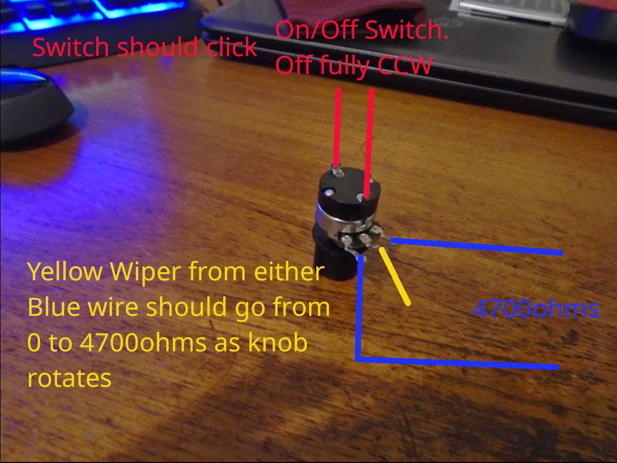

              Has requested here is the attached photo of my Potentiometer from Chester Conquest Super Mill:-
              potentiometer
              #729850
              pvm
                @pvm
                Thank you for your advise John , However I seem to be going round in circles here .I just want know if there should be continuant between the two switch terminals when the switch is turned on i.e.  potentiometer turned clock wise If the answer is yes then my potentiometer is faulty and I will go ahead and purchase a new one .

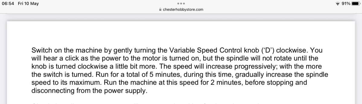

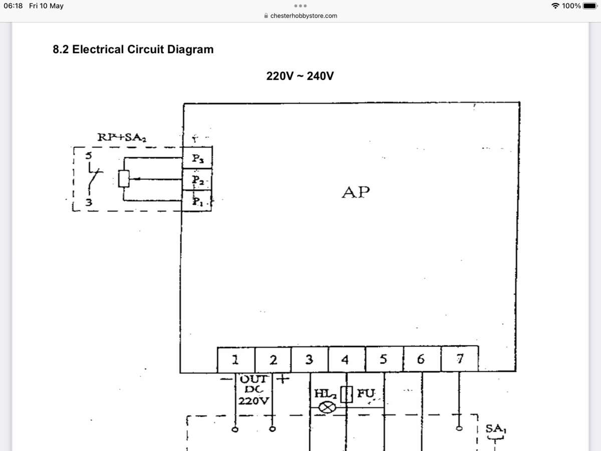

                    On pvm Said:
                    […]  Yes it does make a audible click when turned anti clock wise ,which is when you reduce spindle speed to zero and switch makes audible click, Not when turned clock wise to start spindle rotation.
                    I struggle to understand how there can be no audible click when the pot is turned clockwise, but it certainly suggests that the switch has failed.
                    From the crude diagram supplied by Chester, it looks like you could easily confirm that by substituting a known good switch.

                      Robert Atkinson 2
                        @robertatkinson2
                        The two contacts on the black part of the pot/switch assembly should show continuity when the shaft is anywhere but fully counter clockwise.
                        It appears yours is faulty.

                          The one on my Chinese lathe is the opposite: It is ON when fully CCW and OFF (no continuity) in all other places. It’s *possible* that the OP’s could be the same.
                          Whatever the case, it should go from open to closed or vice-versa in the fully CCW position.

                                On pvm Said:
                                … I just want know if there should be continuant between the two switch terminals when the switch is turned on i.e.  potentiometer turned clock wise If the answer is yes then my potentiometer is faulty and I will go ahead and purchase a new one .
                                The simple answer is 99.99% yes, and switched pots are so cheap you might just as well change it.
                                Though Andy reports his lathe is different, that’s highly unusual, not least because these machines use bog-standard pots to keep the price down.  Special components are the province of high-end kit, where money is no object.
                                For completeness:
                                switchpot

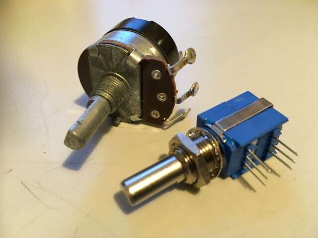

                                                    For posterity (since I’ve just found the info), a better quality pot for the ‘closed when off’ option is a Bourns model 56 Series which can be obtained with an SPDT switch.
                                                    Part numbers:
                                                    5k ohm (or 4.7k) Bourns 56AAD-C28-B13/R81L
                                                    10k ohm: Bourns 56AAD-C28-B15/R81L
                                                    I couldn’t find a UK supplier for single quantities of the B13 (5k) pot, so went with the B15 (10k) pot as I was pretty sure it would still work. (It does).
                                                    The 10k pot is available from RS Components it was about £12 four years ago, but I now see it’s £24!!
                                                    https://uk.rs-online.com/web/p/potentiometers/7422198/
                                                    Mouser seem to carry it too, but also pricey:
                                                    https://www.mouser.co.uk/ProductDetail/Bourns/56AAD-C28-B15-R81L?qs=QpZVHcK7GhTE0BqrfbGLYA%3D%3D
                                                    Other variants to look out for:
                                                    5th character ‘A’  OK (anti rotation lug)
                                                    7th character ‘B’ OK (smaller shaft diameter)
                                                    8th/9th characters 24 OK (shorter shaft)
                                                    11th character ‘E’ OK (electrical tolerance)
                                                    It is a much, much better quality component.

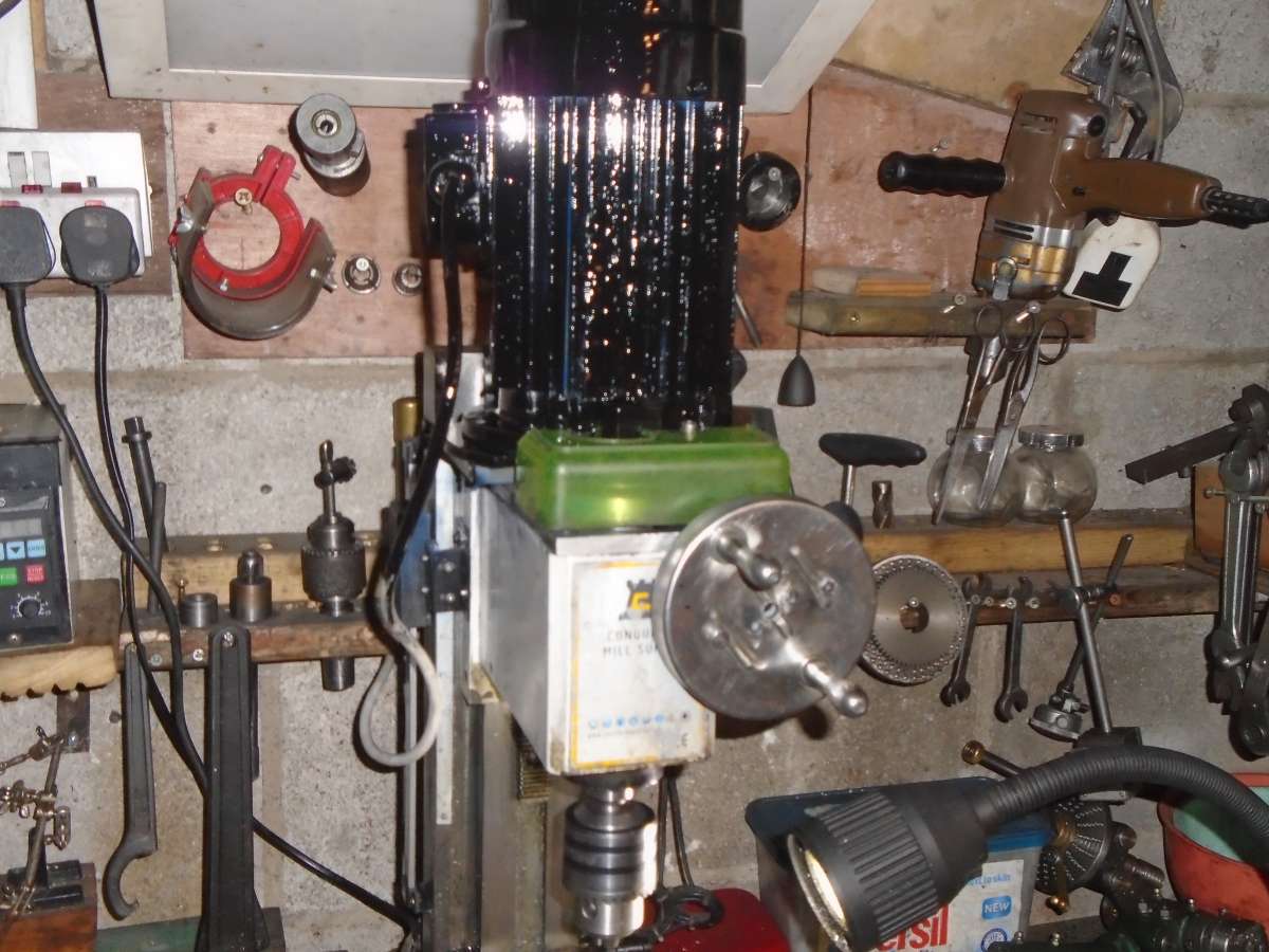

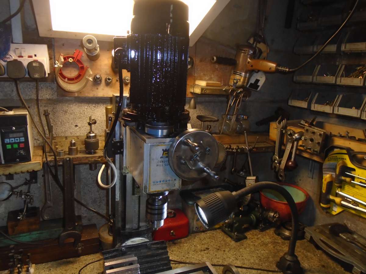

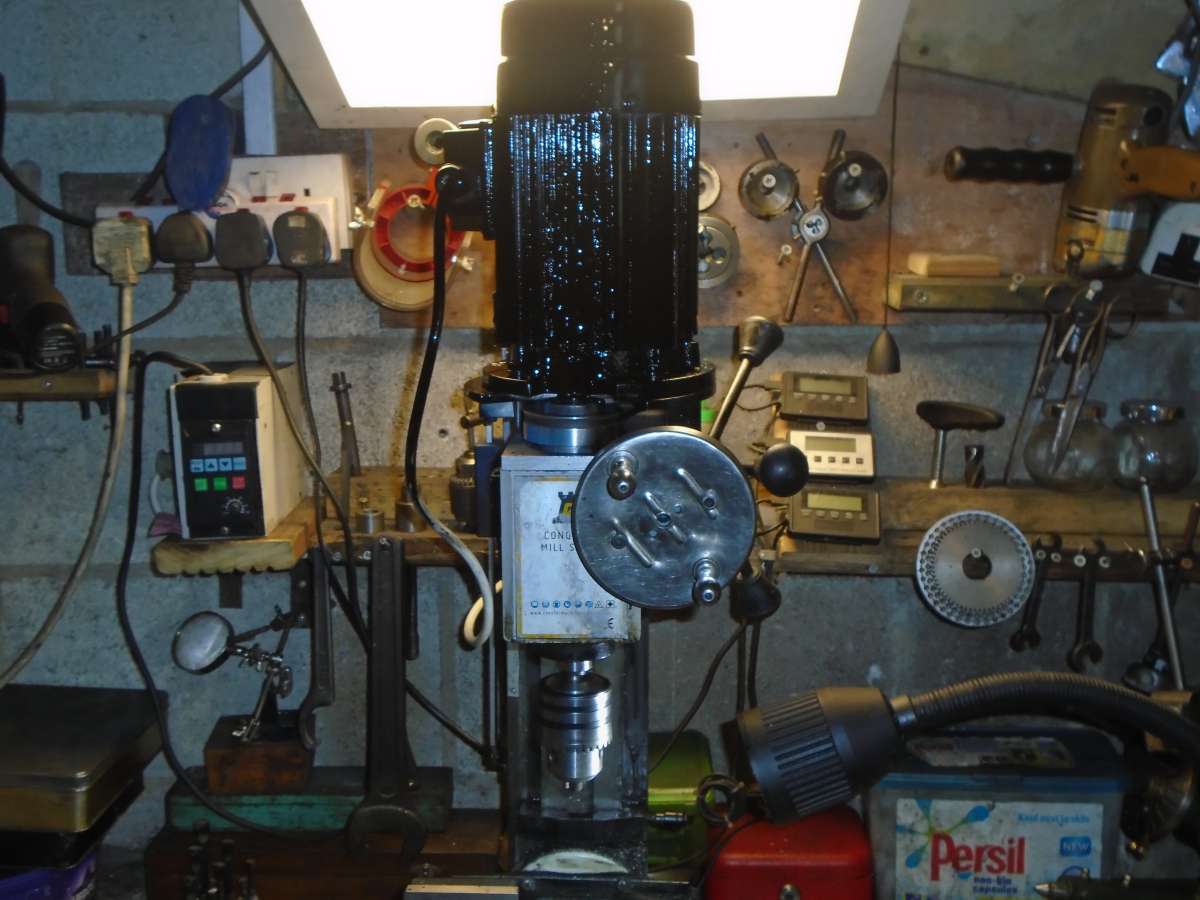

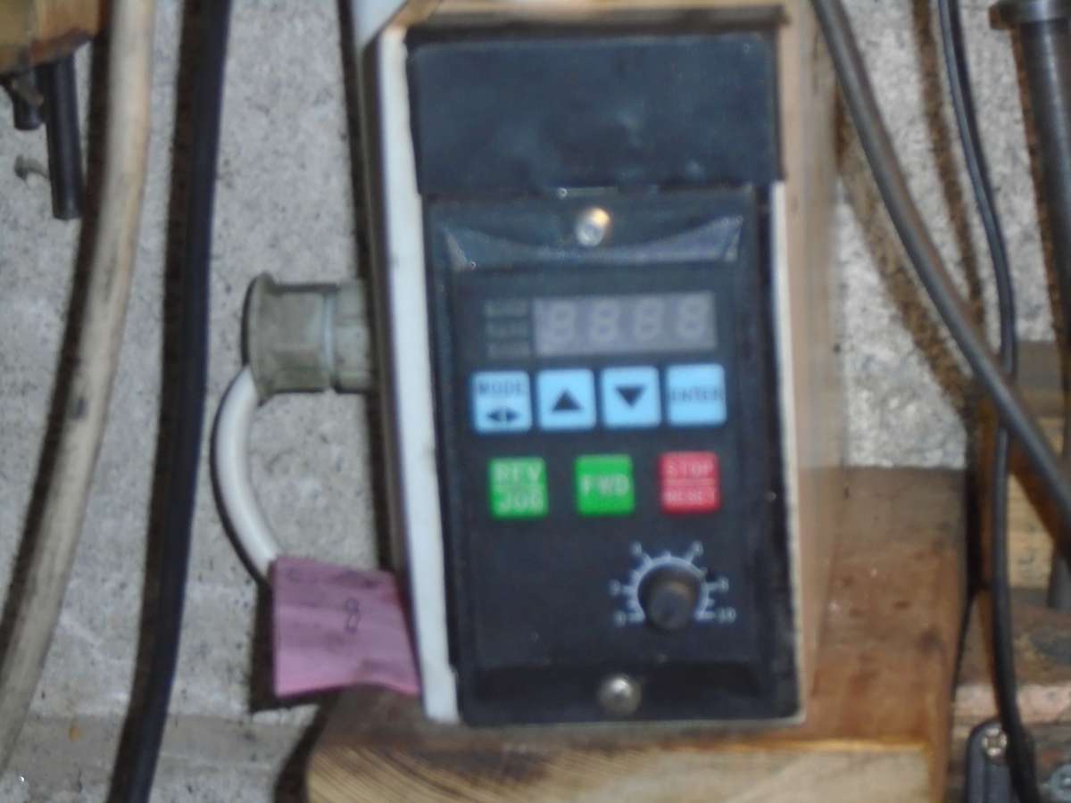

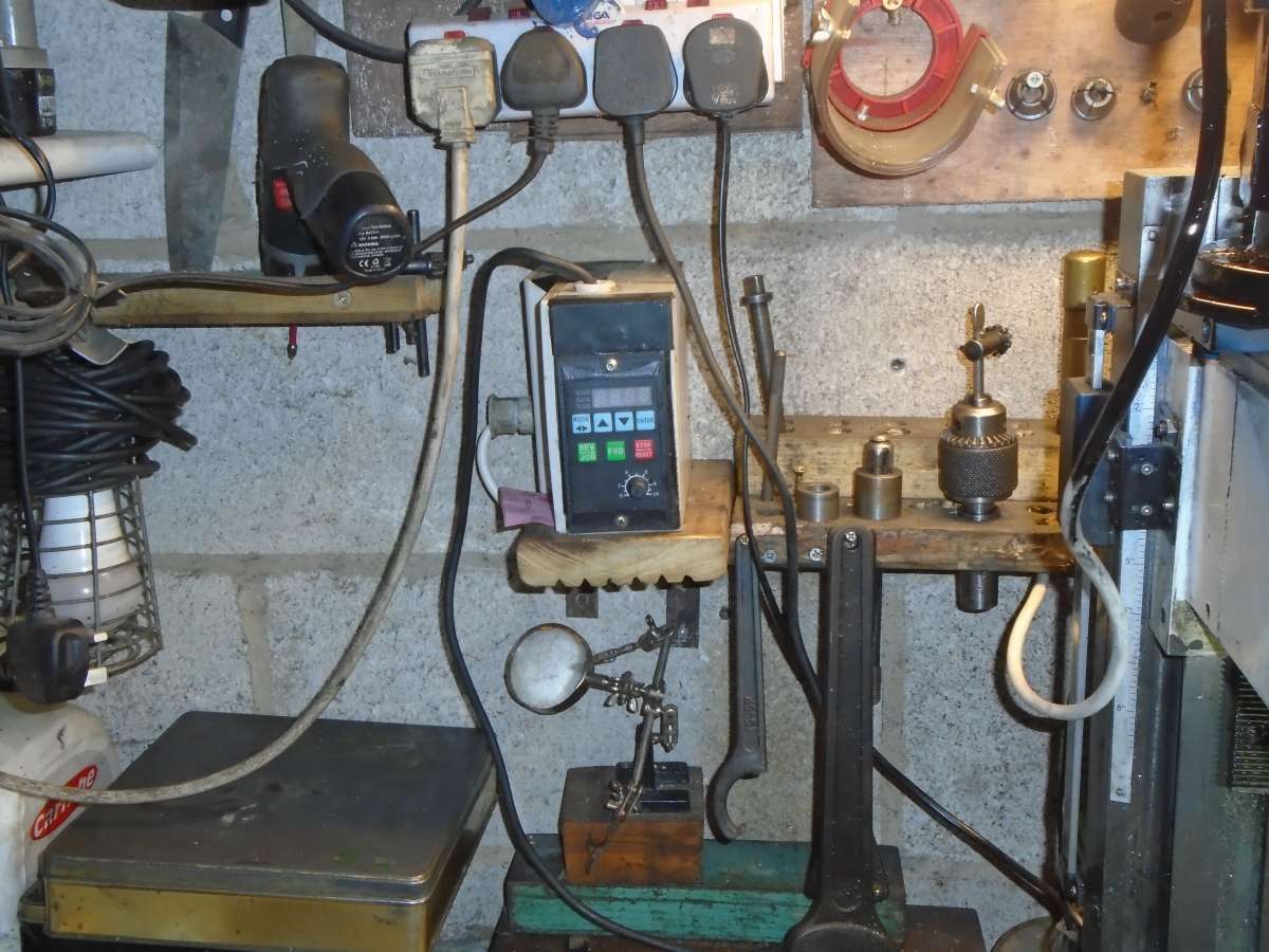

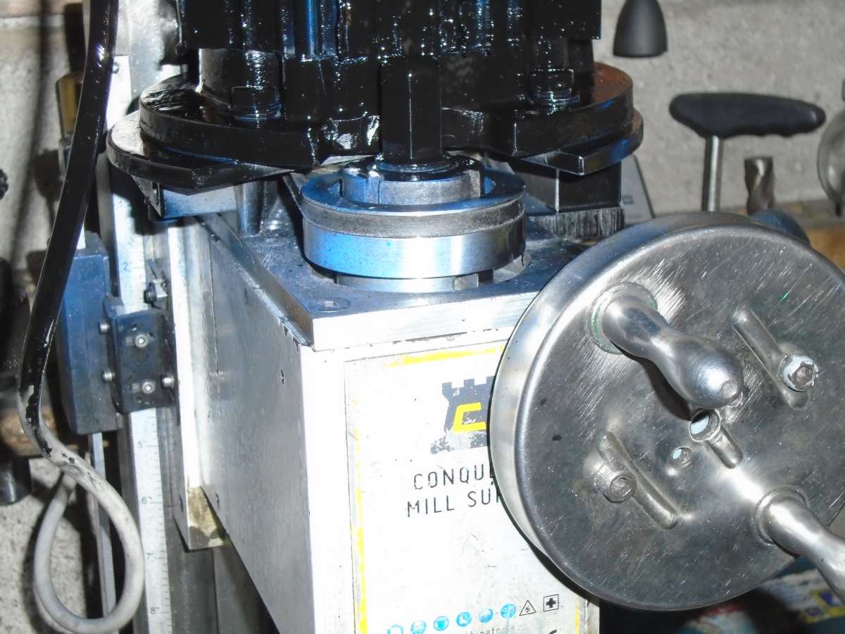

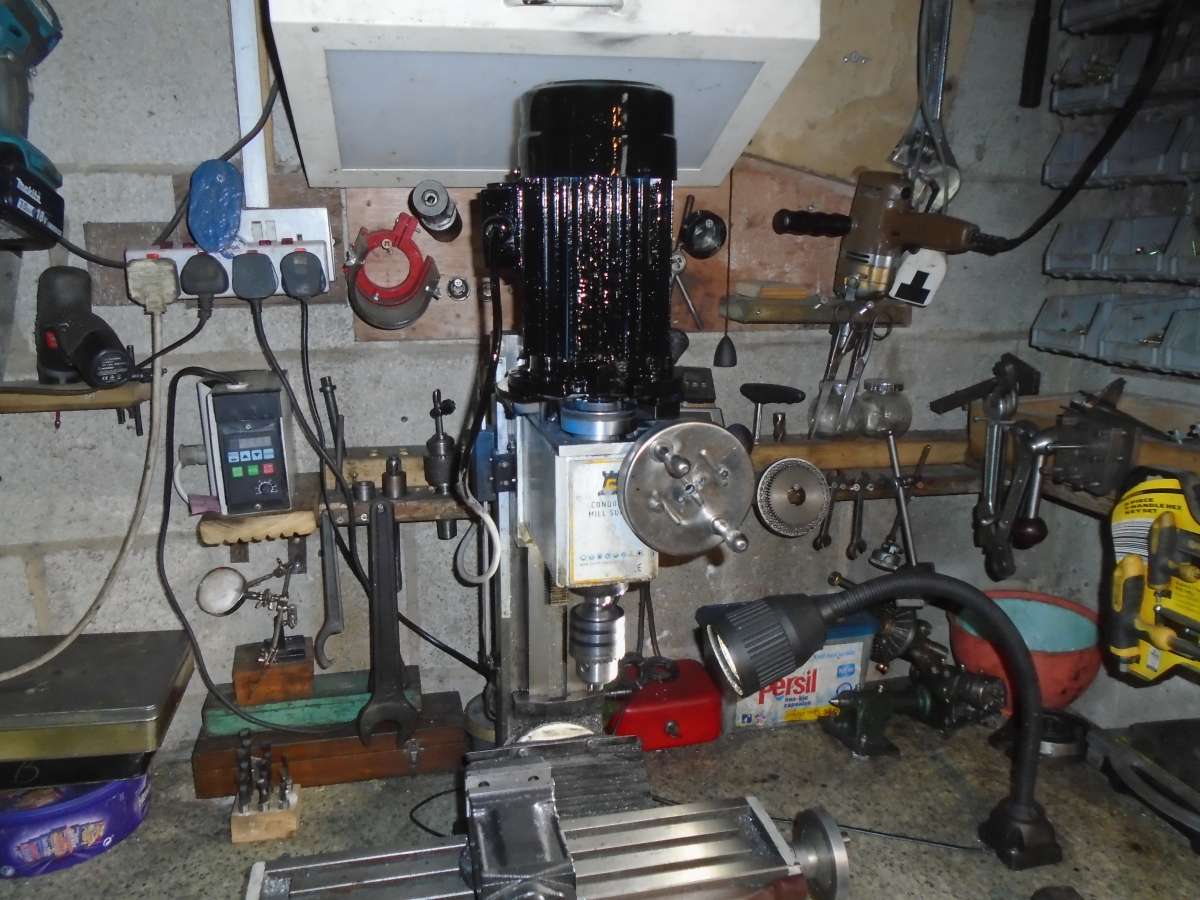

                                                      Thanks to all shown hear that gave good advice on my problems with my Chester conquest mill
                                                      Andy , Rob , Dave, Michael , Robert and John:- This post is a follow up has promised.
                                                      I purchased a new potentiometer from amazon to see if that was the problem, However it did not solve the issue.
                                                      So I bit the bullet and proceeded with plan C  ” Convert my mill to three phase drive using one of my inverters .which I had and purchase earlier. I then purchased  a new 3 phase motor form ebay .and installed it onto my Chester Mill . The result worked perfectly Please see phots included:-Chester Motor Conversion 1Chester Motor Conversion 2Chester Motor Conversion 3Chester Motor Conversion 4Chester Motor Conversion 5Chester Motor Conversion 6Chester Motor Conversion 7
