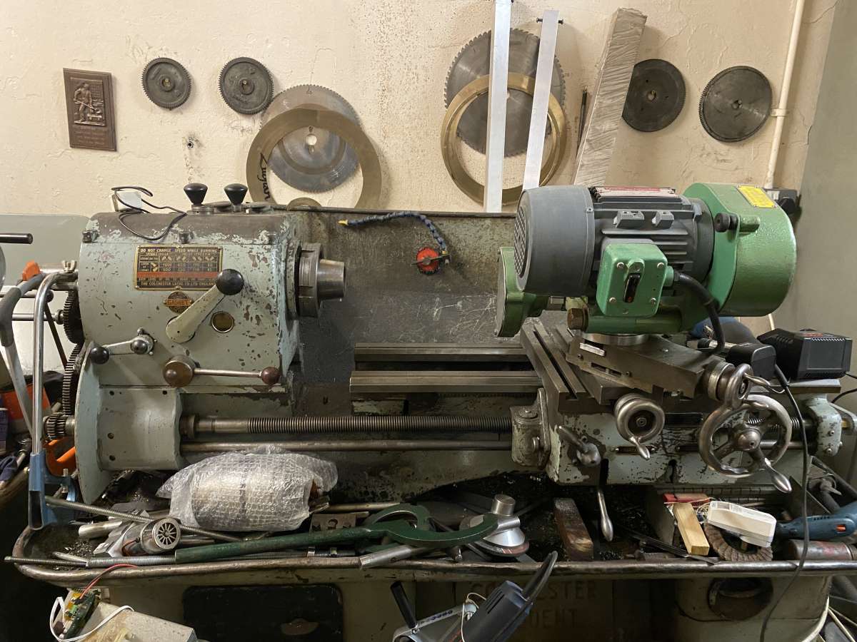

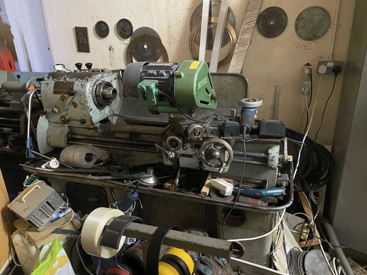

      Hi All,
      My first lathe was a Colchester Student.  I now have a Bantam and I repurposed the Student to grinding duties.
      A friend has offered me a J&S surface grinder that would fit in the spot the Student currently occupies.
      Normally I’d just sell the Student but it has seen much better days.
      Plus points… the head is perfect. Nose runout below surface roughness of nose. All the gears work. All the feeds work. It has imperial & metric cross slides and imperial and metric leadscrews, a full set of change gears, fixed and travelling steadies, faceplate, 3 jaw and 4 jaw chucks. The half nut is new as, inexplicably, it came without one.

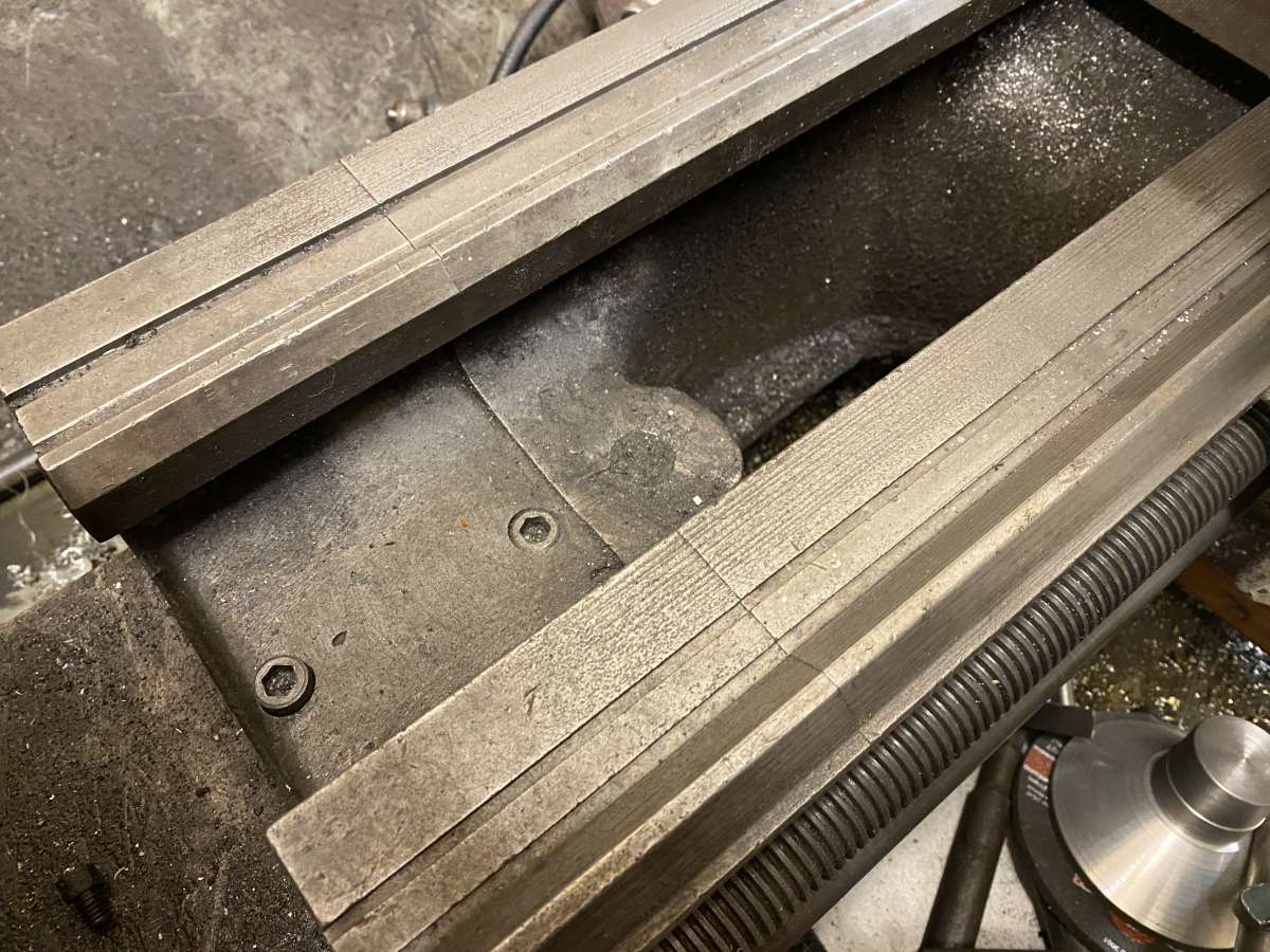

      Bad points… the bed is done.  It was used (before I got it) to chamfer pipes with some sort of grinder and no attempt to shield the ways was taken.
      I think there might be a 40 thou drop from front to back and most of that is right up next to the chuck where you’d not want it. Drilling small holes (under 2mm) isn’t possible as the tailstock is no longer at the correct height close to the chuck and even larger drills feel the pain.
      So, the options look like…
      1) Scrap it in total.
      2) Remove everything that’s good and scrap the bed & stand.
      3) Sell it as is.
      What do you guys think?
      Cheers,
      Wilson.

        If there is in fact a measured 40 thou wear on the bed, it is probably Ritz crackered beyond economical regrinding. So you probably won’t get top price for selling it as is. Someone may buy it for the many other parts on it that are still good though, at a reduced price of course.
        But with the price of Colchester parts, it could be worth selling all those parts on eBay, HomeWorkShop site etc yourself. Which of course takes a lot of time and effort in posting ads, packing and sending and dealing with the paperwork and fees. And all the while you are tripping over half a shed full of Colchester parts.
        Depends on how important the money is to you, vs the time to part it out vs the inconvenience space-wise.
        I very, very definitely would not scrap a Colchester though. Somebody somewhere will buy it. And any sale price is going to be better than the scrap value. Parts for this sort of old Brit iron are getting rarer and rarer and prices reflect that.
        Besides, it would be a crying shame to see the old girl go down the gurgler.

          Hi Wilson, sell it as is under spares/repair, someone may well have the bed reground, and then refurbish the rest, and it would save you stripping it down and posting several sales.
