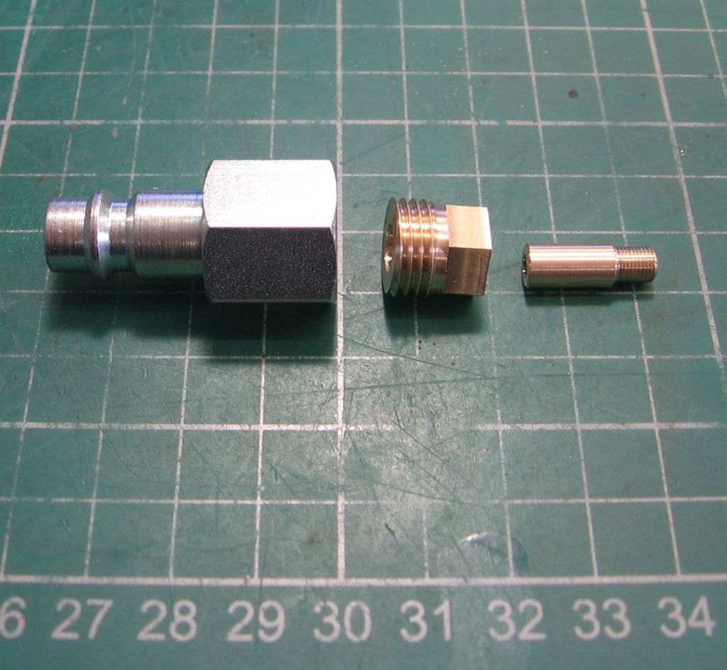

      I have an air line fitting with a 1/4" BSPT female thread and I want to make a mating part. BSPT dies are for a one off job are quite expensive and I do have a BSPP die already. It obviously wedges into the female thread. Since I don't need to take it apart will a drop of loctite be adequate or alternatively can I tap out the taper thread with a parallel plug tap for a better fit, overall size and TPI are the same so it doesn't look as though too much material needs to be removed?

          Martin .Tap parallel and use loctite or If the job will allow it a bonded seal or Dowty washer will make an air tight seal. Noel

                The standard rule is you can fit a straight or tapered male into a tapered female. So your arrangement is not a bodge. I would use a suitable sealant.

                      The arrangement is not a bodge. Any of the four combinations of BSP parallel and taper is acceptable, provided one understands the limitations.
                      BSPP = parallel thread
                      BSPT = tapered thread
                      BSPP external to BSPP internal – not regarded as pressure tight, ie, the seal is made by the threads themselves. Mainly used for non-pressure glands and fittings, or where pressure tightness is achieved by other means such as tapered cones on the pipe and recesses
                      BSPP external to BSPT internal – not regarded as creating a pressure tight joint using the thread alone, not much used
                      BSPT external to BSPP internal – can provide a pressure tight joint using the thread alone. It is relatively easy to create a tapered external thead compared to a tapered internal thread, so this combination is a good compromise. Of course some additional sealing can provide belt and braces.
                      BSPT external to BSPT internal – provides a pressure tight joint using the thread alone

                                Thanks very much chaps, it would appear that there is a diverse opinion so, these are the bits,
                                the small spigot is an interference fit into the brass bush and sealed by soldering, the BSPP bush will jam in the BSPT fitting and with a drop of thread seal probably not leak. For the occasional test of one of my locomotives at 60psi it will probably be adequate. Many thanks for the most interesting discussion.

                                  For safety I would make the spigot currently an interference fit as a clearance and silver solder so you get full penetration of the joint. As an interference with a solder “caulk” the solder will add no strength. If you silver solder so you get penetration nothing will break it asunder!

                                    I think you're right Paul and when I assembled it a niggling thought lurked at the back of my mind. I have decided to make a mk 2 version where everything is threaded together.

                                          As stated previously, BSPP male into BSPT female is NOT a bodge. It is accepted practice in industry. Thead sealant is required for leak free joint. either liquid or tape.
                                          Glad you threaded the small part. Another option would have been to countersink the inside end an flare it out so the piece can't blow out.
