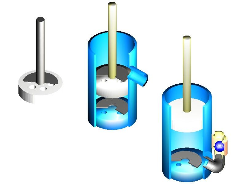

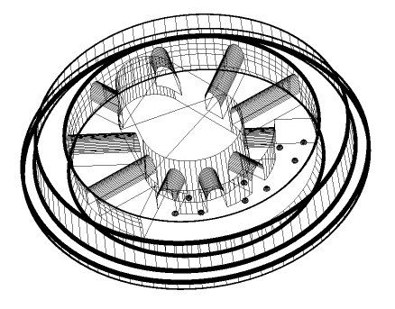

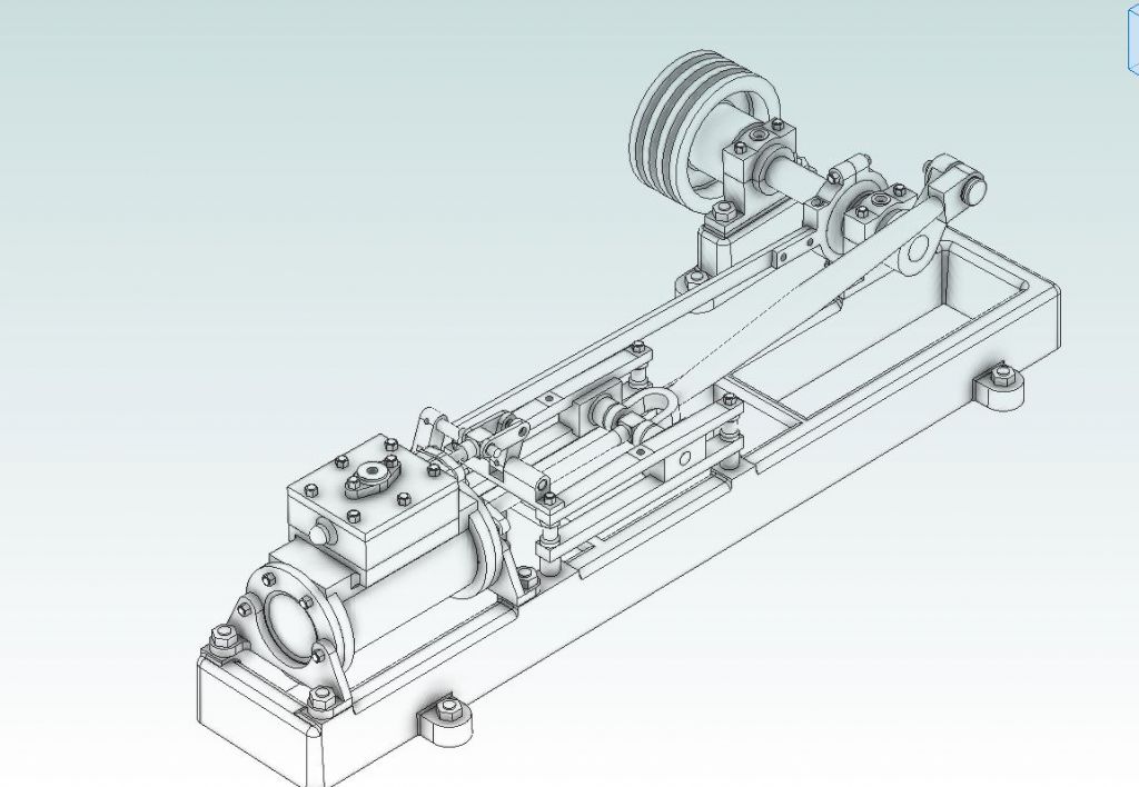

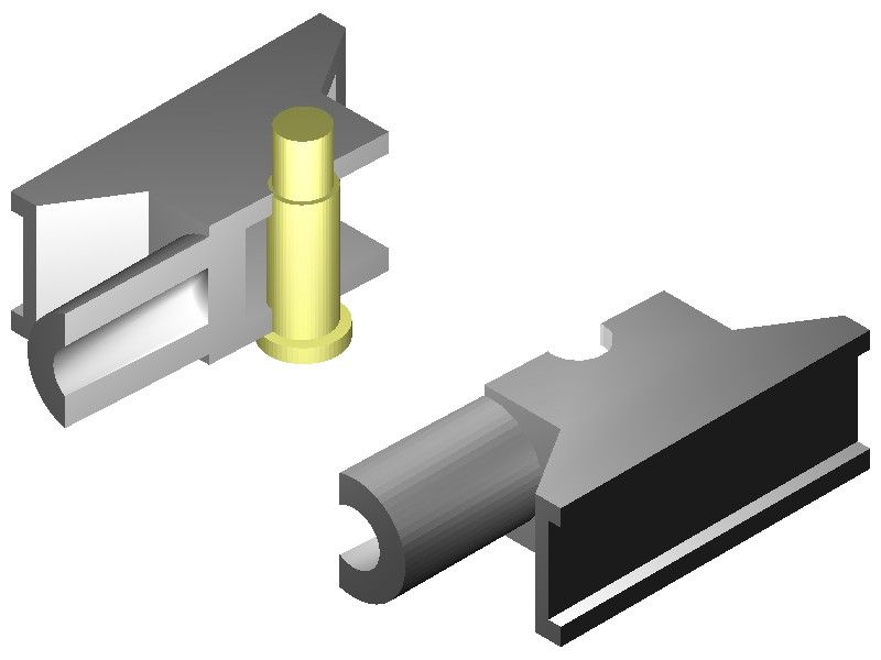

OK: ones I have on my album.
The sectioned pumps were to help discussing types for a particular application. The rest are really only exercises, of not much practical use: Respectively, the lift and force pump to show their principles; one of my steam-wagon cross-heads (made from a pair of castings I think originally for a 7-1/4" g. loco), and an attempt to model the wagon itself as it is so far.
I soon realised the lorry is far beyond me – the wheels for example are of two rose-pierced discs, not solid. The two bit as floating in the background are a "spare" footplate/ bunker floor and a bunker, where I generated them. Making the bunker look like a bunker with a floor was one of the hardest parts of the exercise. It was either a solid block or a wall with no floor to stop the coal falling on the ground. I soon realised this exercise is right at my limit, lacking any details like boiler fittings, steering-gear and springs, though I think I later added the two crew seats and a simple block representing the vertical engine between them.. They are just rectangular blocks though.

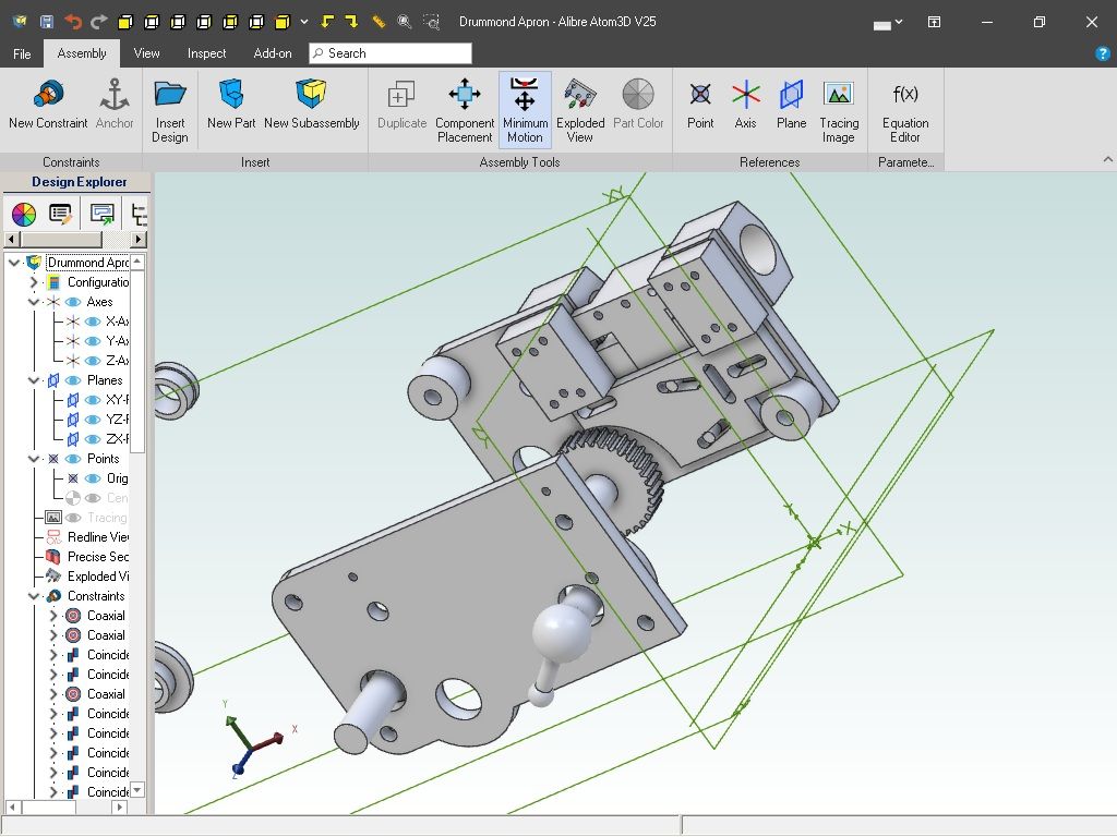

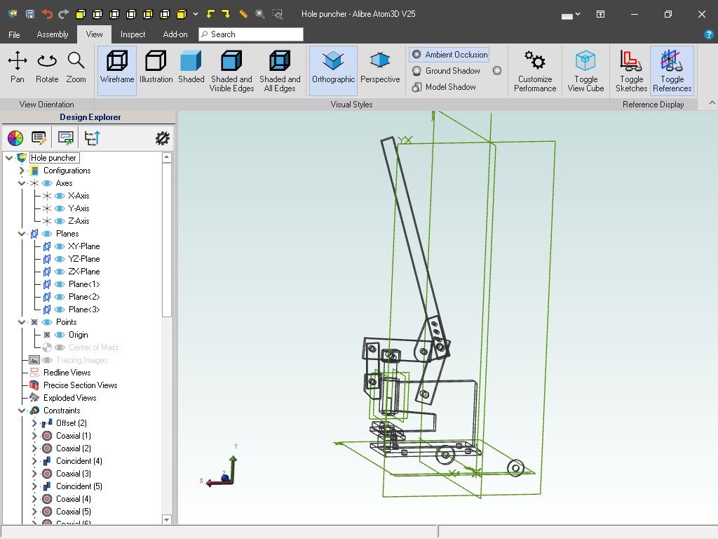

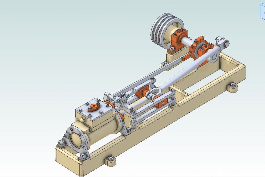

If Nigel can only get wireframe then no wonder it is difficult. Alibre has the option to show items in wireframe but it is something I never use as it becomes just a jumble of lines once you get to anything of any detail and it does not even differentiate hidden or visible, take this example, it's a Stuart Victoria but you would be hard pushed to tell what it is or make out individual parts
Using "illustration" does at least hide the hidden lines if you want a basic B&W image
There are a couple of other options but the one I tend to use is "shaded with visible edges" Immediately you can see where one part starts and another ends, I use colour to distinguish materials which also helps see what is what.
The view option is quite important so Turbocad must have the same sort of thing
If you look at my toolbar the entire top section gives viewing options

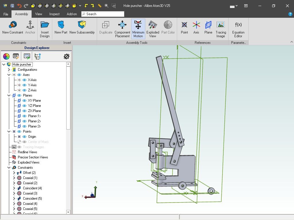

The only thing that I'm interested in with 3D is dimensional accuracy. 3D CAD helps me to calculate and define 3D things that I would struggle with otherwise. It is important to me that I can accurately describe the shape of solids. Wireframe is my main render scheme, to do geometric construction and alignment. I rarely need to sell or promote anything, just to get stuff made.
It's much more important to me that I can accurately pick a vertex from the wireframe fuzz, select an associated facet and start manipulating the model on that facet. If I know how to do that with TurboCAD, then there is no limitation about what it can do for me.

MoI doesn't do 'assemblies', but it is very good for making any sort of mechanical part, quickly and quite easily, with a little practice.

That's all I do
Make each little part in its own little file, easy peasy 90% of the time
When you've done the parts you need, dump the lot into the assembly program section and cobble them together
edit: and I don't get hung up on threads etc, I just join the holes together with the coaxial constraint command, I want to see it working before I get down to any assembly nit-picking details, I've only ever done about 4 threads and 2 bolt heads in 3 months, all the stuff I've put up in here is held together with its holes aligned and it works fine

Those cut-away pumps seem to have attracted some interest, even a compliment, very rough sketches though they are.
I knew they could never be Haynes Manual quality but were enough for their purpose. I had helped build the lift-pump on which I based a drawing to help discussing if that pattern would work in another application. (No, it wouldn't.)
I could draw them only because their parts are mainly simple cylinders, each set on a common axis. That made for easy assembling by co-ordinates from the part's original, arbitrary drawing positions. I do not know if Alibre and SE work like that. Something like a centrifugal pump would be impossible for me in any 3D CAD.
