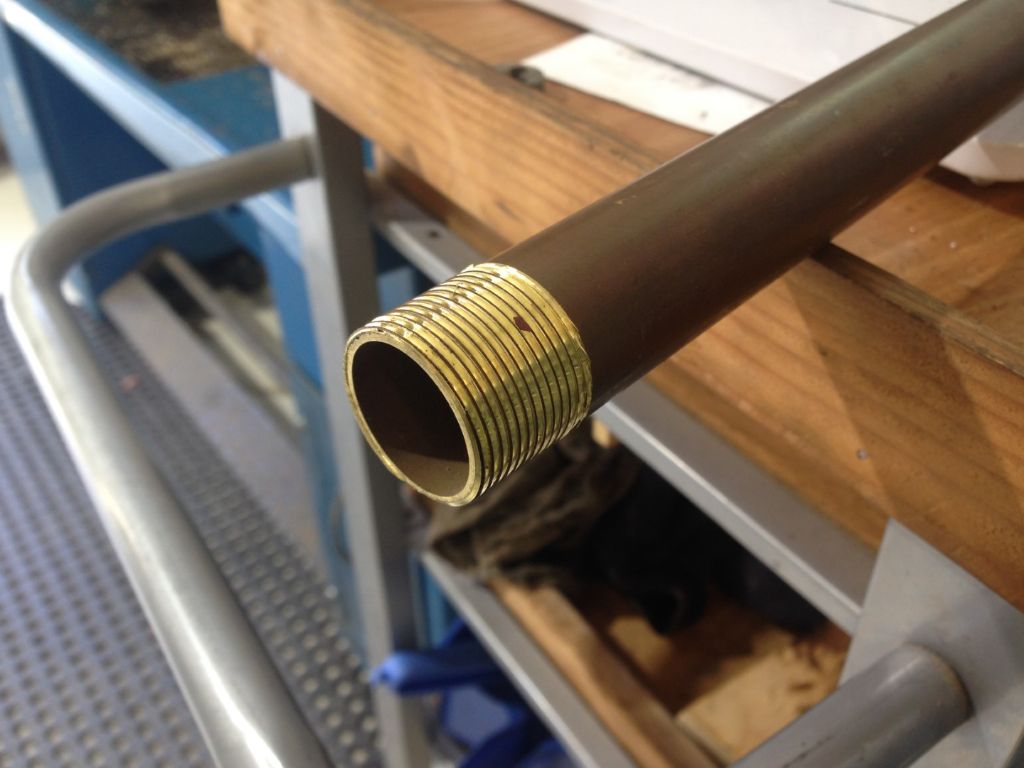

              I went along to our local "Mens Shed" (community workshop) today and saw someone turning a thread on a piece of 1" (now called 25mm in metric) brass pipe which was to be screwed into a 1" BSP brass fitting.
              Would you be able to do this if you ordered 25mm pipe and was supplied 25mm tube instead ?
