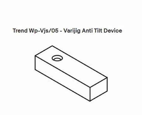

      There is one small very simple item missing which is called an anti-tilt block
      I was wondering if anyone has one of these could I please have the dimensions so I can knock one up?
      Cheers, Martin

            I don't have this particular jig, but I think the block will be the same thickness as the frame, other dimensions not critical. I guess it is screwed to router base to stop router tipping over, when balancing on the narrow frame.
            I just stick a suitable block of wood on the base with double sided tape, when using home made jigs.
            Instructions for Varijig are here ;-
            Varijig PDF
            Mark.

                I think it will be the same thickness as the frame plus the thickness of the part of the template guide that rests on top of the frame.

                John Haine
                  @johnhaine32865
                  **LINK**
                  £3.90 from Trend Direct.

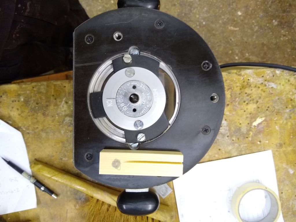

                    Hi again,
                    Trend Router Bases are tapped M6, so you only need a clearance hole and counterbore.
                    Plastic/Nylon/Wood would also be ok to use. The Trend one is probably plastic, so it won't mark the job.
                    For Reference the piece in this picture is 70mm long x 20mm wide.
                    The Guide Bushes are flush with the router base, so don't add anything to the thickness of the jig.
