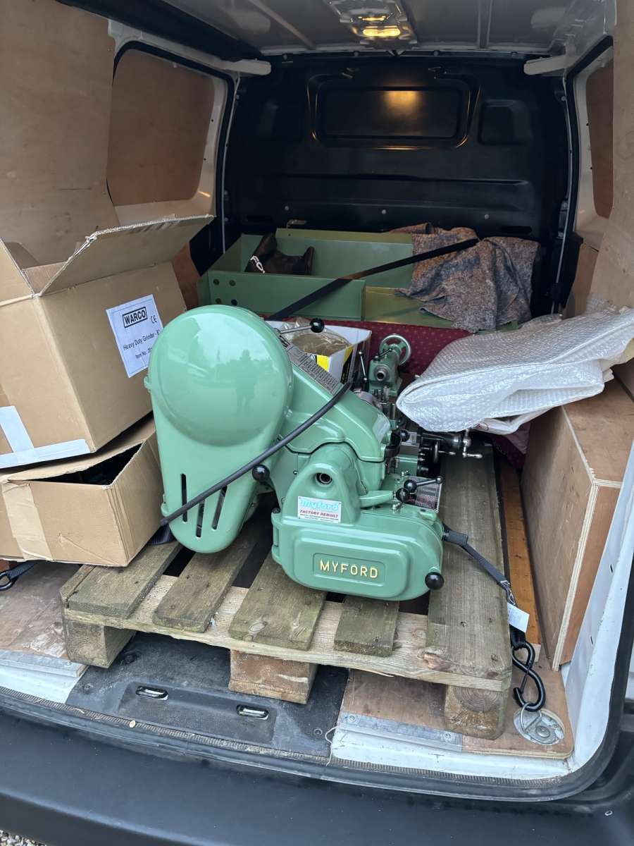

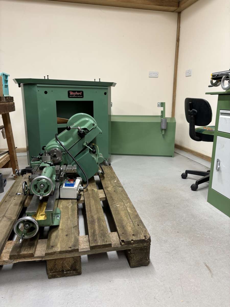

                                          So, I ended up hiring a small van for £30, securing to a pallett, and arranging 3 friends to help unload – the seller had kindly arranged help at his end also. Now safely in my workshop ready for the stand to be bolted down, and the lathe mounted, for which I have an engine hoist and strong friend to help with the lift and setting down onto the raising blocks. Many thanks for your helpful inputs

                                            Once the cabinet is fixed in place, the raising blocks will enable you mto “level” the lathe, by removing any twist from the bed.
                                            This will ensure that the machine cuts parallel, rather than a taper.

                                              Hi Steve, good on you to use a van rather than are car, much safer, and can be securely strapped in place. And of course it doesn’t mess your car upholstery up.

                                                You’ve probably finished already but remember if putting a strap round the bed it goes inside the leadscrew and you then put a rope round the strap and pull it (the rope) tight through the spindle bore to stop the lathe flipping upside down.

                                                  Thanks Bazyle, I havent mounted it yet so a timely input. I spent this afternoon levelling the cabinet on the slightly uneven concrete floor and then removed the raising blocks to remove all of the congealed oil from the drip tray.

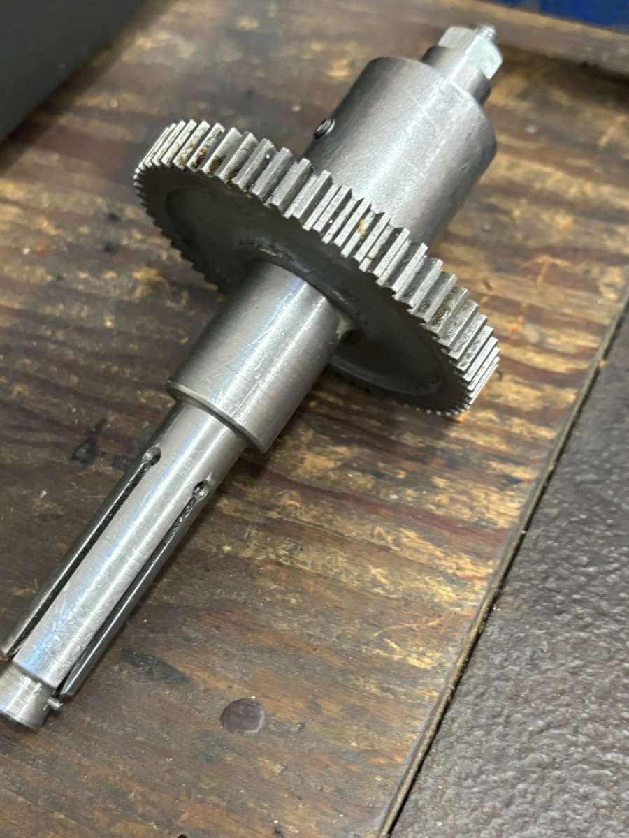

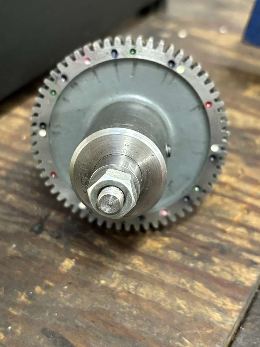

                                                  I got load of accessories with the lathe – chucks, faceplates, catch plates, tools & holders, taper atachment, tailstock die holder etc etc. Included was the object below – what is it??

                                                    It looks like a 60 tooth gear which you can fix to the left hand end of the spindle using the expanding mandrel
                                                    Then you can use it for indexing with a detent to drop in between the teeth, marked up for a set number of divisions.
                                                    When I wanted to make a 22 tooth splined shaft for the Ducati, I arranged something similar, but with a compound gear train, as I also needed the workpiece to pass through the spindle.
                                                    I then arranged what was effectively a single point cutting tool, but twisted through 90° towards the headstock.
                                                    I could then use the carriage to plane the grooves/splines.
                                                    After a while, I adapted the top slide to lever action for the same purpose, but that meant I could also cut tapered splines, and without straining the rack.

                                                      The little colour coded dots will be common divisions like 3, 4 or 6 etc
