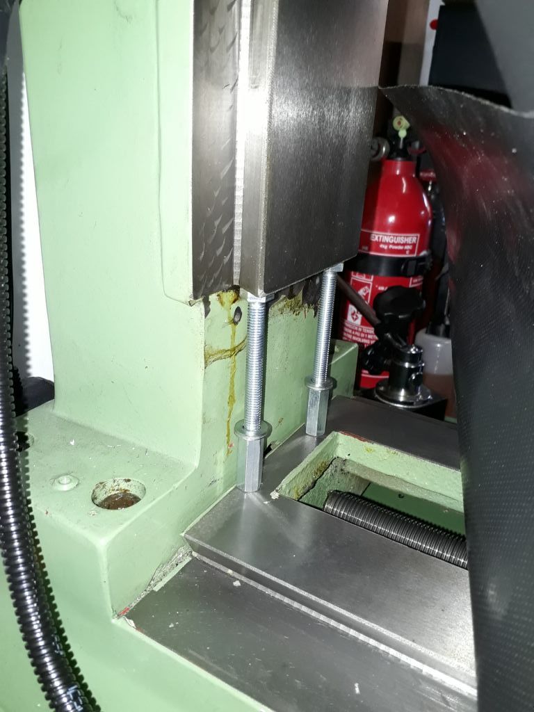

      Some time ago I had tilted the head of my WM18 mill to cut some angles but when I was done and tried to tram the head back to normal I ran into problems.
      I could get the head trammed in the left to right direction ( that would be the X axis?) but the forward to aft direction ( Y axis?) was off and I could not find a way to adjust as the column is fixed.
      I remember asking of advice on how to adjust this and the general consensus was to leave as is if the out of tram was not excessive. The only thing that could be done was to shim the column.
      I left it as it was as I was, but stayed at the back of my mind. This afternoon while in the workshop my thoughts revisited the issue, so I checked the tram again and wondered if I could somehow fix the head nod issue. Measuring with a test indicator over a diameter of 70mm I got a difference of 0.05mm FWD to AFT and 0mm left to right. The head nod is towards me, so if I could find a way to push the column back I should reduce the tilt.
      The column is bolted to the base by 4 allen bolts and there's filler all round the base and column – shimming the column is not something I would like to do as it's not straight forward, and it will take a lot of effort and time. So I thought what if I could jack the column?
      As a make shift jack I used two long m10 bolt and a coupling nuts, and placed them under the dove tail between the column and base. A couple of turns on the coupling nuts and the test indicator began to move, in a couple of minutes the head not problem was fixed. I read this is a common issue with these type of vertical milling machines and this could be a quick and easy fix to the problem.

          mechman48
            @mechman48
            Did you back off the two front SHCS before you jacked up on the column ? as you say it has cured your 'nod' but are you not putting stress on to the column, not that it would make a lot of difference for the small amount you needed 0.002". As you have managed to move it 0.002" with the location pin in place & SHCS fastened down ( I presume ) then can you not slot a 0.002" shim under the column front & do away with the jack screws? or as intimated you have a 0.002" stress on the casting itself?.

            ChrisB
              @chrisb35596
              You'll have to take the way covers off. On mine I had previously taken them off when I installed the DROs, and then installed a different cover.

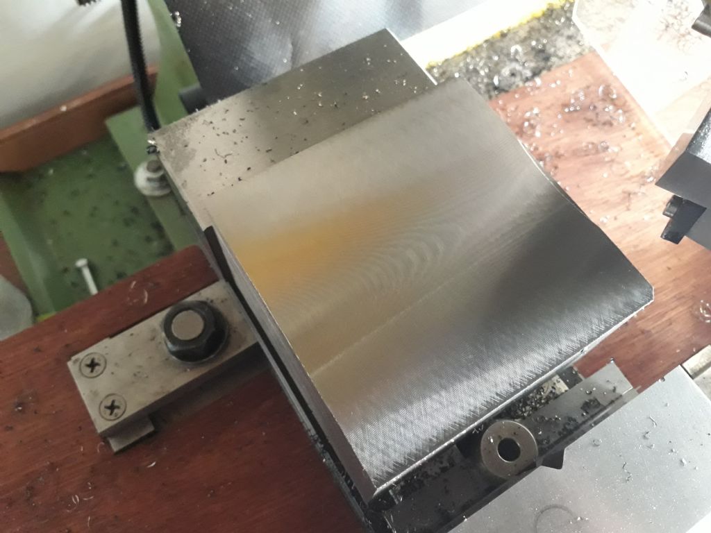

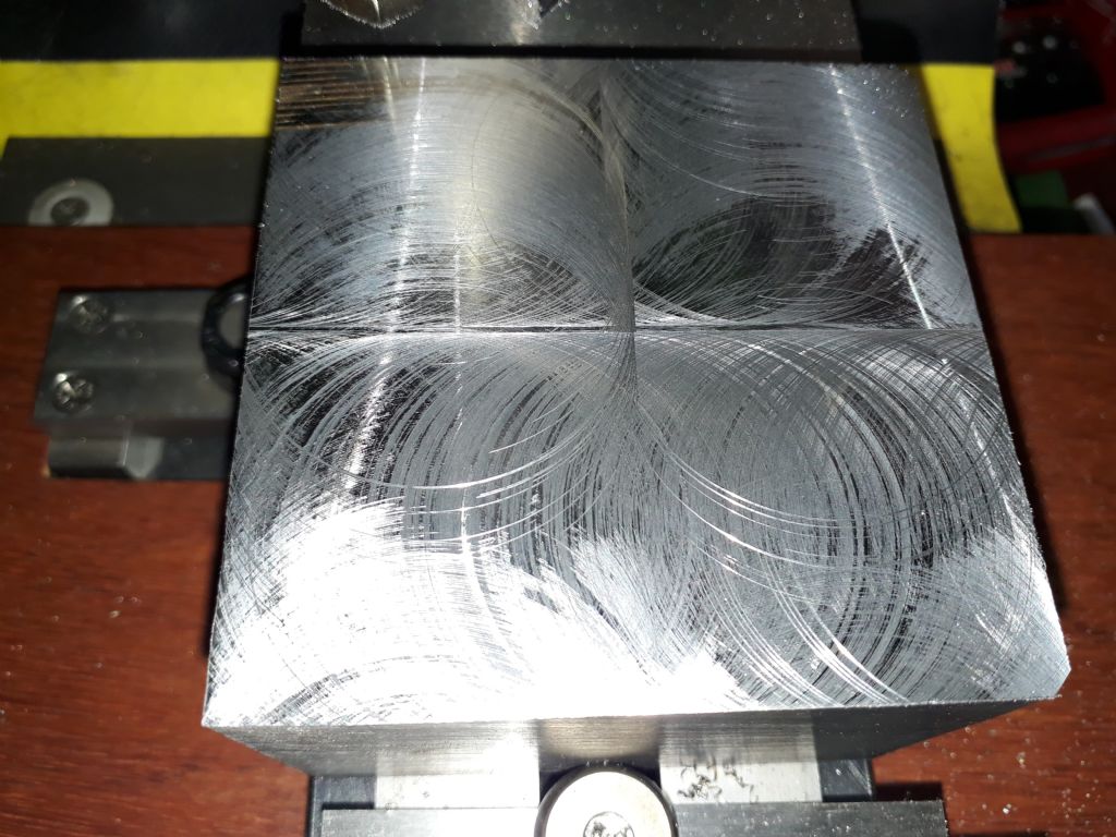

                                            #437414
                                            ChrisB
                                              @chrisb35596
                                              This morning I had another attempt at sorting the mill tram, following the advice on this thread and other videos of similar mills on youtube.
                                              Started off with levelling the bench and table which were out so I had to adjust a bit. Then checked the table and column, both were acceptable, the column has a nod of 0.05mm over a height of 200mm – I shall call that acceptable. Then I proceeded to tramming the head, left to right was easy enough, but front to back was a bit of a work out. As the column alignment was fine I was not going to touch it to fix the front to back tram, so instead I shimmed the head. I had to place a 0.2mm shim under the lower part of the head where the head lock bolt is located. Not an easy task as I had to do it about four times, and each time I had to support and slacken the head enough to slip the shims in.
                                              The adjustment was done with all locks on the column and quill tightened and the quill at the retracted position. I could not find a way to fix the quill misalignment (0.3mm over it's full travel) but I reasoned I will use the column rather than the quill to take milling cuts.
                                              I did some test cuts, first with a 50mm face mill and then with a flycutter. Judging from the machining marks it looks like the tram is fine in all directions ( that's no expert judgement btw!)
                                              This is a 50mm face mill, probably I could do with some more speed. No noticeable ridge at the cut intersections.
                                              Flycutter at approx 6" diameter left a nice smooth and flat surface.
