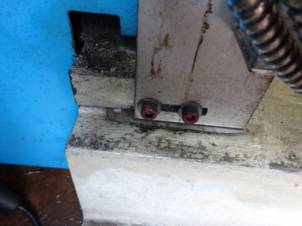

      Hi,
      I'm trying to improve my Sieg SX3 milling machine by tramming it in properly.
      (Ref this link: Sieg SX3 )
      This would be straight forward on something like a Bridgeport, where you can adjust the front-back and left-right tilt angle of the head. However, the Sieg SX3 just has a square column bolted directly onto the base with four M10 bolts.
      There's no way to adjust this except by loosening the bolts, slipping some combination of shims in the gaps and doing the bolts back up again.
      This is a very laborious process as you have to calculate four thicknesses of shim stock (one for each bolt), based on your DTI measurements of the errors between front-back, and left-right of the stage.
      I have tried doing this and I can get down to about 70um (2.75 thou) of TIR across 300mm of the stage.
      This is less than half the error it was delivered with, so it is an improvement at least.
      The choice of shim stock thicknesses I have seen for sale seems too limited to get any more accurate, (e.g. a 3 thou shim is too small, and a 4 thou shim is too big.)
      Is there a better way of tramming a mill like this?
      What is a realistic tramming accuracy to aim for on a machine of this construction?
      After all, if this small milling machine flexes by 'X' amount when cutting metal, then there's little point trying to tram it more accurately than 'X'.
      Regards,
      Nicholas Lee

            Posted by Nicholas Lee on 14/02/2017 23:52:37
            You are over-thinking the job, you can do front to back first, then side-to-side after. It isn't necessary to do it all in one and calculate 4 shims, adding 2 shims for each axis still works and allows you to fine tune each axis. the shims add themselves

              If you want adjustment of less than one thou, you could scrape the base to suit, but it's not a beginner's job.

                Posted by Nicholas Lee on 14/02/2017 23:52:37:doing the bolts back up again.
                Regards,
                Nicholas Lee
                1.5 thou + 1.5 thou is 3 thou but 2 thou + 1.5 thou is 3.5 thou.
                You can add shims and for really fine tuning then use baking foil.

                  Aligning the column a slow process with a lot of trial and error. If you cannot get the exact thickness shim to put under the front (or rear) mounting bolts, you can also try adding different thickness shims under both the front and back so that the differenece between them is the correct dimension (if that makes sence). There is no need to tram the column for sideways alignment. This can be done by rotating the head. The indent pin only gives an approximate angular position of the head. OK for rough work but not for an accurate tram. I used to have an SX3 and have upgraded to an RF-45 type mill which also has a bolted on column which had to be aligned.
                  Paul.
                  #284338
                    As Nick says you are over thinking it, just get some old feeler gauges and poke them in the gap and see what that does to the readings. Another way to get a fine adjustment is to move the position of the shim material as it is basically just one leg of a right angle triangle, the further away you place it the less effect it will have on the column.
                    Did my X3 that way and not had to touch it again, must have been about 9yrs ago now.

                      Have you checked the column to base squareness in both X & Y directions during your column shimming ?
                      This is what you are adjusting with the shims & what you should be checking with this adjustment. Aim for 0.001" per foot against a known accurate square. Ignore the spindle alignment while doing this. When the column is truly perpendicular to the table top (which should be parallel to the base), then check the spindle alignment . If it is out, adjust at the swivelling head joint, not with the column.
                      Pretty pointless having a spindle that trams "true" if the column is not perpendicular to the table IMO – raising the head when the column is out of square will move the datum point on the job. Tramming the spindle should be the last thing you do whan you know everything else is within spec.

                          To be pedantic, you should only need shims in three places, not four

                                      Nigel B has hit on the problem that I faced when doing the same to a Sieg X3 (with fixed head).
                                      There are two things to align: the column being perpendicular to the table in both planes, and the spindle being truly parallel with the column. Mine was out on the column by about 0.001" per 1" of vertical travel (ignore which plane for now to keep the discussion simple), and a similar amount on the spindle in both planes  – 0.0009" and 0.0013" per 1".
                                      The problem I found was that if I shimmed the column, using a pair of dial gauges rotating on the table, then the error in the spindle resulted in the column still being non-perpendicular.
                                      I think that what I needed to do was 1) clamp a dial gauge on the spindle outer and clock the column ground ways in X and Y while raising and lowering the spindle (with a locked head to column). Then correct the head mountings so that the spindle was able to raise and lower with no change in clock readings – this seemed a tricky job. Then, 2) conventionally 'tram' the column to the table by shimming under the column, knowing that the rotating spindle was now parallel to the column.
                                      If anyone disagrees, or can even understand what I am trying to say, I will be pleased to hear. I actually set the spindle true to the table by shimming the column, knowing that this left the column non-perpendicular. I simply stuck a label on the side of the machine telling me of the head lift X and Y error! It was only ever a problem if I was taking a zero point from the top of a job (e.g. gearbox casing), and wanting to bore precisely a hole 4" down inside which meant dropping the head on the column. I am now fortunate enough to have big second mill so I never went back to fix the Sieg properly.

                                            I got an early model SX2 Plus from Arc. They stated that one pad in the base is intentionally made the highest so you can tell which one not to shim.
                                            It was easy to identify the high pad. I used brass shim, with a torque wrench for consistency while finding the best sets of shims. I don't recall whether or not I then tweaked the torque.

                                              When I was trying to work out how to tram both column and head without a particularly good reference square, I found this very helpful: **LINK**
                                              The gist is:
                                              1. Get the spindle parallel to the column in both directions by raising and lowering the head with an indicator on a longish bar in the spindle. The spindle should be rotated 180 degrees at top and bottom, and the centre point used to check parallel, eliminating runout. This should be done for both x and y. Easy for X by tilting the head, hard for Y as the head to column connection needs shimming
                                              2. Once done, tram the mill (sweeping on the table) by shimming the column.
                                              3. Declare success.

                                                Thanks for all the replies. Too many points to reply to individually.
                                                It has highlighted that I am making the beginner's error of just tramming the spindle to the table, rather than both the column to the table, and also the (rotatable) head's spindle to the table.
                                                I keep forgetting that the head can rotate 90-degrees on this mill, as I have never dared to adjust it out of vertical!
                                                It was correctly pointed out that if I only tram the spindle, but the column itself is crooked, then when I raise or lower the head then my calibration is invalidated.
                                                I think I might try Dan's suggested method, as I don't have a big reference square, but I do have a mag-base holder for my DTI.
                                                I'm also going to hunt around more for some thinner shim steel.
                                                Feeler guage sets are cheap on eBay, so I might buy and sacrifice one of those.

                                                    If you don't have a large reference square you may be able to make a large circular square by turning a piece of pipe in the lathe, turn the OD and face one end in one setting and you have a square (providing your lathe turns true!)

                                                      If you have a lathe, as Hopper said above make a cylinder square. A bit of round bar 2 1/2 – 3" diameter by 8 or 9" long – recess the end(s) leaving a ring at the o/d to sit on, then centre drill. Turn between centres to as parallel as you can get & face the ring at the end at the same time and you are good to go.
                                                      To use, sit the cylinder square on end on the table, set a dial gauge pointing in the direction you wish to check from the head & set zero by passing the square past the dial gauge and zero on the high point. (i.e. point the dial gauge along the X axis (table) & "wipe" the square past the gauge tip with the Y axis). Move the head up as far as practicable & pass the square past the dial gauge again, noting the high/low reading which is the error. Working this way rather than running the gauge up the side of the square only shows the error in the direction you are checking, rather than a compound error. Then repeat for the other direction.
                                                      I don't have access to precision granite squares any more, but did find a rusty cylinder square where I work now that had come in with a job lot of stuff from an auction. After de-rusting, a check between centres showed it wasn't parallel, so a couple of hours messing about with the tailstock position & taking light passes had it parallel with about 0.005mm over 350mm, near as I could measure. I know it isn't perfect, but a quick check on a couple on vertical maching centres showed no more than 0.01 mm / 300 mm squareness error. I am not confident enough in the setup to claim that the readings are gospel, but they did suggest that the machine alignments were in the right ballpark,
