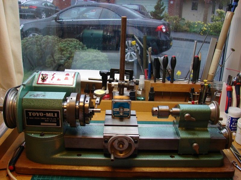

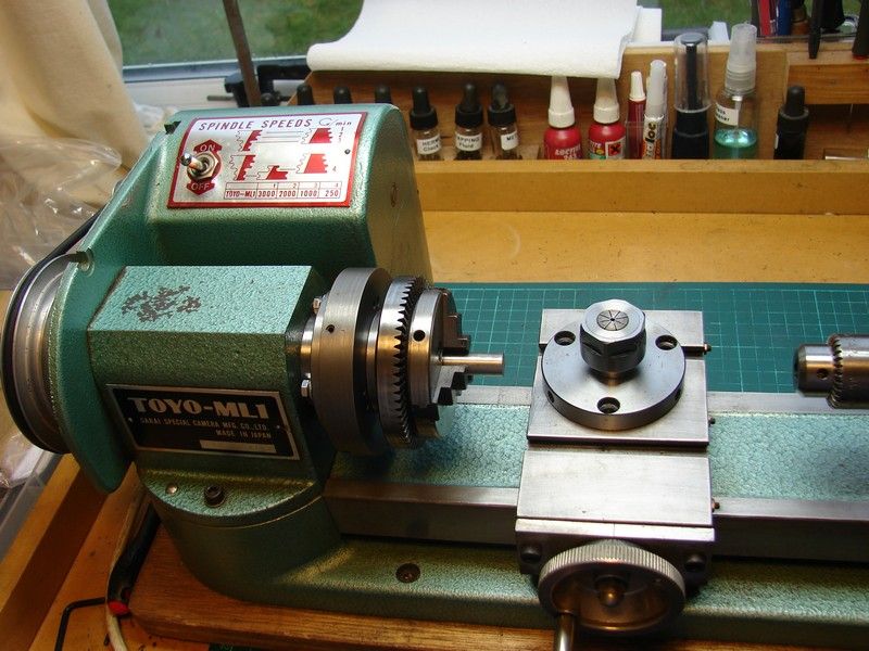

      I have been after one of these for a few years always liked the look of them they are a bit quirky as the spindle taper is morse 1.5 and the tail stock is a short MT1 they were designed in Japan to make cameras and not for general sale.
      But just look at that bed, a huge casting superbly accurate been drilling with 0.5mm solid carbide PCB drill in silver steel to a depth of 7mm no problem modern taper bearings in the spindle with a 12mm through hole.
      The lathe only weighs 15kg (34lb) so easily lifted out of the way when not use so perfect for clockwork in my tiny workshop so I made a MT0 adapter for my Cowells tooling for the tail stock and a adjustable backplate for the three jaw and ER16 collet chuck just need to knock up a fixed steady adapter for my Cowells steady to finish.
      Love my Cowells but that will stay in the garage for proper machining jobs with lots of swarf, the ML1 is to be used inside for re-pivoting and boring barrels and the like.

            A nice key operated 3 jaw chuck too, none of that unimat tommy bar nonsense

                  Well I can tell you my lathe has a standard leadscrew and the more I play with it the more I like it
