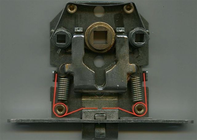

      A small, one turn torsion spring in a door latch/lock I have, has broken. The lock supplier can't provide a replacement spring [but will sell me a replacement latch for £100!]. I cant find a matching, off-the-shelf spring anywhere
      I thought therefore, I would make one but have a few questions. The wire diameter is 0.95mm. The spring has one 7mm [int dim] turn with 20mm arms. I assume I need spring steel but have been offered piano wire. Are they the same? I assume it will be better to heat and form rather than cold form? Will I need to temper/harden the spring before use and if so how? Stainless steel may better as the environment the lock is in is damp.

                    Herewith a photo of the lock. I have added in red [on the opposite side] how I think the spring fits. I am not entirely clear how the latch actually works. You would think that the 2 no. helical springs would suffice but with them in position and working, the latch itself just flops about. You can see the rough broken end of the spring in the photo. It lasted perhaps 2 – 3 years.
                    Thanks for the replies to date which as always are very helpful.

                      The pix were a great help to understand the spring failure. I think this lock has a major design problem. It looks like they need the torsion springs to increase the latching force, because they didn't leave enough room for adequately sized extension springs. The torsion springs would be under extreme stress to work with large tension as shown. A replacement will likely also break after a few years.
                      More importantly though, I don't see a cam or space piece between the latch bar and something solid to prevent the latch bar from being pushed back in, say with a credit card, to jimmy the lock open. It looks like the lock depends only on the torsion and extension springs to counteract pushback forces, rather than a cam, spacer or block placed behind the latch on locking.
                      I would invest in a simple swing type deadbolt (no springs, just a big cam inside) if you are protecting something valuable with this lock. Good deadbolts are simple and can not be pushed back. No springs either, and usually cheaper than a complicated lock like the torsion spring one.

                          Ian, which part 'flops about' when you dont have the 3rd spring in place. From the picture it looks like the two springs should pull the plate (with the 'bolt' attached to it) pretty firmly in the down direction.
                          I would not describe the thing as a lock, its more just a latch that draws back when you turn the handle.
                          There are online sellers of replacement springs for achitectural and door funiture who will certainly have a generic spring if not the exact one assuming the hardware has a makers name on it.
                          At least you have got something you can dismantle and repair, more and more these days the products are deliberately made to be non serviceable (as a by product of the quest for cheaper maunfacture) usually defined by the phrase 'continuous product improvement'

                            Your right , it is a mortice latch – but with a snib lock, operated by turning one or other of the square spindles on either side of the handle spindle. The latch is part of a plate below the top plate – you can just see it in the photograph but the two plates are independant. It is the latch that 'flops about'.
                            I thought it would be easy to find a generic spring but so far all enquiries have drawn a blank. A supplier has offered to make some but at a min charge of £60 for 10. I have found something similar but with 6 turns rather than 1.
                            MG's suggestion is a very good idea – though I think I will try and cold form a few so I have some spares.
                            Reeves sells 20SWG stainless steel spring wire which hopefully will be suitable?

                                        I have added copy of the dimensioned drawing of the spring I sent to various suppliers to the album. It has one turn only.
                                        I dont think it is difficult but I do think the latch is poorly designed – particulary the way the spring [which seems undersized for what it has to do] acts on the latch. I just want to replace it with something that isn't going to fail in 5 min.

                                                      Would you not be better using new on each side of latch bar as per your edited pic, which would unburden the single spring a bit.
