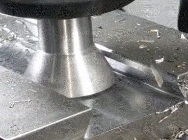

        For those unable to view the ScPatent dovetail video cutting 42CrMo4 steel with a TCMT inserted shop-made tool at 2,900 rpm (est. 64mm dia).
        scpatent dovetail cutter.jpg As Andrew pointed out in his comments, finish in certain steel workpieces can dramatically change when surface cutting speed increases beyond a certain point. Here the sfm is est'd to be 1,900 sfm. Others have pointed out that tool system vibration can smooth out at higher rotational speeds. Unfortunately, HSS tools are usually ruined when guideline maximum surface speeds are exceeded.
        My take-aways
        1) Pursue carbide tooling at higher rotational speeds, since HSS cannot operate at these surface speeds.
        2) Test a single flute inserted end mill (Andrew pointed to real "issues" with fly cutters), and those issues would be worse at these rotational speeds, e.g. bits of the fly cutter and swarf flying about and toward the operator.
        3) No or air only coolant stream (avoid carbide cracking if coolant is intermittent) and a coolant storm at higher speeds would be unacceptable in a home workshop.
        4) Focus on widely available positive rake inserts such as SEHT, TPxx, CCMT/CCMG.
        5) Construct a thick LEXAN safety shield to protect the operator from flying swarf and (tool)bits.
