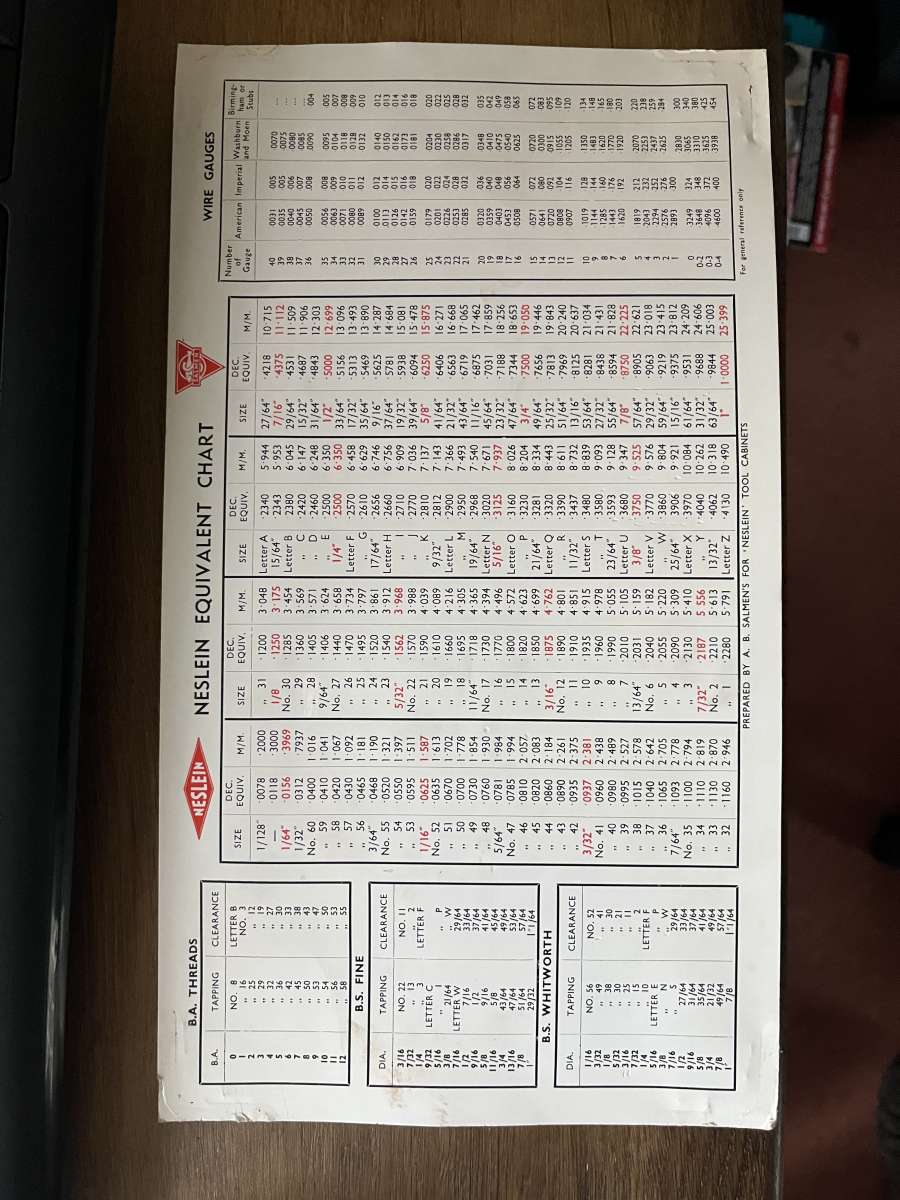

                Shaun Churchill
                  @shaunchurchill54517
                  The corners of the chart tuck into pressed aluminium corner retainers that are discretely stapled to the underside of the tool chest hinged lid. If you dont have a tool chest with the hinged top section you wouldnt have these.

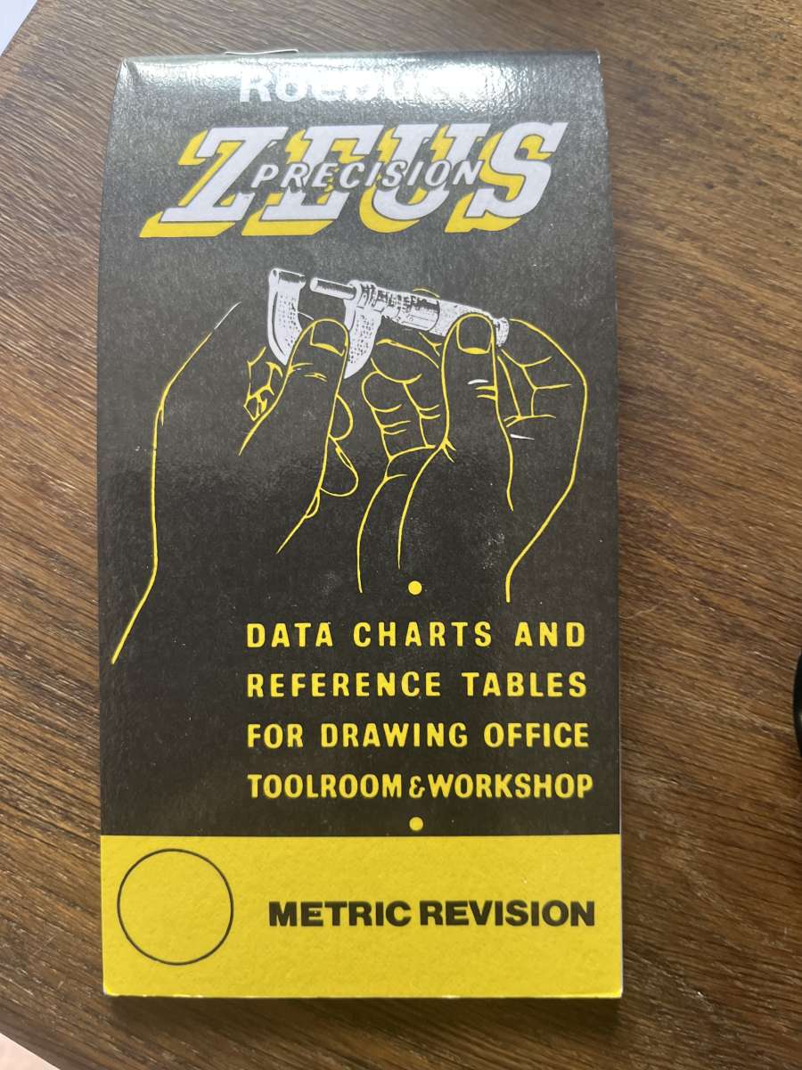

                      Thats why I have numerous Zeus books both in my workshop and at my CAD / CAM computer. Best investment anyone can make is a Zeus book IMHO😀

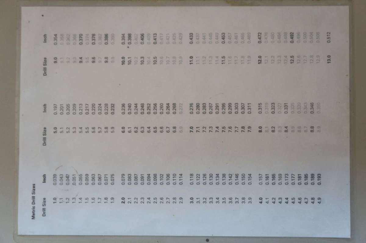

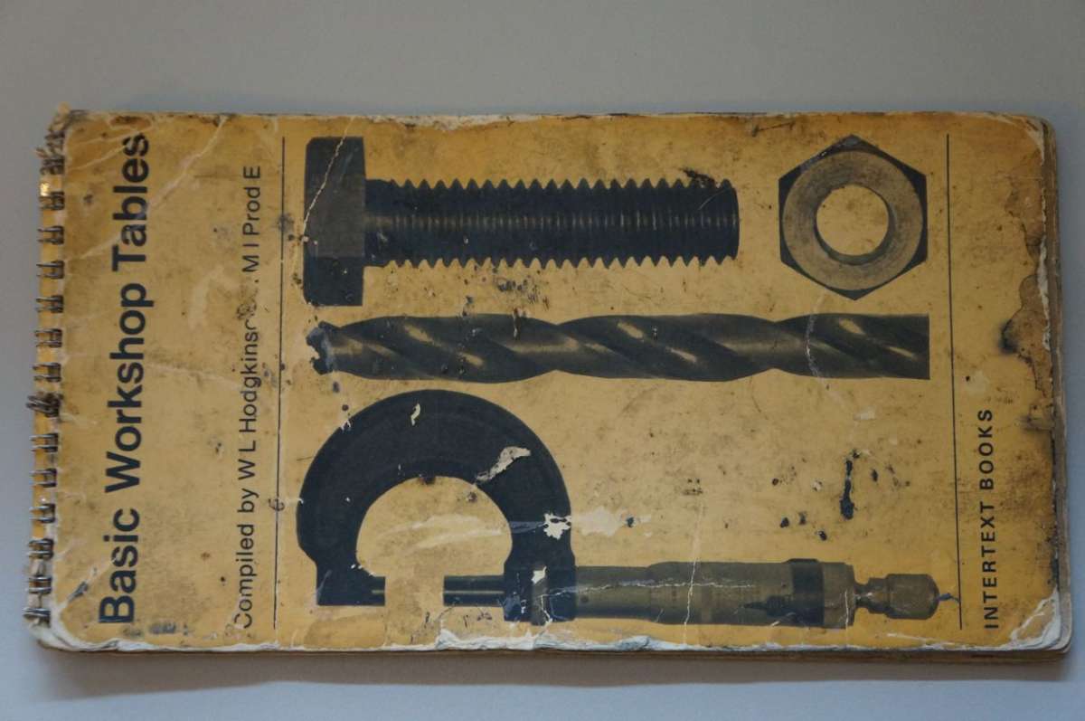

                                                    For the shop I have a disintegrating copy of Basic Workshop Table by Hodgkinson. The print is much more legible than the Zeus. These are long-since out of print, unfortunately.
                                                    DSC02781
                                                    I have been making my own laminated sheets for a while, but have yet to come up with a consistent compact layout that I could bind. This one, which needs updating, shows my available metric drills.

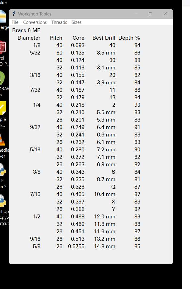

                                                    For design work at the computer I am building up my own little workshop tables applicaton in Python:
                                                    Screenshot 2024-08-15 093828
