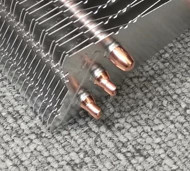

        I'd like to stamp/die cut some copper or aluminium disks using a home made 2 piece punch & die (silver steel?) – does anyone know what the clearance should be to produce a nice burr free edge or have any advice, I'm just making it up as I go along at the minute!
        – back ground info (as there may be a better way!)
        I'd like to make a simple heat exchanger consisting of aluminium or copper disks slid over a copper pipe and soldered to it.
        I would guess the best way would be to turn a two piece tool out of silver steel (Die + punch) with a clearance specific to the material type and thickness and use an arbor press to stamp out of a stack of disks.
        And going to the next stage………… all these disks would ideally have a formed hole in the middle, providing a natural land and spacer to the next fin in the stack, as per the below image (which may be upsidedown…….). This is a beautifully clean cut multiple heatpipe example of the type of cooler I'm trying to build. Mine will obviously be much simpler, just a single copper pipe with round disks on it and a generous gap to allow convection.

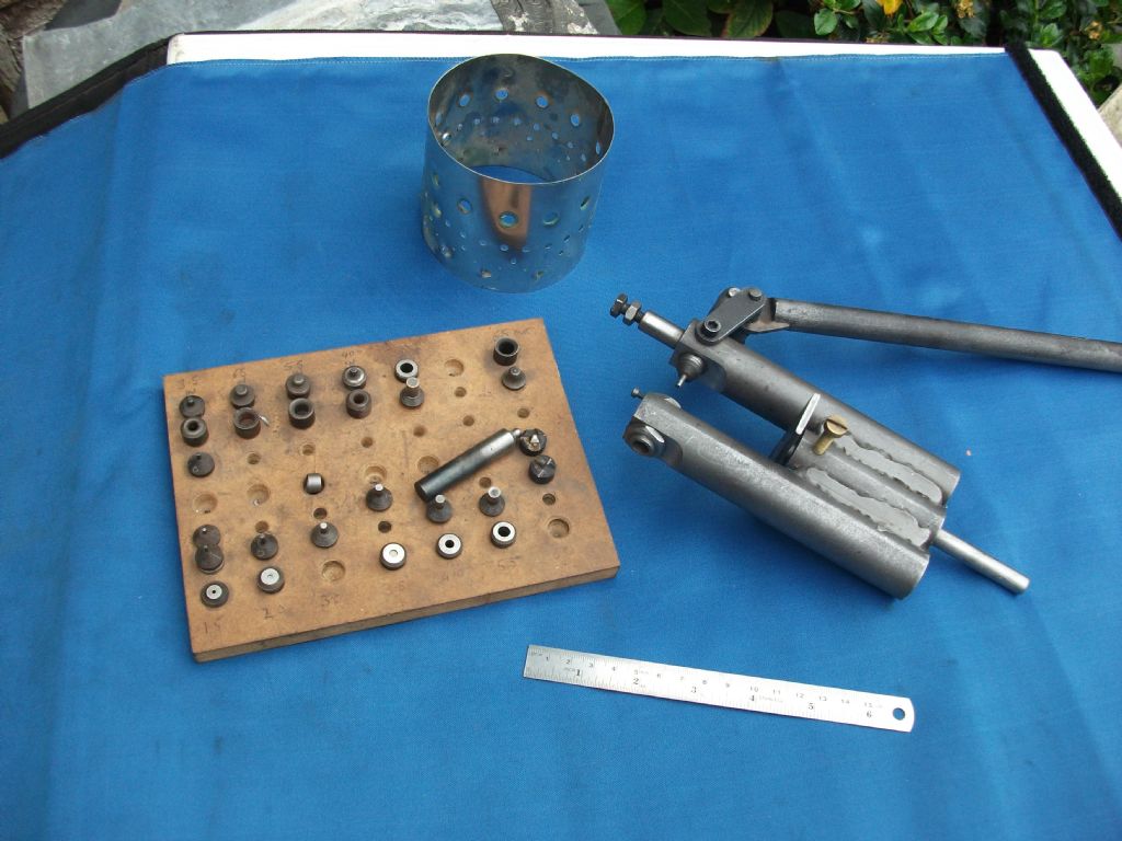

                This piece of tooling i made about 20 years ago originally to punch
                and form the holes in this gas turbine combustion chamber,since then it
                it has been used for all sorts of sheet metal work.The original design
                was from the Gas turbine builders association and was the work
                of Terry Lee.
                The 5.5 mm punch in the tray is exactly 5.5 mm diameter the hole in the die
                is 5.65 mm diameter.
                The punches and dies are silver steel .With a little imagination it would be
                possible to accurately punch the holes and using an additional punch
                and die to form a flange on the inner diameter as in your original photo
                forming a greater contact area and providing automatic spacing of the
                individual fins.
                Drilling these holes is the least likely solution for a successful outcome
                for obvious reasons.
