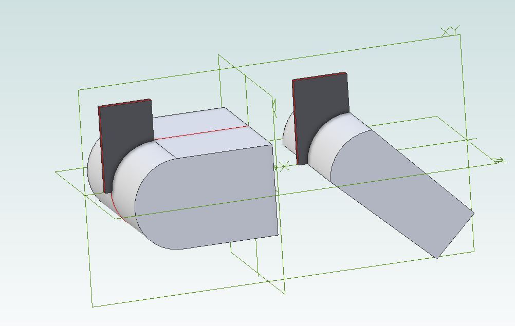

      I need to round an edge of metal plate (45HRc) to precision radius of 15mm.
      Because plate is wide turning is out of question.
      The obvious idea is to use dividing head with tailstock to mount said plate and patiently proceed with inching bit by bit and taking straight cuts with end mill, then smoothing radius so produced with sandpaper etc.
      There is also a simpler method:
      One can buy corner rounding end mills which are essentially "inverted form of ball mill"
      I can envisage 2 ways of using them.
      First would be to use them perpendicular to plate, make a cutting pass, invert plate and make yet another pass (there will be witness mark for sure and other issues with geometry calling for careful machine setup.
      Second way is to set end face of plate under angle of 45 deg to the axis of mill and proceed with a single cut.
      This looks like the best way to proceed but could you comment on it?

          Can you show a diagram (with dimensions) of the part you wish to make? Doesn't have to be anything fancy – quick sketch on the back of an envelope will do.
          It would also be handy to know what the metal is and what the part is for.
          #510104
            As said a picture would help as I can't see how any size plate could have it's edge rounded by turning without hitting other parts. Your mention of coming from both sides suggests 30mm thickness plate but if holding plate at 45deg you will only be able to cover approx 20mm plate and it won't be a flowing roundover.
            Where have you seen that size rounding cutter? it's going to be big with approx a 50mm dia head and maybe 25mm shank and also cost a lot, a 6mm radius carbide one for upto 45HRc costs £96
            Edited By JasonB on 27/11/2020 08:17:54

                    How do you propose to cut a 15mm radius with 6mm or 8mm radius cutters? I am confused as to exactly what you want to do.
                    The usual way of rounding the end of a piece of flat bar as shown in Jason's drawings is to clamp the flat bar to a rotary table in the mill, with any size end mill cutter you like, say 12mm diameter, and use the rotary table to rotate the job so the side of milling cutter cuts the radius on the job. The radius is determined by the distance from the centre pivot point of the rotary table to the edge of milling cutter.
                    You could do it in the lathe by mounting a small face plate to your dividing head and clamping the flat bar to the face plate. And hold any old decent sized milling cutter in the three jaw chuck. (If the chuck is not bellmouthed it will hold a milling cutter without slipping just fine, in my experience over some years now.

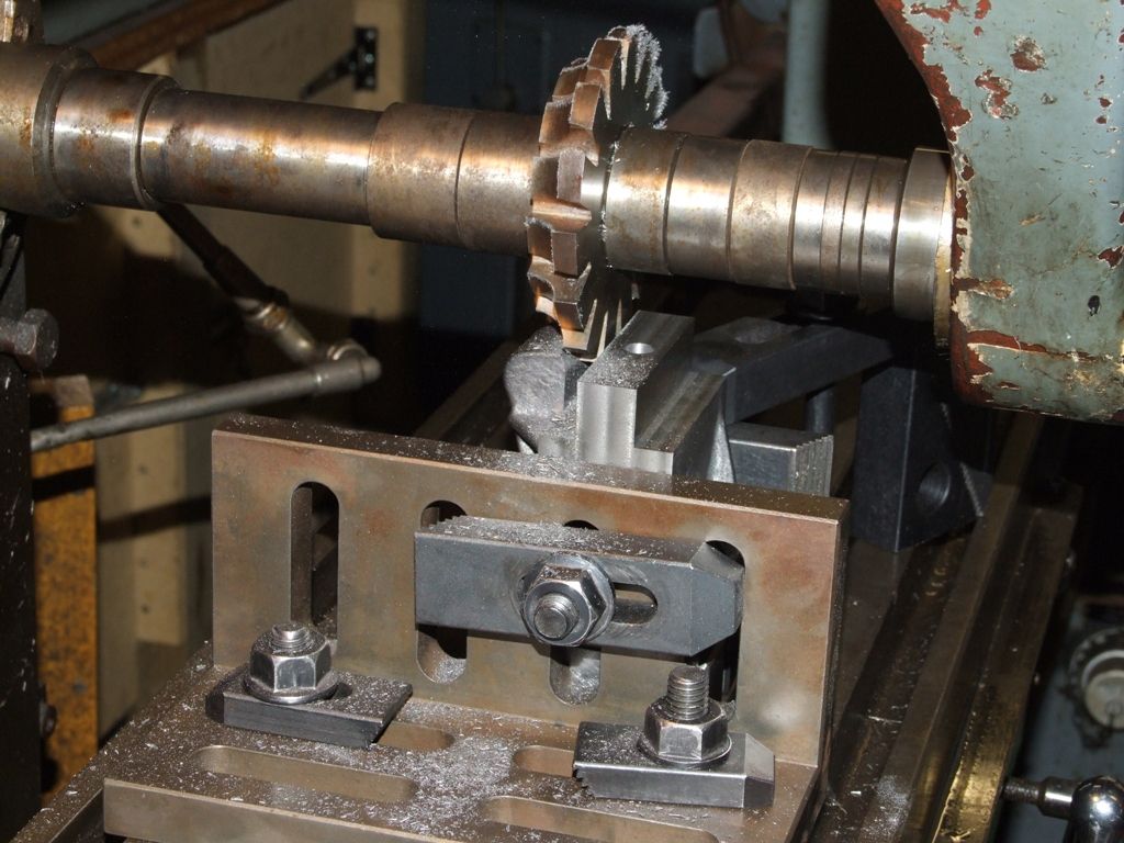

                      Sounds like a Ø30mm concave horizontal milling cutter would do the job (the right hand example Jason gave is what is wanted I think).
                      This would be expensive so I would be thinking of making my own with some gauge plate mounted in a fly cutter holder. A Ø30 hole is easy to create, angled cutter to give relief behind the edge, relatively easy heat treatment, sharpening would be a bit harder to get right.

                        The method of rotating the work in a vice and using an endmill to produce a series of flats has never worked for me.

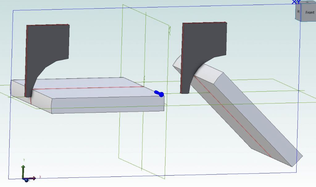

                          So it sound like the one on the left right of my earlier sketch which if your plate is only 6mm thick won't present a large amount of cutter engagement. If you can mount your plate at 45deg then I would do it that way to avoid having to set up twice and risk things not lining up. You may even get lucky with a router cutter which would allow the work to stay flat though 16mm / 5/8" radius will be more common
                          yes now I know what you are after it could be done on a lathe if opposite edges less than 30mm apart.
                          Edited By JasonB on 27/11/2020 13:10:03
                          Edited By JasonB on 27/11/2020 15:33:16

                            Posted by JasonB on 27/11/2020 13:03:56:
                            The challenge with the 45 degree method (RHS of sketch) is positioning the cutter correctly so the mid-depth of the plate passes through the radius centre. Easy to do on a picture, some thinking needed for real metal objects.
                            The LHS will only work if the cutter radius is half the plate thickness. Otherwise the curve produced will always be imbalanced on the plate.
                            Edited By DC31k on 27/11/2020 14:26:43
                            #510226
                              LHS has the work flipped over so you cut half way from each side, just risk of getting a step.
