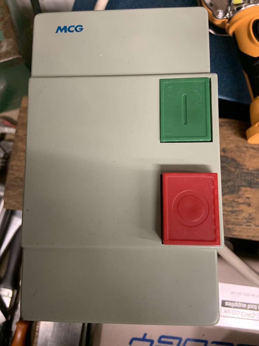

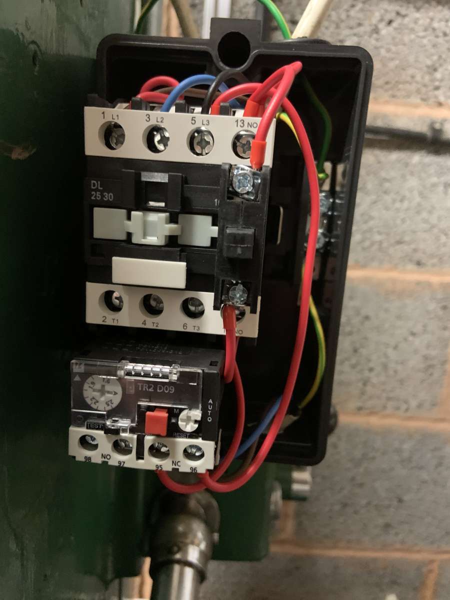

      Hello again! I’m relatively new to this after getting a Tom Senior M1 milling machine this year. About a month ago it stopped running and thought it was the starter switch. Had an electrician out who said the Transwave converter was faulty. I bought a new static converter and had a new starter switch fitted. It ran for 10 mins then burnt the starter switch out. I swapped the converter for a rotary one as was told they’re more reliable. Had another starter switch fitted. It ran for about an hour and burnt the starter switch again! It’s got a 1hp motor (1.6amp) and the rotary converter is 2.2. The thermal overload in the starter has been changed to 1.6-2.5 amps. Any ideas what’s going on here please? The electrician has said we could fit a rotary isolator to see if this helps. I’m cautious with electrics because it’s not something I know much about and obviously want a machine that runs but safely too! Thanks Paul

          Sounds like your electrician is playing poke and hope with your money.
          The motor will pull what it needs, in this case possibly more than it should.
          Please post photos of the starter and the internal wiring.

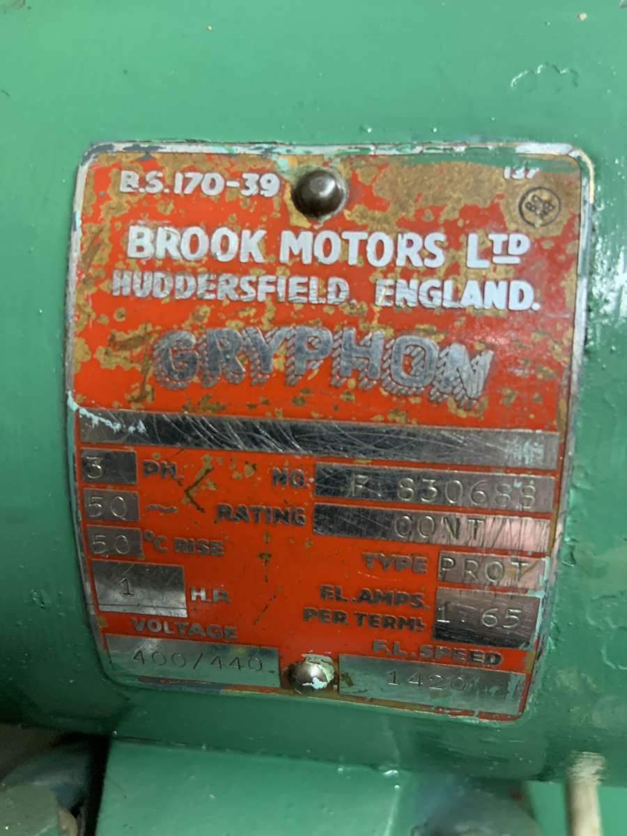

            By starter switch I’m assuming you mean a no volt release contactor type, is it the switch contacts that are burning out or the operating coil or overload? The more information you can give will make it easier for someone on here to help diagnose the fault remotely. As an initial check if you can get hold of a multimeter is as Chris says above continuity of the windings, that they are correctly connected in star for 415V , the contactor coil is the correct voltage rating, and all other connections in the whole machine are sound. When the motor runs does it run quietly and at an apparrenly normal speed? just thinking it could be two phasing. Sorry if this seems to have more questions than answers but it might help reach a diagnosis. Like Chris I’ve run machines on static converters for years with no problems, and yours should run perfectly on a rotary one. Perhaps if you have one in your area you could remove the motor and take it to a rewinders for checking out, good luck. Is your electrician conversant with motors and controls? agree with Dave above it does sound a bit poke and hope.

              I don’t like the news that starters are burning out.   What make and model were they?  Their purpose is to protect the motor against high current during the start-up phase, and I would expect the thermal cut-outs to operate without drama if the problem were simple.

                            DID it work on the transwave when you bought it ? DID YOUR ELECTRICIAN UNDERSTAND 3pHASE ? Is the motor wired star or Delta eg 240v or 415v Get an electrician to check the resistance of the 3 coils and put a insulation (megger ) tester on the motor. If that is sound and there is no excessive load be it bearings gone or the machine working to hard then The motor should be good. The whole point of the overload cuttout is to drop out at the right setting – in this case 1.65A Not 2.5A. wiring 240v ac to transwave, then the starter then the motor. IF it has laid about unused and got damp moisture could have taken out the windings ?. Will come back to this later ! Noel.

                              1.65 A is full load current, cut out must be higher surely or the motor wouldn’t develop full power.

                                  Paul Radford
                                    @paulradford79614
                                    Thank you for all your responses! The issues since the new converter was fitted was due to the wrong size starter switch being fitted as a 240v starter was used instead of a 415v! Fingers crossed all is well now! Thanks again! Paul
