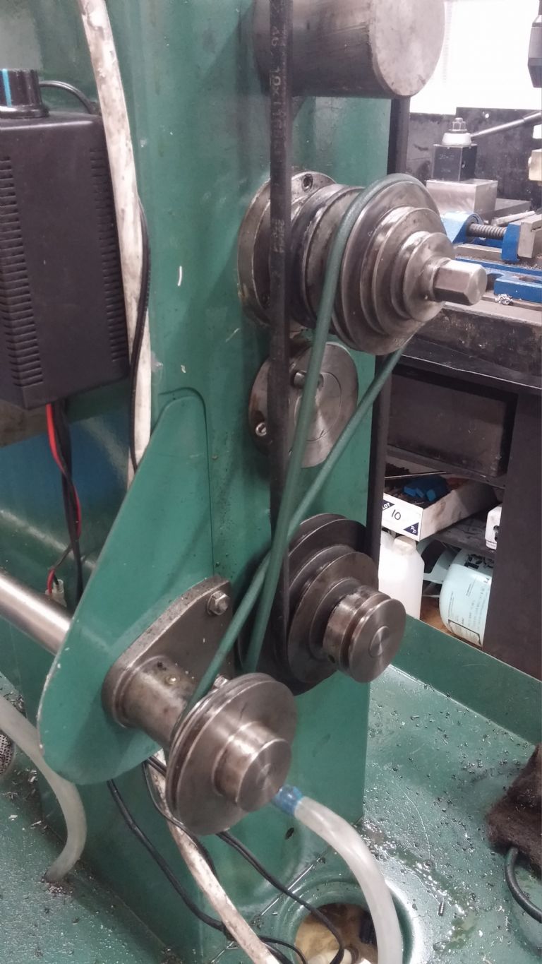

              I have a Junior mill, but I think the principal is the same.
              I've never understood why the table goes from left to right. That's the wrong direction when horizontal milling. The cutter turns anti clockwise when viewed from the front in horizontal mode, therefore the table should go against that, i.e right to left.
              This is my solution. Simple when you think about it.
              The stop mechanism works as expected in either direction.
              Graham

                Forgot to say, on the M1 you have the gearbox and single pulleys, whereas I adjust table speed manually. The belt does rub on itself at the crossover, but polycord seems to hold up really well. There is no sign of ANY wear due to rubbing.
                Ive just had a thought there that it could be my motor that is in the wrong direction. Perhaps it should rotate clockwise and not anti clockwise when viewed from the front.
                Doesn't change the fact that whichever way the motor turns, for conventional milling, you want the table running in the opposite direction to the cutter.
                Graham

                          The M1 has a separate idler wheel used for tensioning the belt for the table feed. It might make for an interesting crossover arrangement.
                          Its different to the Junior picture I posted which doesn't have any mechanism to tension the belt, hence the stretchy polycord.
