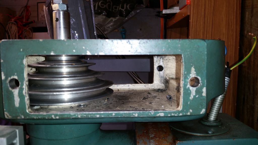

      As the DRO installation has now finished I am looking at the drive pulley on the quill spindle. It has about 5mm of vertical movement resulting in the belt not aligning properly. I have an exploded drawing of the assembly but it does not show in enough detail how its all held together. There is one grub screw on the pulley, with this removed I would have expected the pulley to just slide off the spindle. It just seems to abruptly stop on what you would think is a shoulder on the spindle, except the spindle has no shoulder!
      So I wonder if any members here have the same mill? Should this pulley 'float', and has anyone taken one of these apart?

          I think the E type mill uses the same S type head as on the light vertical mill . I've just had a look at mine & the there is approx 1mm of vertical travel on the pulley. Have you checked there's not a second grub screw under the one you have slackened ? May be when you try to remove the pulley it is catching on a burr made by the grub screw..
          You could ask the same question on the "Tom Senior light vertical milling machine " post as Damian has his apart at the moment.

            I agree with Ian and was going to say check for two grub screws – been there! Nick.
