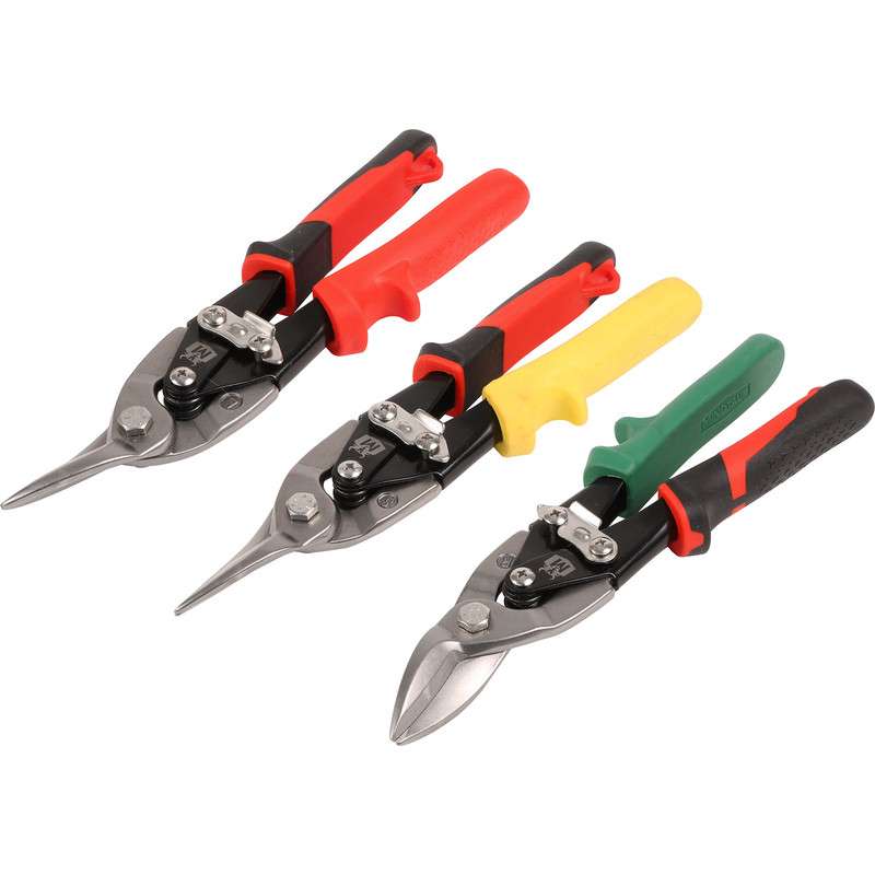

      I was wondering what would be better an old fashioned Gilbow snip or a cheap aviation set – see details below.
      I had read the Gilbow has reputation but not so easy to use and the aviation set is more useful. So a bit confused.
      I’d be mainly cutting mild steel sheets say up 1.5mm.
      What would be your recommendations to add to my toolbox.
      Irwin Gilbow General Purpose Snips 250mm TG24510 £8.45 toolstation
      1ttin snips Aviation Snips Set £11
      2t

        I have various high quality Gilbow type, small large, straight and curved, plus a cheap nasty aviation set of three.
        The Gilbows do a better job than the cheap compound ones, but the aviation snips can access stuff that the Gilbow ones can’t, particularly as you get right and left hand  offsets for curves etc.
        I also have one second hand set of offset aviation style branded as ProSnip (US made), which are the ones I normally pick up first.

              You will notice the serrated blade sides on the cheapy set, it gives a rough edge.
              You need 14″ Gilbows for 1.5mm steel and then it’s two hands.

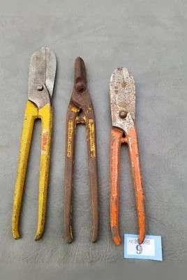

                I regularly cut steel that is slightly thicker than 1.5 mm, but I think that the 10″ ones might struggle. I cut it with ease with 18″ thick blade Footprint ones. I did a quick tin snips search to see if I could find an image of similar ones, but it brought up mainly aviation snips with the odd small gilbow or jewelers style ones. Tried again specifying Footprint and found this:
                snips
                Mine are like the ones in the middle with really thick jaws, but not that clear from the angle and the rust. Not sure if you can still buy this size still. It can help with thicker steel to put one handle in a vice and manipulate the other making it more like a shear.

                          Yes Nick its the one one the left. Typical man to add 3″. They can sometimes be had secondhand.

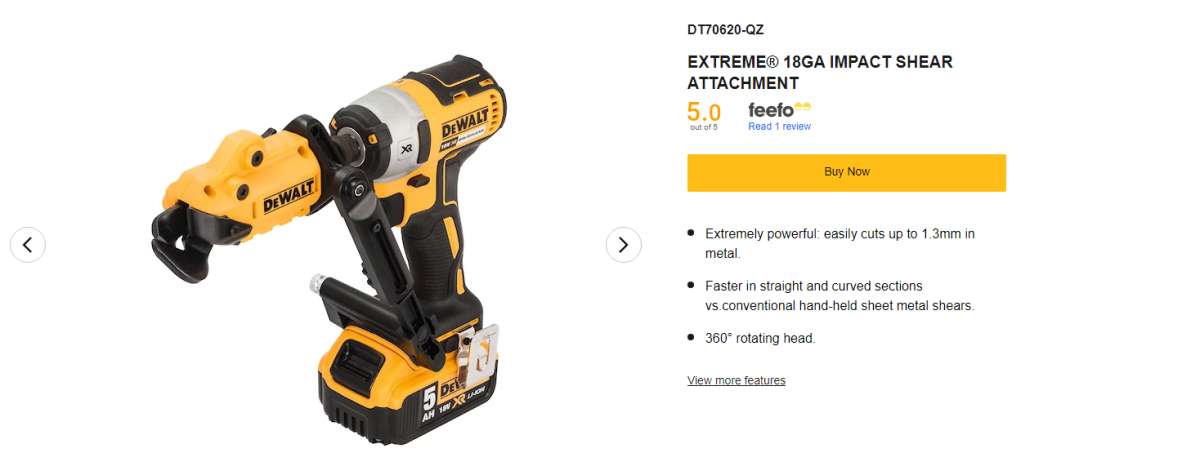

                                  As a slight aside, I’ve just spotted this DeWalt shear attachment  via one of those Facebook mini review videos
                                  Designed to fit to most battery drill/drivers
                                  image_2024-01-02_123312486
