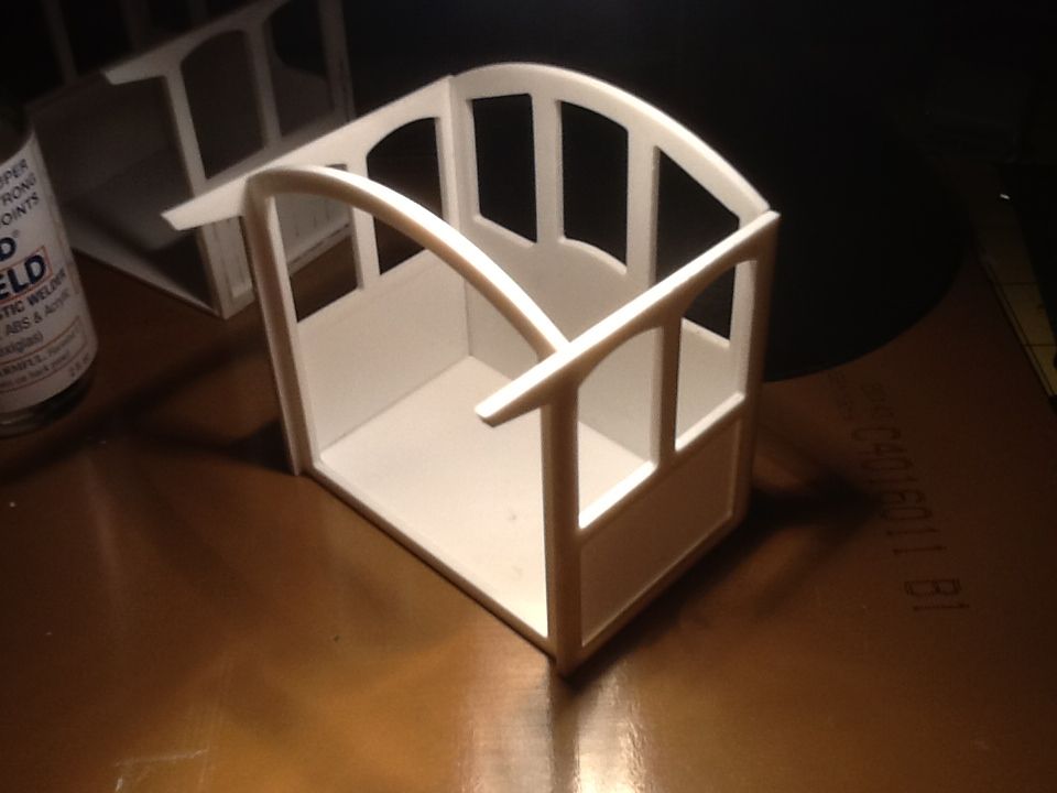

      Have had a request to create a model / diorama of the rollercoaster "Thunder Mountain" at Euro Disney.>>

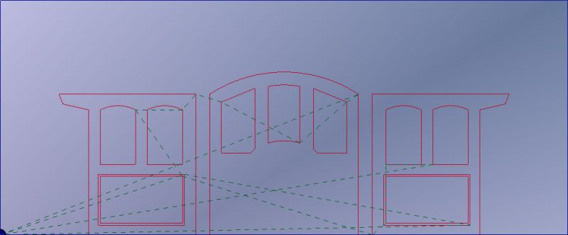

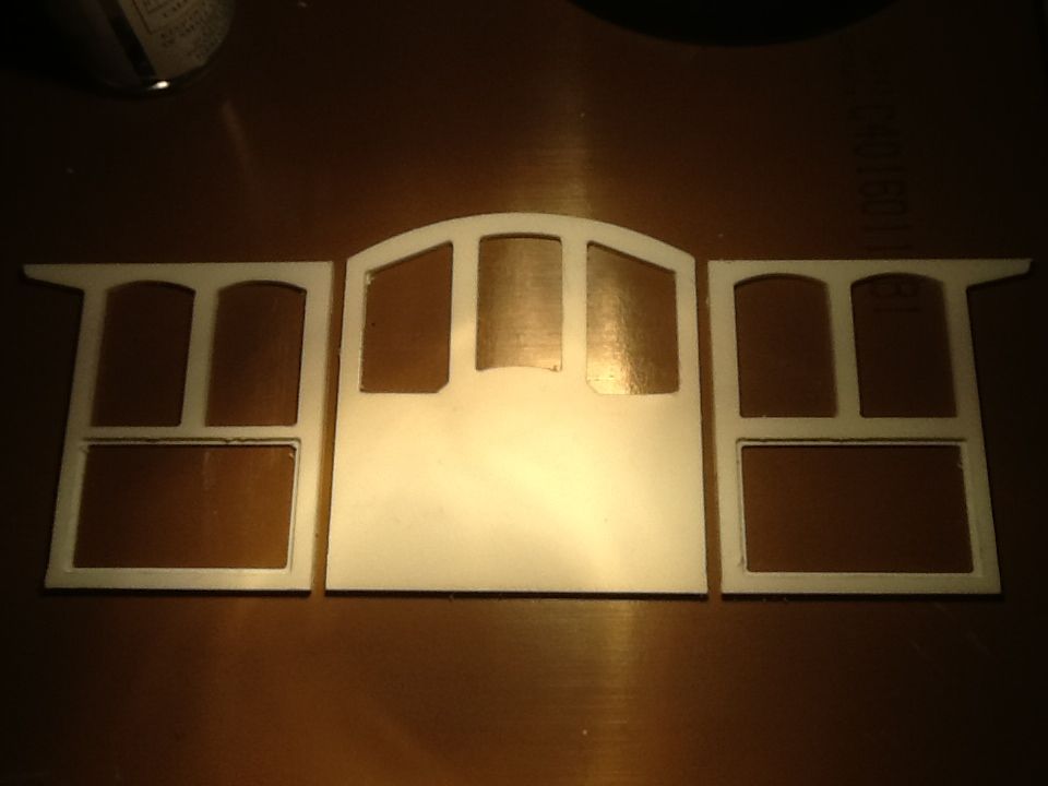

      This is the first time I have used my CNC machine for a work project and thanks to a few of the guys on here I am finally getting to grips with G-Code. This meant an amazing trip to Paris to get some good reference images after a few attempts I am happy with the cab. Here are a few pics of the first stages of the build.>>
      This is a static model and will be constructed mainly from Plasticard, any tips & crits welcome.xxx>>

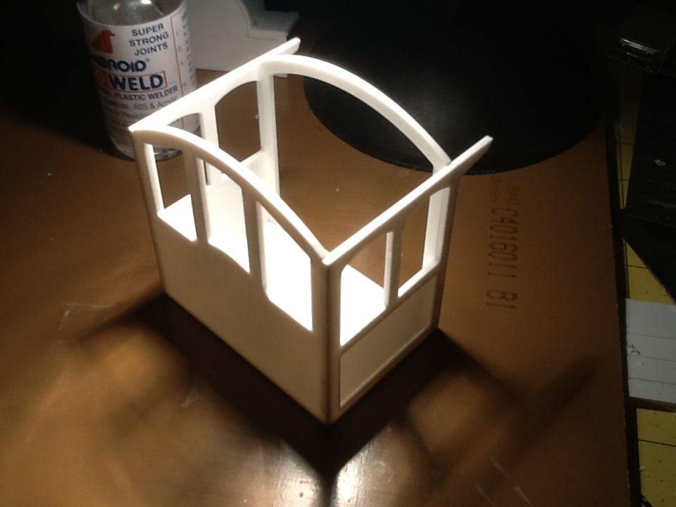

          Its looking good.
          What do you use to fix the bits together?
          #99617
          Jasmine
            @jasmine
            I use Ambroid Proweld it's a plastic solvent which uses capillary action. Not the cheapest but is the best.
            Simply hold / clamp / tape your pieces together run the supplied brush along the joint and hold for 10 seconds. No mess no fuss just a beautiful strong joint.
