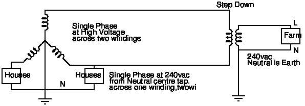

          Something like this:
          twowires
          Advantages of 3-phase include reducing the number of wires needed whilst helping to balance the load.   Domestic customers are typically supplied single-phase from a delta/wye transformer, with the delta connected to 3-wire 3-phase, no earth or neutral.   The wye side, has neutral centre-point, which is also earthed.   Typically homes are wired single-phase in balanced groups to one of the three phases, plus an actual neutral wire running back to the transformer, and maybe an actual earth wire as well.  The neutral actively balances the system.
          Out in the sticks, it’s common to find farms and small groups of houses some distance from the transformer.  Feeding them standard domestic single-phase 240V in the same way as local homes wastes wire whilst voltage drop causes poor regulation.  An alternative is to connect distant customers with only two wires across two phases, resulting in a single-phase high voltage with better regulation that needs less copper.  However, at the remote end another single-phase transformer is needed to step-down to domestic single-phase volts. One side of this transformer is earthed, and this also provides neutral.   Not the same load-balancing neutral provided by the wye transformer, but it works well enough for the consumer!  Not unusual for a hamlet to grow big enough for this system to become unsatisfactory, in which case proper 3 phase and with a delta/wye substation will replace it.
          As there are other distribution schemes, I hope the experts won’t shoot me for not explaining their favourite!  (Looks like Noel’s village has one, where the ‘step down’ transformer is centre-tapped to provide two domestic single-phase outputs.)
